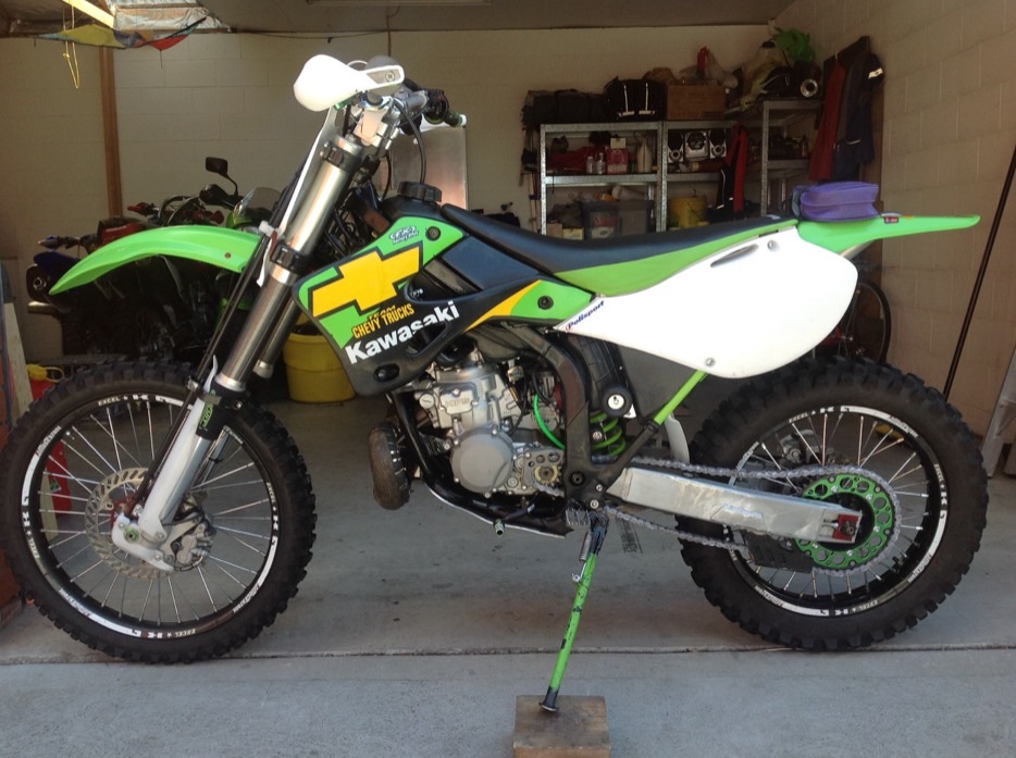

Nice enough bling with out being over the top.
CLO
Posts: 20
Joined: Thu Jan 07, 2016 3:29 am
Post by CLO »
Yep, I agree - it looks good!
