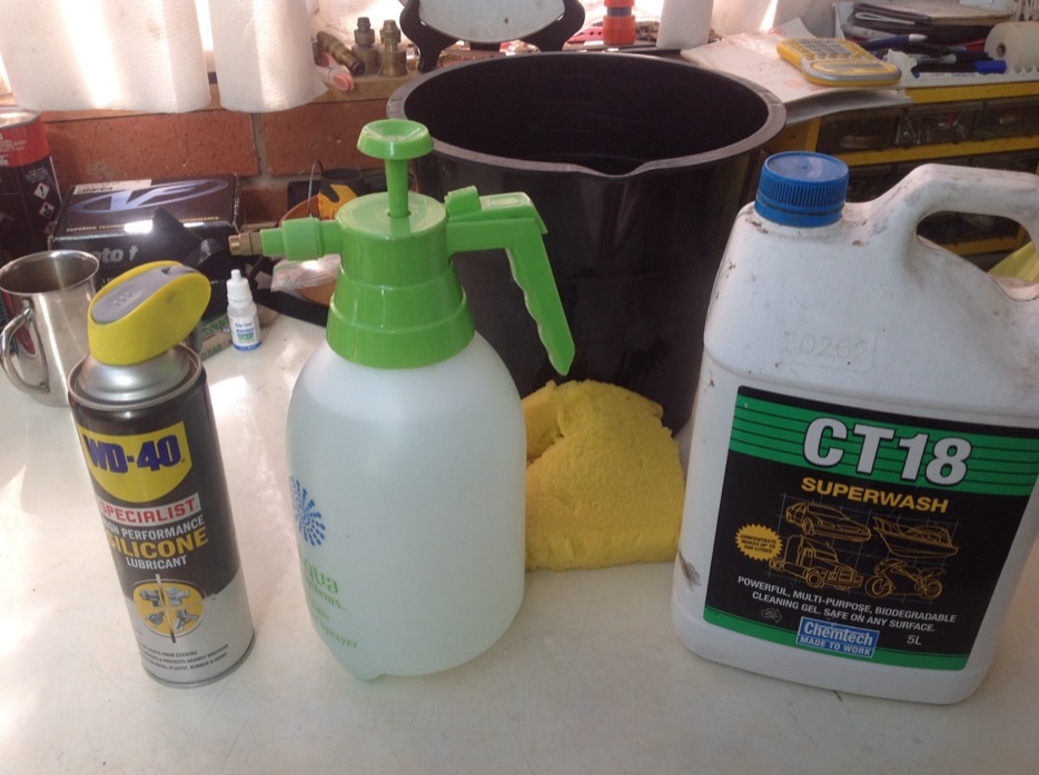

So this is my routine
1, every new bike or part gets smothered in silicon spray. Every thing but the brakes and tyre surface. It will turn your brakes to ice and your tyers to riding on water.
The cruiser nearly spat me of learning that. First time after a silicon spray and just down the road I committed to a fun corner you have to accelerate to get out off and the brake leaver just pulled in and stopped but did nothing. At a critical point in negotiating the corner and with out having washed off some speed the rear tyre went out. Couple of sliding laps to clean itself and luckily court. I knew what was coming and rode it out.
It puts a poar filling silicon layer on your surfaces. Nothing is getting in if you can keep it there.
My favouret one is the Yamaha one but this is good.

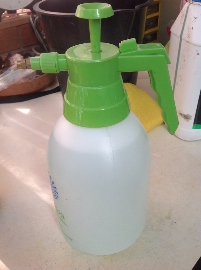

2, fill with water and add about a cap full of ct18
I believe this is the same as truck wash? It works like it should. By leaving a film that washes off and makes a new one.
Spray once with silicon (maybe a freshen up once a year)
Then for the rest of the time:
When I get back from a ride first thing is put the bike where I'm going to wash it. Plug the exhaust and pump up the sprayer and spray every thing. Drench it, about 2/3 of a bottle. Then leave it there for at least 10 minutes while you put the gear away.
Put a cap full in the bucket with water.
Hose the bike over to wash the dirt off.
I like to do this to the engine bays of the cars once a year. A mechanic told me never wash a hot motor or when it cools it will suck water into the electrics.
Give it a complementary sponge over and hose off.
Dirt does not seem to settle. If you rub some dirt in a light sponge over will fix that.
Start from the top by slapping a full sponge on and the suds running down do most of the cleaning. Just keep slapping it on and give it a quick once over and hoses off.

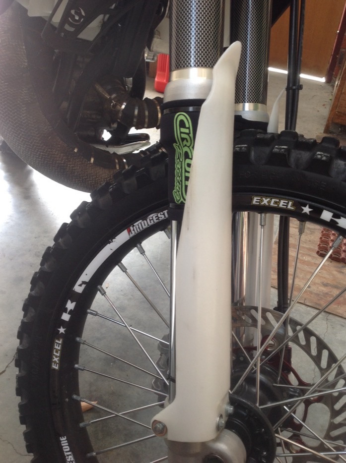

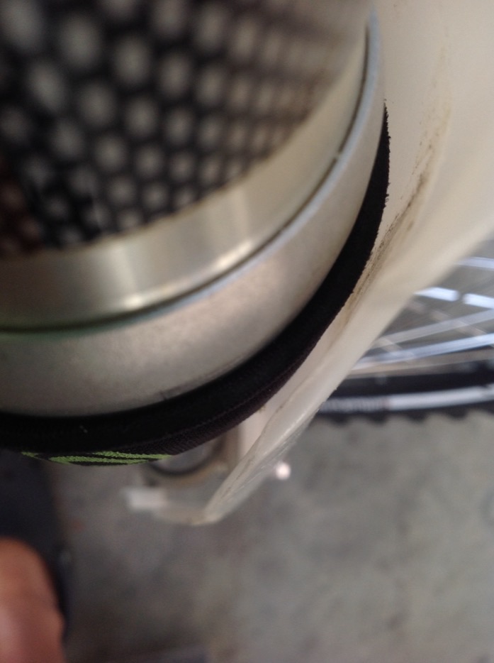

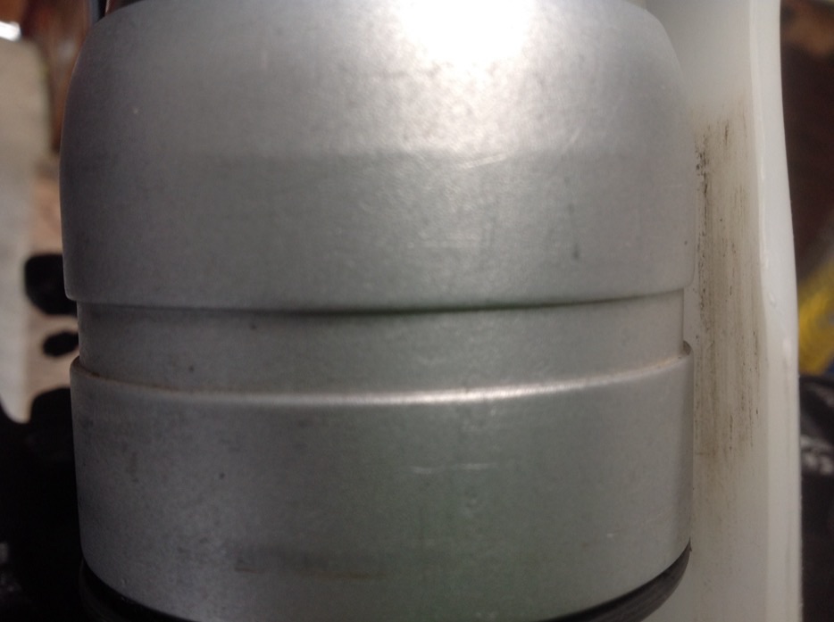

I wanted to try some fork seal savers as they seem like a all round good idea.
Problem is for a KX125 I have to remove these guides. Exactly what they are there for I'm not to sure. Yes they will help keep the fork guards where they are supposed to be but is it really necessary

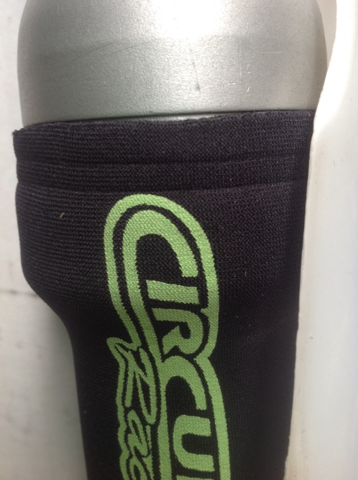

For the right side I just took the guide off and put the saver on and took it for a ride. I used the grove to locate the cable tie. After one ride I can see its frayed up the material a little
The saver comes with cable ties that I located with the guide grove.
This time I plan to relocate it so the top of the saver sits just up to the top of the guide grove and cable tie it there.
