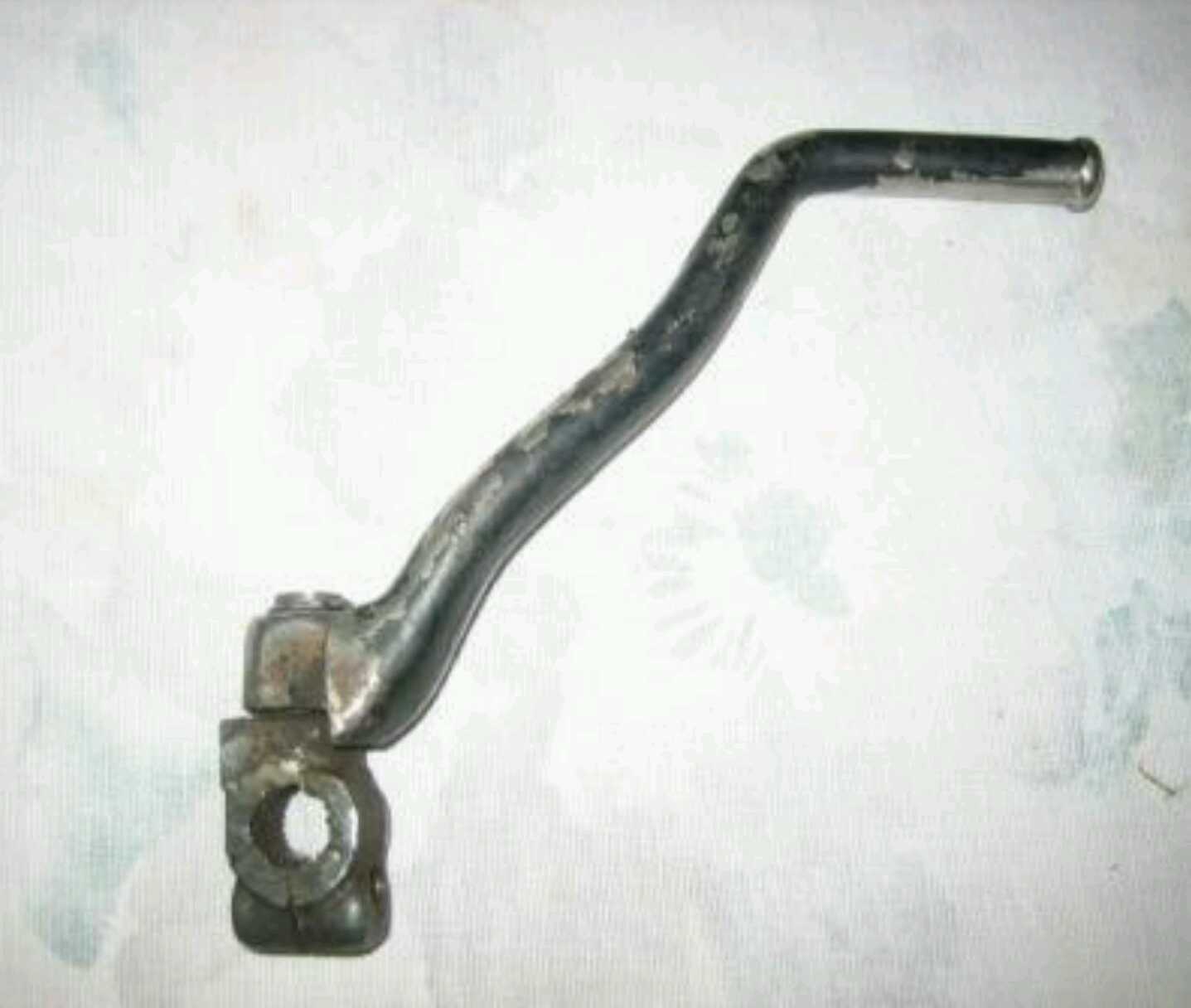

Greg, I have been looking for some parts for other bikes and parts for some friends. Anyway, I remember looking at your "plate" of kickstarters with the broken Italjet kickstarter and I came across this that you maybe interested in! I recall this being on my all green Italjet, and I replaced it with a new one.

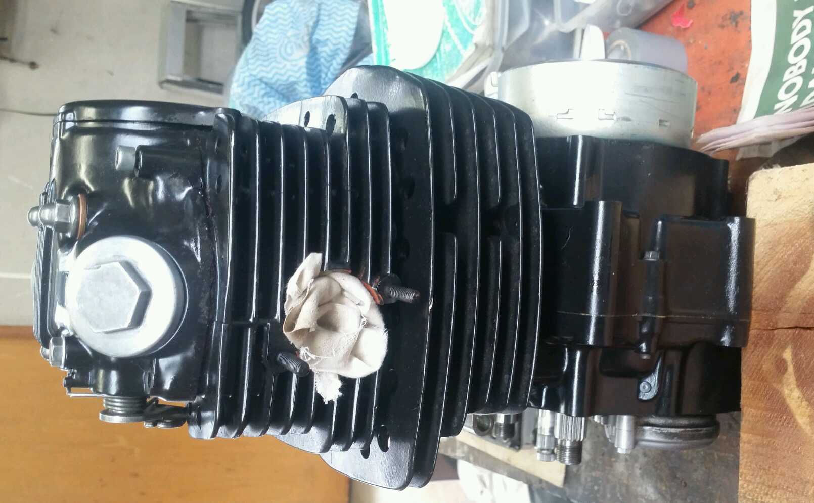

Here is where I am up to with the PIUMA as you are probably wondering why the piston is out! After breaking the kickstarter, I decided to fit a decompressor........
Before,
After.
Can't wait to hear the farting noise Greg, although you have tucked it away fairly neatly there so it might not be that noisy for onlookers. Mark Casswell will be impressed that you also have a working decompressor.

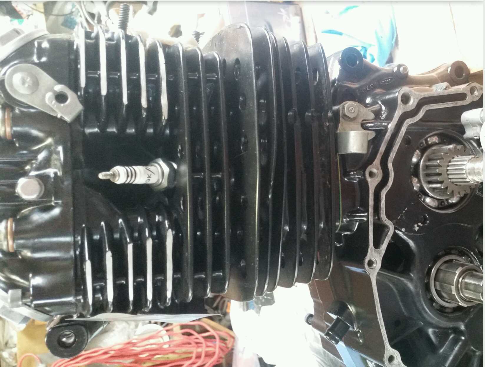

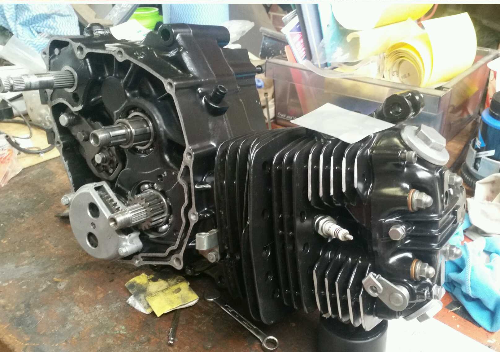

eagle wrote:I've been rebuilding my TLR motor, & have had a high temp coating in black by HPC put on my cases, barrel, valve cover etc & i'm loving the look

Brian emailed photos and asked me to post up on his behalf, I am happy to help anyone with resizing photos or posting for them! Just send me a PM or call 0428 789854!

Thanks for that Greg! i think i'll have to take some pictures of the frame & the new mudguards & petrol tank i'm going to install & a few other things
