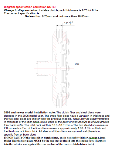

You can now check the plate height.
This can be checked by measuring from the top of the diaphragm fingers to the deck height (see attached drawing), or by removing the clutch (centre bolt) and actuallly measuring the height of the 5 individual plates stacked together.
Don't hesitiate to call if you need some help.

- Gas Gas Clutch technical bulletin.
- Screen Shot 2015-07-09 at 8.16.06 am.png (63.25 KiB) Viewed 34840 times
