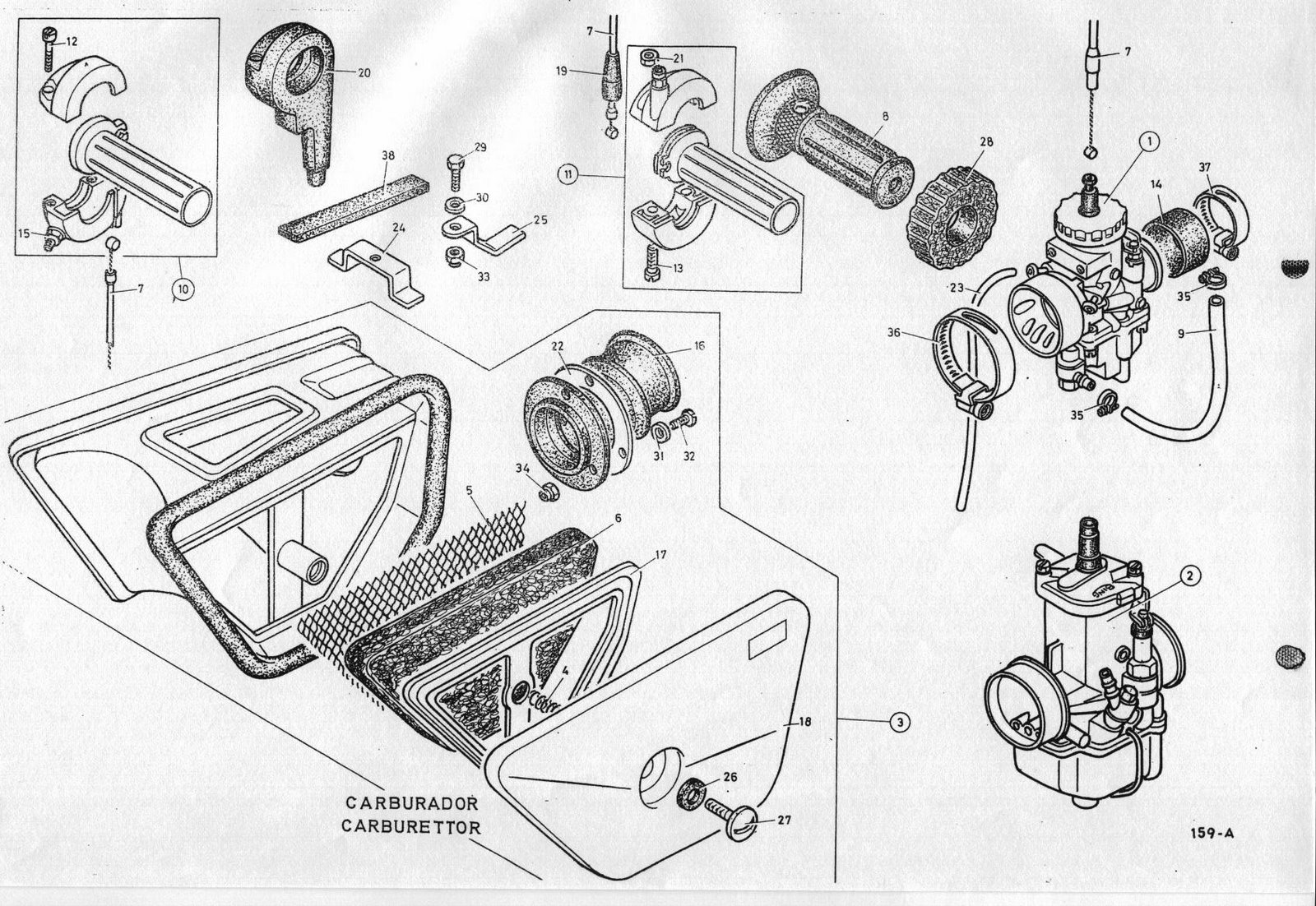

Hi Gurus
I have had my Bultaco Sherpa 250 M158 in bits for a long time now.
I am at the stage where I have to put the air box back in the frame. But there are no bolt holes or brackets.
This bike is a bit of a mongrel and has many "custom" parts.
so could anybody post an image or two or give me an idea of how one actually attaches this BASTARD of an Airbox.
Regards
Ian

Parts 24 and 25 fit into the mouth of the airbox and clamp it to the the frame

Hi
Wow thanks for that. What a big help.
I am going to have to do some fabricating.
Cheers.
Ian
