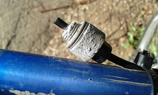

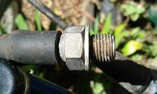

Re: 2004 ? fantic mono, twin disk trials bike
They both are M12 1.0 I think.

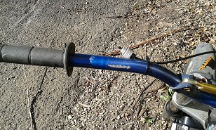

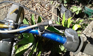

clutch and brake pics.
thanks
thanks
- clutch cable - Copy.jpg (46.97 KiB) Viewed 9475 times
- clutch thread - Copy.jpg (30.23 KiB) Viewed 9475 times
- brake cable - Copy.jpg (45.35 KiB) Viewed 9475 times
- front brake thread - Copy.jpg (27.2 KiB) Viewed 9475 times

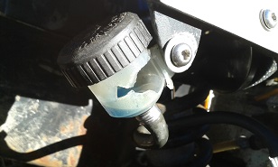

1 step forward, 2 back at the moment.
Broke this, rear brake.
A common thing ????
A common thing ????
- rear brake - Copy.jpg (23.01 KiB) Viewed 9837 times

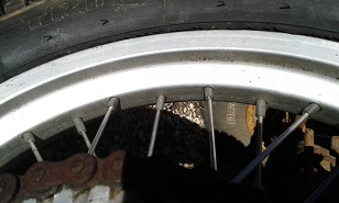

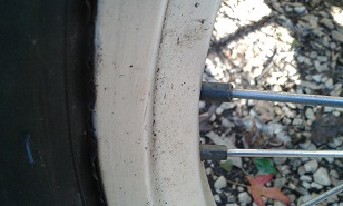

Stepped rear wheel.
standard tubeless rim tape ????
Thanks
Thanks
- rear rim 1 - Copy.jpg (23.87 KiB) Viewed 9837 times
- Rear rim - Copy.jpg (25.9 KiB) Viewed 9837 times
The rear brake reservoir looks similar to a lot of pre 2010 rear brake setups.
Your rear rim looks like a Morad. It should have id marks stamped on the side. Fitting a rim
tape shouldn't be a biggie
Your biggest problem is finding the missing brake and clutch calipers. You could try this mob in the uk...
https://www.trialsbikebreakersuk.com/
Or Richard Allen
http://www.allensusedtrialsspares.co.uk/
From memory the same AJP calipers / master cylinders were same as used on many bikes around 94/95 - eg Gas Gas JT25, Shercos etc. Morad rim used on many bikes of that era - just need the sealing band or run a tube.
