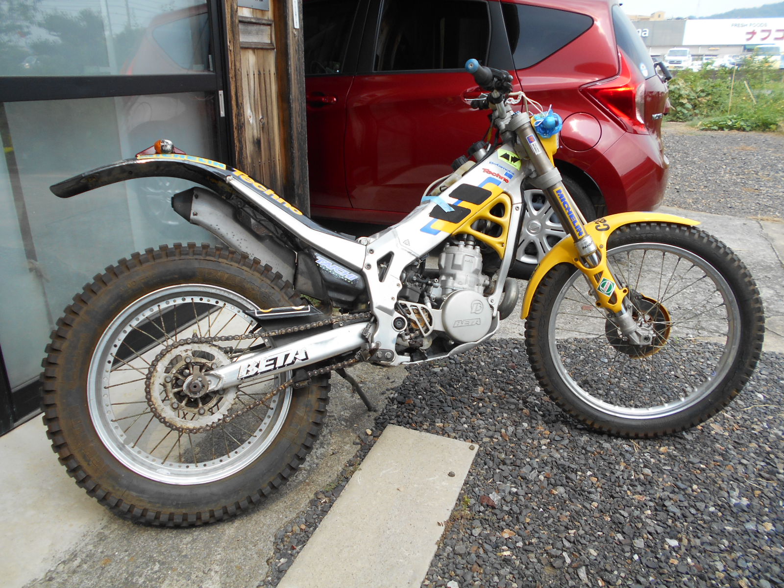

I have been thinking to get Honda TLR200 for long time,
but I got Beta Techno at last and received her yesterday.
I have to check some part before riding as she is second hand trials.
She is my first trials bike and could be too powerful for me.
Thanks
New from Japan

My Beta Techno is 1994.
Condition; Hydraulic clutch does not work
AJP master cylinder kit will be needed.
Or a complete master cylinder will be needed.
I am thinking I should upgrade master cylinder to REV3/EVO.
Master cylinder kit is not compatible. Parts inside differ.
The master cylinder for Techno is a little bigger than master cylinder for REV3/EVO.
Thanks

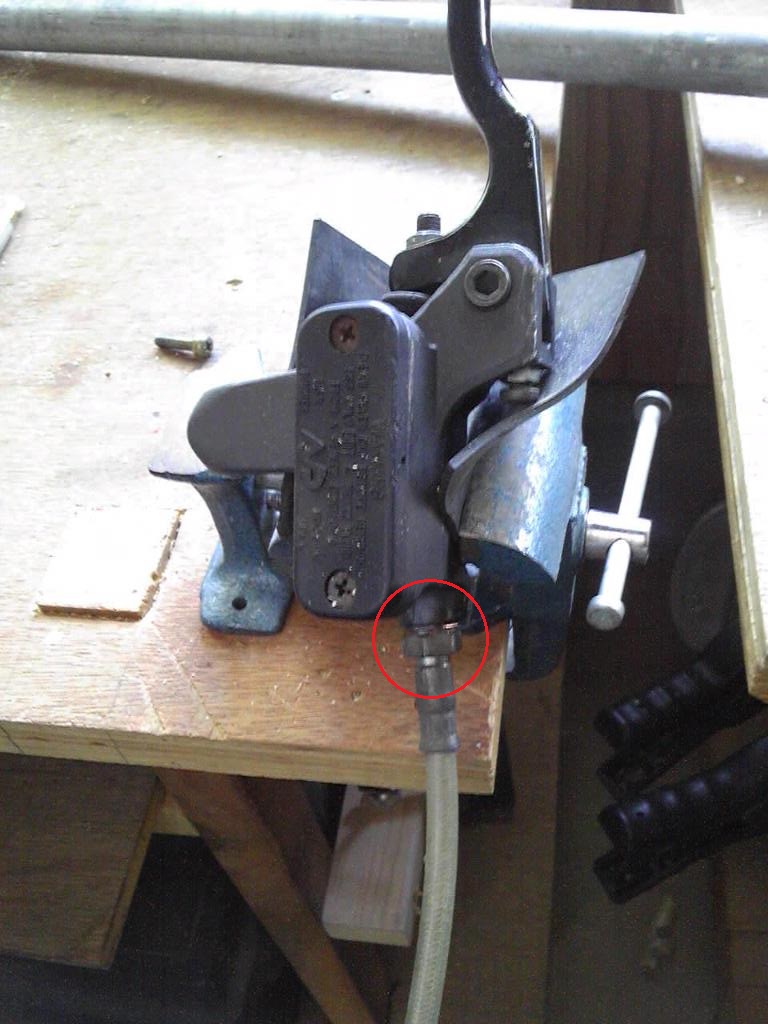

AJP clutch
I removed clutch hose from engine but could not remove it from master cylinder which stuck as shown attached.
I splayed lube onto stuck part and am waiting for a while till tomorrow.
- 160809_151010.jpg (165.13 KiB) Viewed 57098 times

AJP clutch
That hose end was too tight to loosen this morning.
I wonder if hose end thread is clockwise or counterclockwise.
Or pre-owner glued with locktight? If so,I have to melt adhesive with heat gun.
Now I have removed hose from master cylinder afternoon.
Next step,I will get a hose for AJP clutch master cylinder.
Several hours later,I placed an order with HEL in UK.
