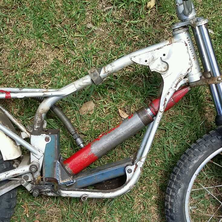

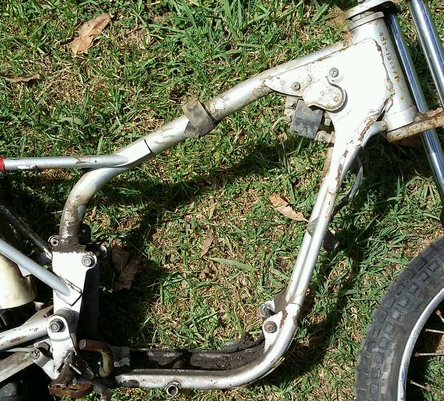

As for my TY Challenge, I have spent a little time on it lately, removed the motor and worked out how to straighten the frame which must have had a fairly big collision with something Solid! Interesting how the frame has bent and forks are Straight!
The motor came out easily so the motor has held the frame in shape and limited the damage to just behind the gussets.
Framework to hold engine mounts and something for the Porta Power to push against to reverse the damage.
This is back to the standard dimensions and luckily all went well as there is no twist and motor bolted back in easily for now.

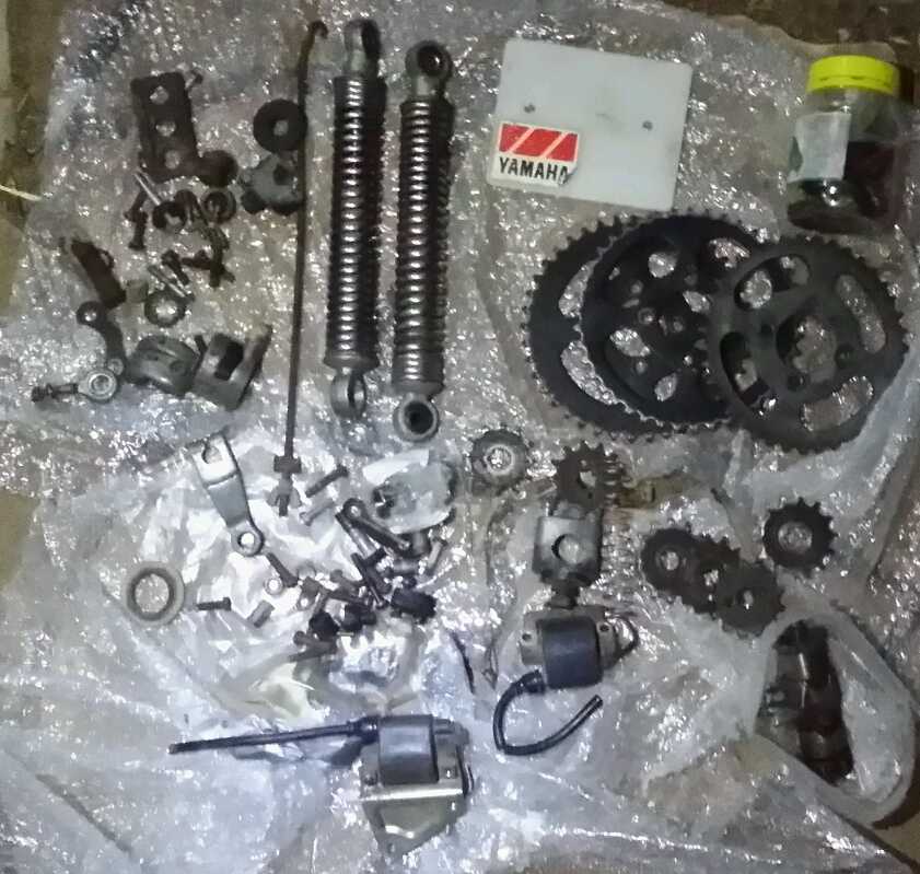

In breaking news, I have scored another TY 80A motor (451 0XXXXXX)! Well actually I have had it for over a week and pulled it apart for it's first time ever and I didn't break anything! The crank feels good and the standard piston has minimal wear so it will be new bearings and seals, basically everything into the matching number cases and it will be a little closer to getting it going.
Still chasing the missing parts (see photos) if anyone can Help?
