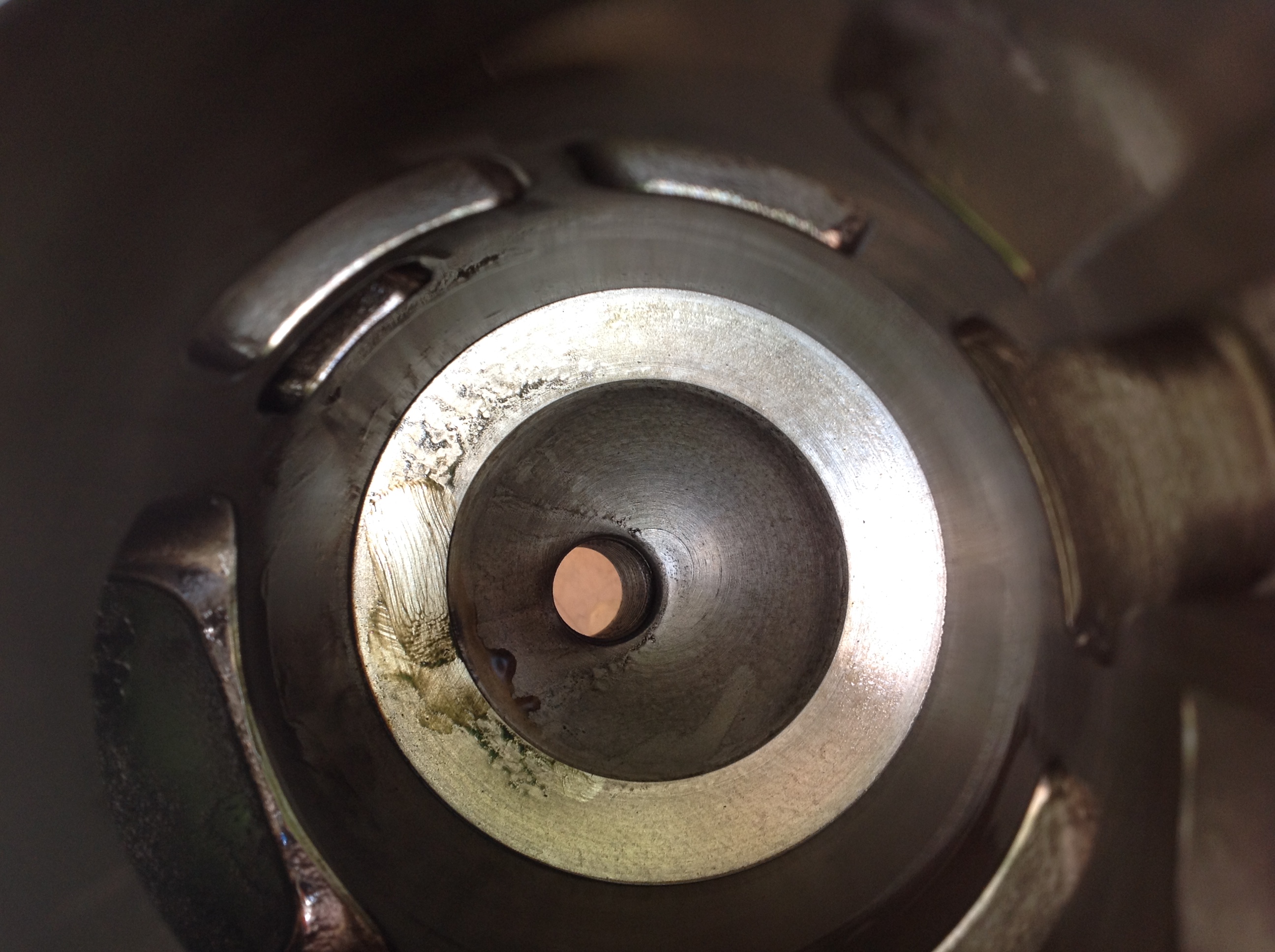

Just how I left it so the power valve seals are holding
Looks like some type of corrosion so might put something on then when I put it together
Oil laying around
There is that dark section on the gasket. Looks like it may be leeking. Could be why it idles high and then settles

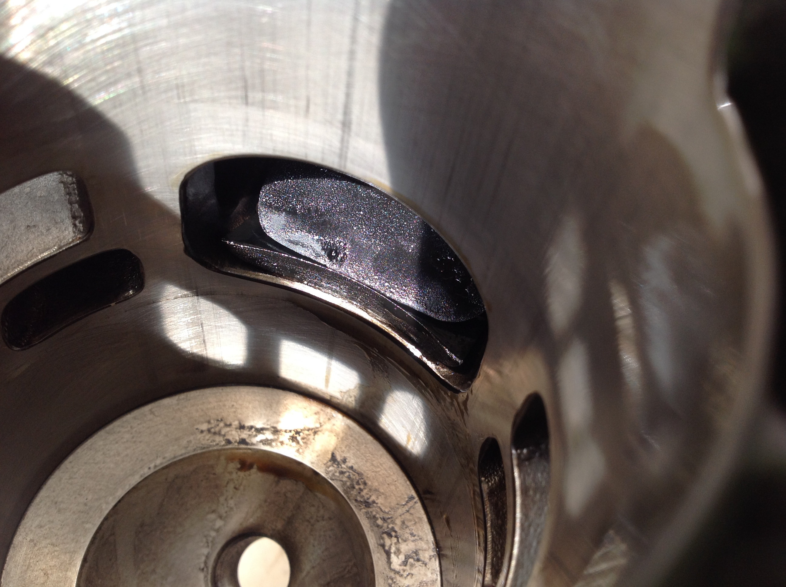

Power valve closed, bit of carbon on the tongue
Powervalve open and it looks uncarboned enough for me. I use a caster blend oil at 50 to 1 so was expecting a little more carbon because of the caster component. Nothing to worry about hear, don't think I will take it apart as there doesn't seem the need.

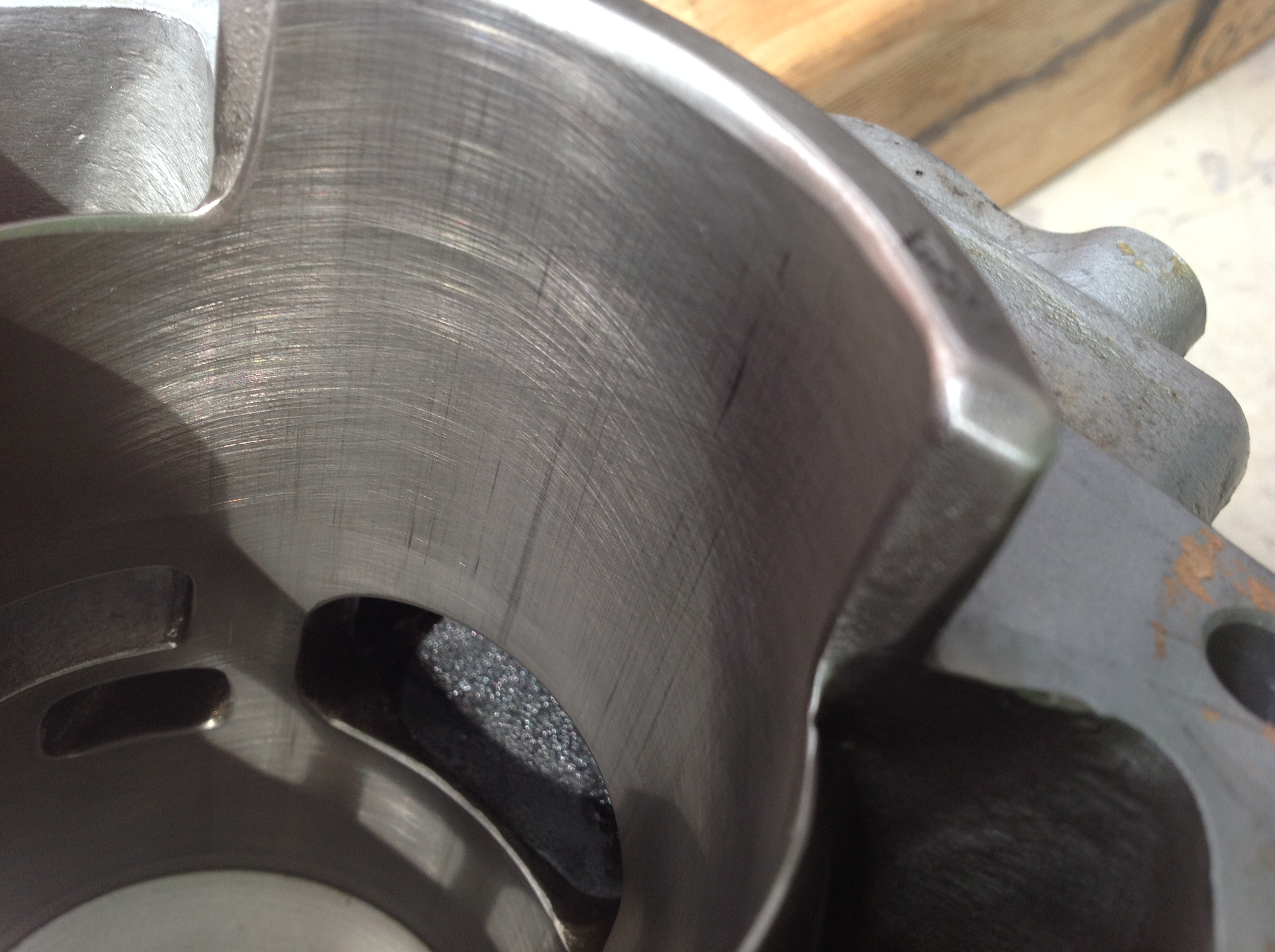

There are some grit scratches on the boar but no real ware.
Nothing to unusual hear

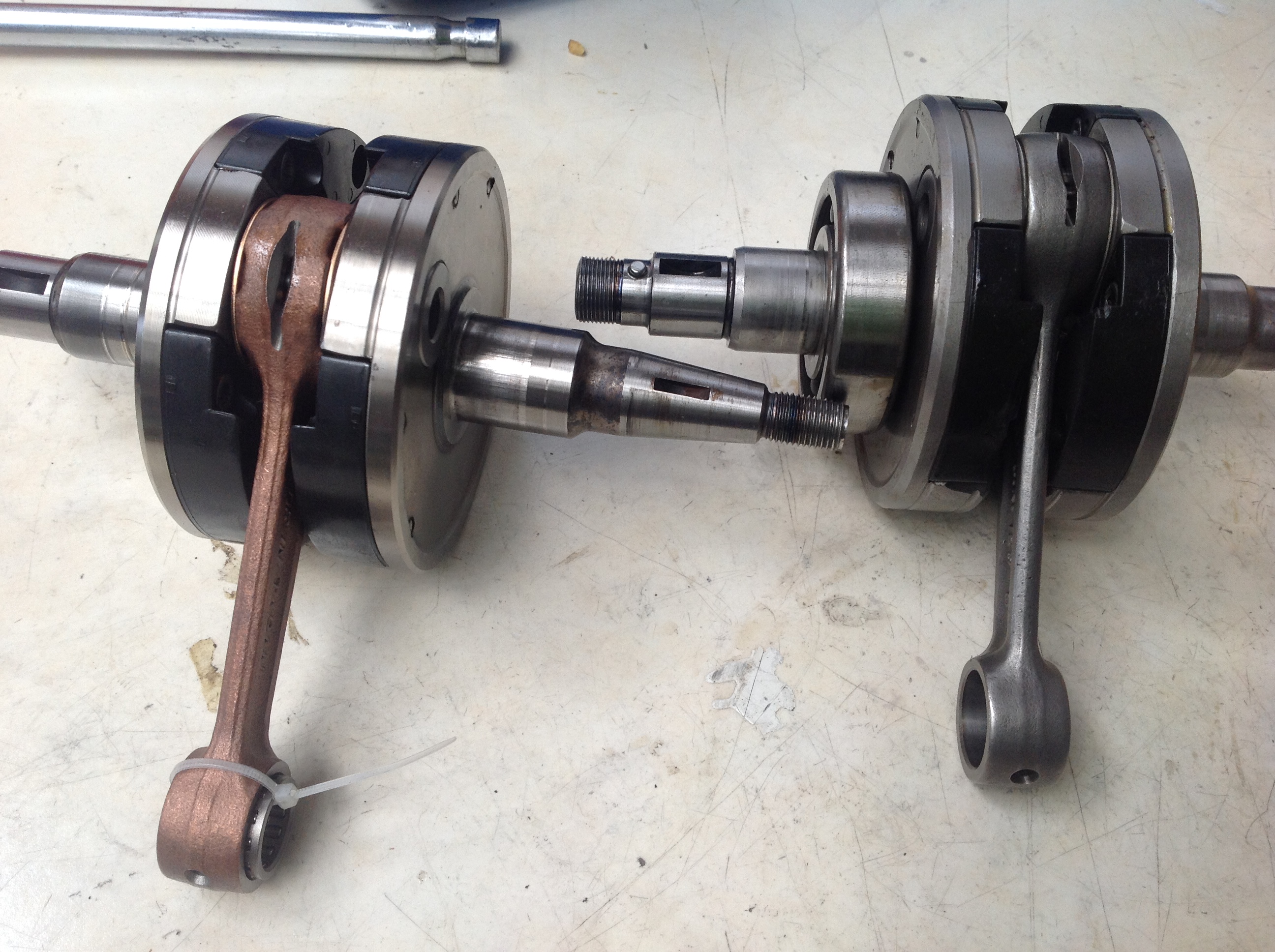

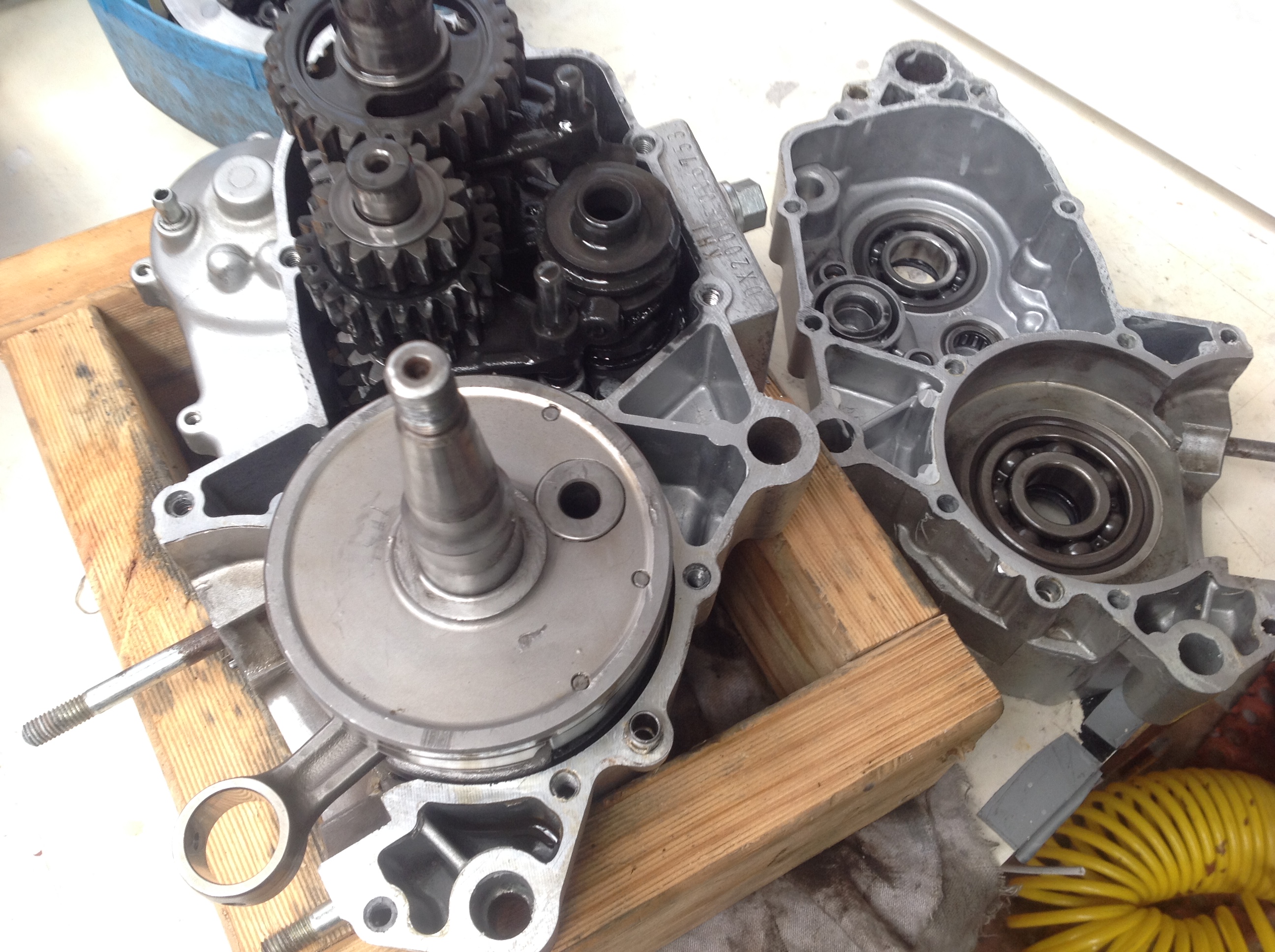

This will be my last planed rebuilde. It works with one irritating action. The crank feels out of balance.

That crank has had its go Don't recommend me as your crank builder.
Which one is the new one.
