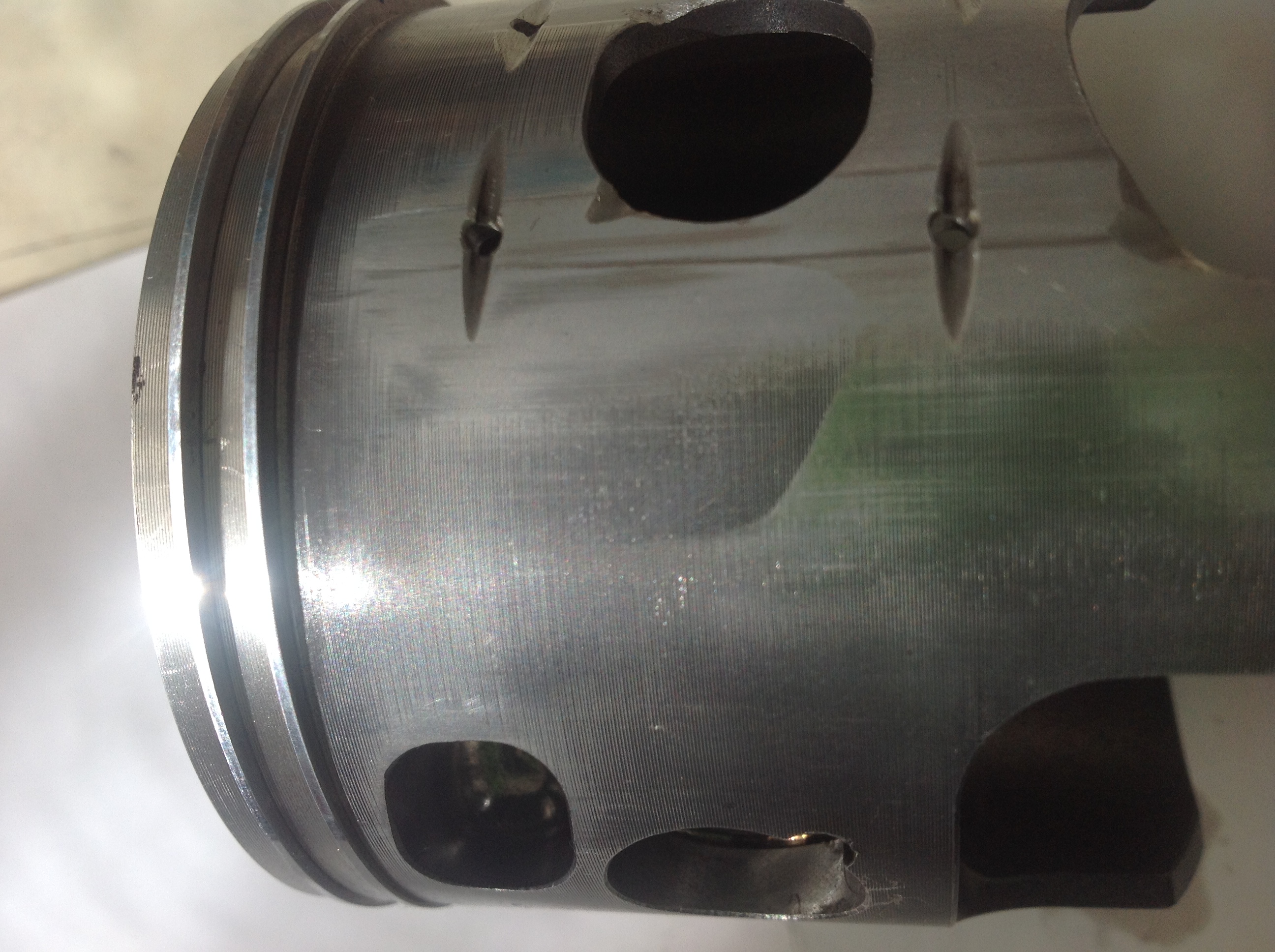

Why is this side so worn, the side is generally a low ware area.
But not this side.
You could say that area has the most metal so you take it as a metal expansion problem or poor machining. Then that could explain it.
Then why not this side
But not this side.
That area has taken a pounding and I don't think I can lube it enough to resist ware.
The shamfer on the rear cutaway is nice.
Shame the ends have half as much
And the tip none.
And the tip none.
Going the four hole lubrication system, don't think I have a choice.
Widening the bridge lubricating holes worked last time.
Similar to last time just a little more refined.
Nice shamfer
And I will smooth the ridge out.
Nice shamfer

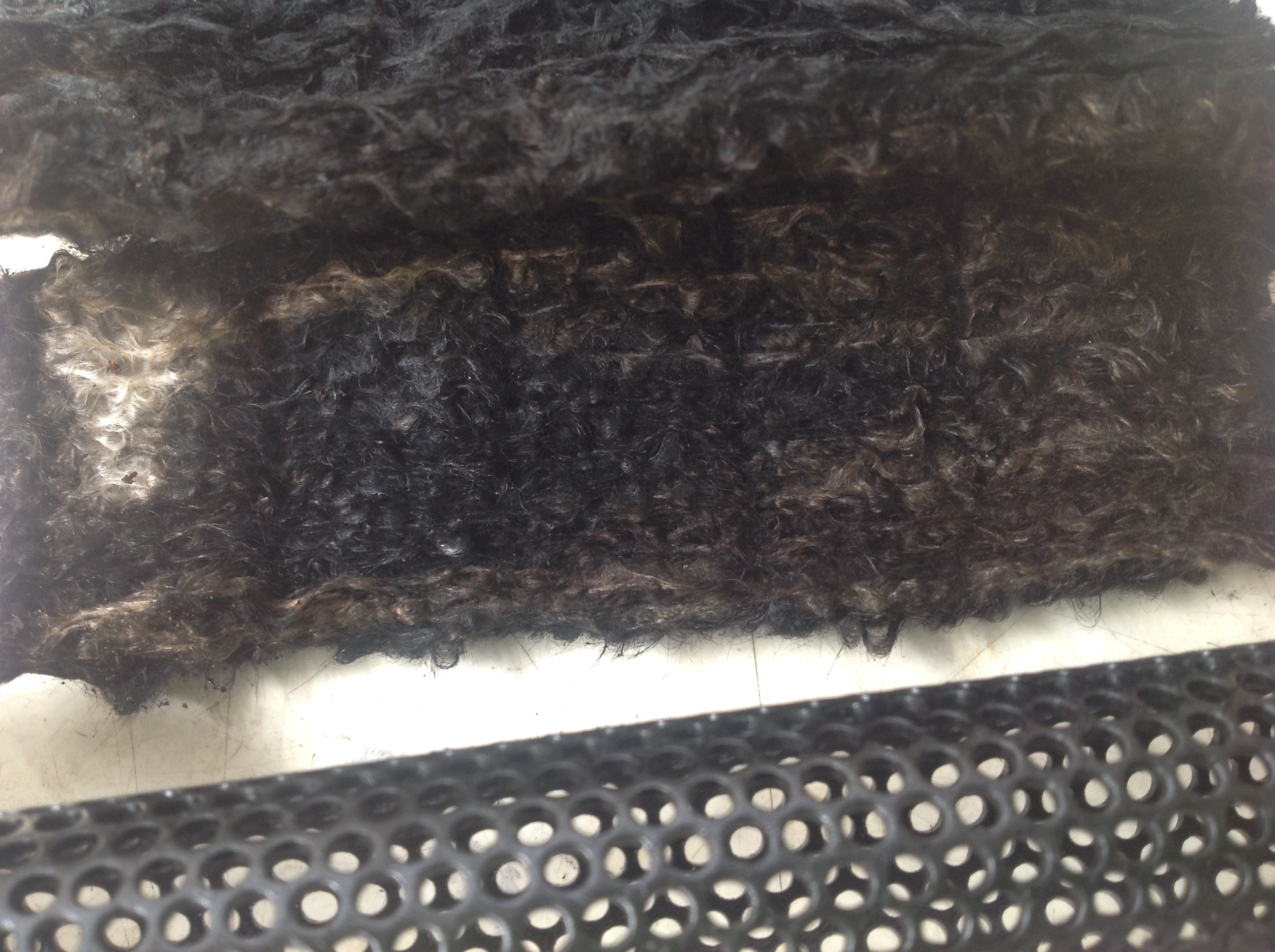

Well I now know which side of a pipe is the fastest The hottest side.
I have taken the sound wrap of most of it. Theory is it will give me bottom end back.
I had to dent that. Moving the pipe forward to use the exhaust spacer made the powervalve drive cover touch.
The expected increase in noise could be mitigated if i repacked the silencer.
Now taking the silencer apart manifests a expectation of oil.
It's dry
Oily like handling sheep.
No oil it's dry and somewhat burnt.
The perforated tube has carboned up nicely. If I could 3D print one that's what it would look like.
Nothing
It's dry
Nothing
