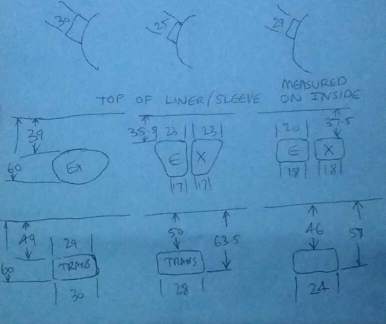

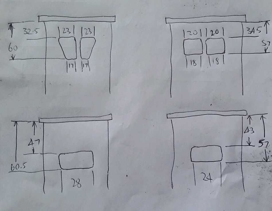

John, the port heights diagram were approximations of the cylinders without the Sleeves! Below is another drawing I have done with approximate measurements of liners but have not measured to inlet tract yet. Well spotted with regards to side port instead of Centre port and I think bringing the twin downtubes together will make it a bandaid modification so I am thinking a bigger round downtube. There is quite a bit of room to play with as the standard exhaust is in front of the downtubes and I will have a header pipe similar to or same as 247.

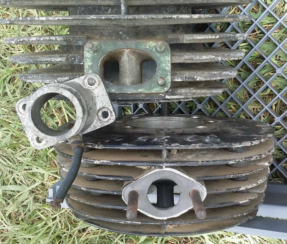

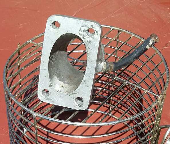

Here is a photo looking in the inlets, luckily :montesa have provided me with a bolt up manifold so I can reduce the passage to fine tune for low speed without removing the cylinder. The spigot needs to be reworked to suit 26 mm carby and may be elevated to clear the clutch cable?
Yes there is a fair bit to consider, some of it way over my head but I think I am heading in the right direction. Imagine 247 reliability with 242 Handling!

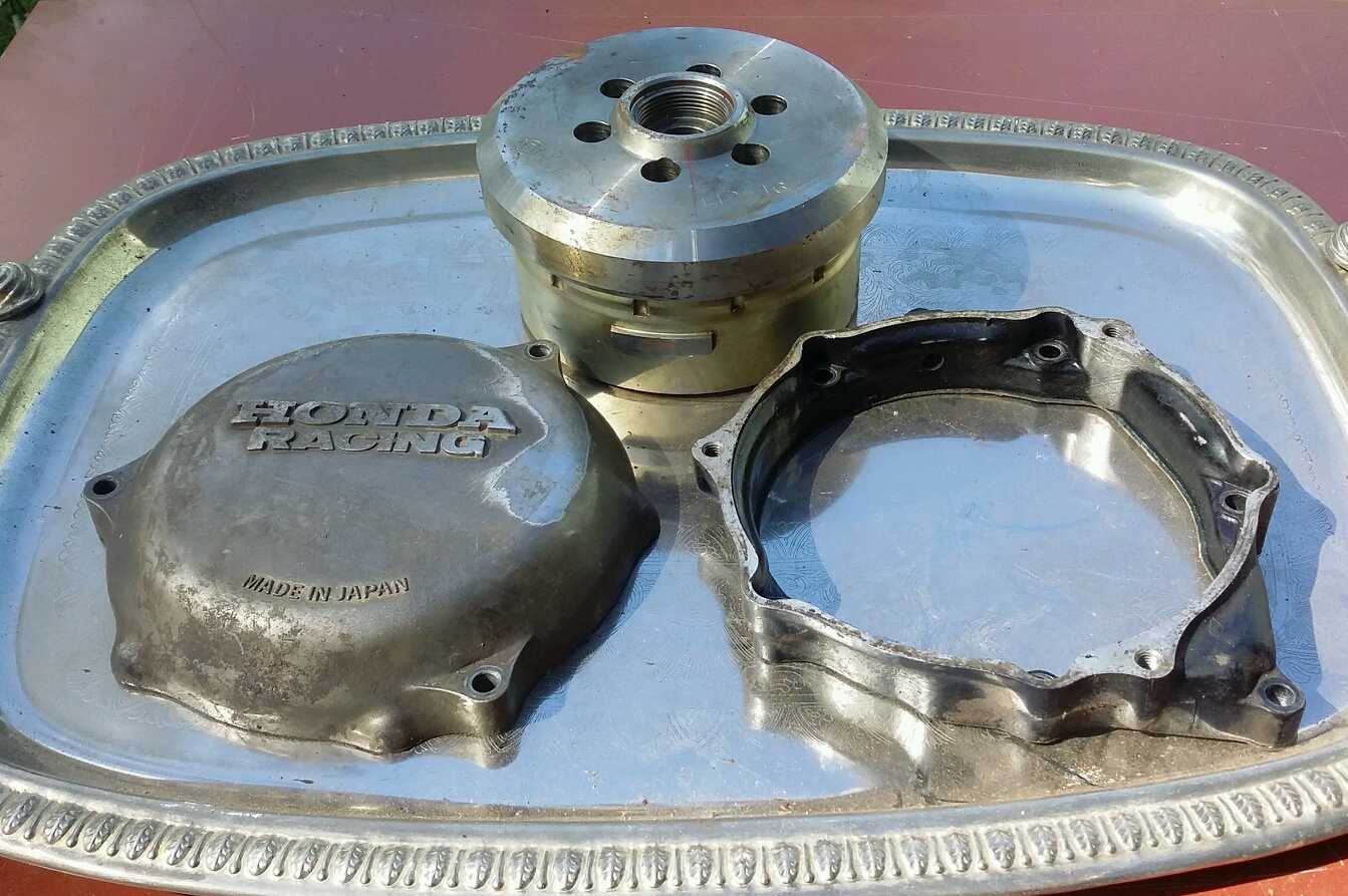

David, just thinking about your :yamaha Alpina magneto cover, maybe make an adaptor plate and cut down a TY cover something like what :honda: have done with TLM 220/260 to fit a bigger weight onto a trail bike Magneto?
The closest thing to a TLM is the MTX 200, some parts interchange:
Greg Harding wrote:David, just thinking about your :yamaha Alpina magneto cover, maybe make an adaptor plate and cut down a TY cover something like what :Honda: have done with TLM 220/260 to fit a bigger weight onto a trail bike Magneto?
That's a good idea Greg. Thankyou. I think it would even be possible to use a DT cover if I make a spacer about 6mm to 8mm thick

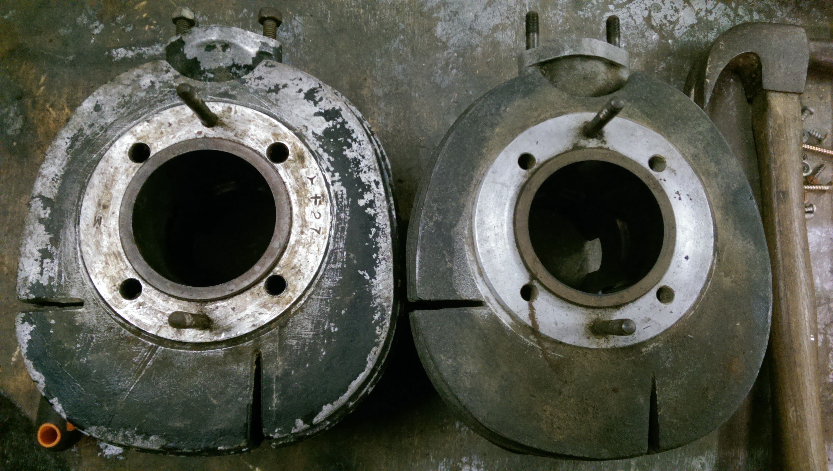

Now I'm wondering why one of my round barrel 5 speed Sherpa T/Alpina cylinders (the one that has the bigger inlet tract) has no ID stamping on it. I'll take a photo of it and post it up
Here are two 5 speed round barrel cylinders. You can see the difference in the shape of the casting at the exhaust attachment that Brownie was talking about and I've put in a photo from the top to show the (lack of) stampings on one of them

David that unstamped ones exhaust outlet seems to be angled downwards more may be just the photo though
All the 5 speed round barrel ones I've looked at are the same design as your 27 stamped one. From about m80 on the exhaust outlets outer diameter is larger. Actually any of the upswept pipe round barrel 5 speed Bultacos I've looked at seem to have a similar designed exhaust outlet as your 27 stamped one
Greg Harding wrote:John, the port heights diagram were approximations of the cylinders without the Sleeves! Below is another drawing I have done with approximate measurements of liners but have not measured to inlet tract yet. Well spotted with regards to side port instead of Centre port and I think bringing the twin downtubes together will make it a bandaid modification so I am thinking a bigger round downtube.
Greg, on those dimensions it works out the same - the transfer ducts in the 44M cyl will have to be raised about 2mm to match the Cota liner.

David Lahey wrote:I do have another mystery though because the cylinder that came on my M49 has no ID stamping, and has an larger inlet tract designed for a larger carby than the Sherpa T and Alpina. I had assumed that this was a Matador cylinder because of these two things, but the top of the exhaust port hole in the liner is flush with the casting and measures the same distance from the top of the liner as the (unmodified) exhaust port hole in the liner in the cylinder that came on the M85.
David, that is a strange combination. Some weird ones came out of the factory. They seem to have often just grabbed the first thing that came to hand, if it fit.
Its not unusual for the cyl not to be stamped. About half my round Bul cylinders are unstamped. That one may be from a Metralla (M23) .

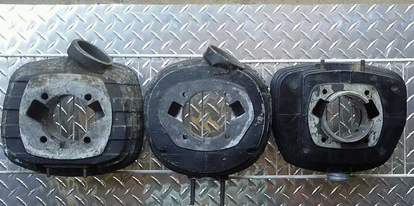

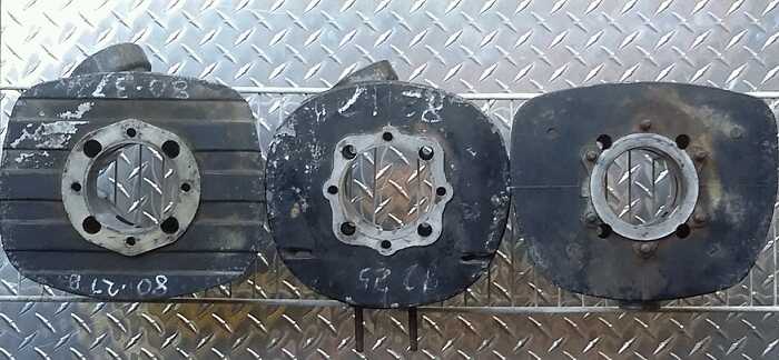

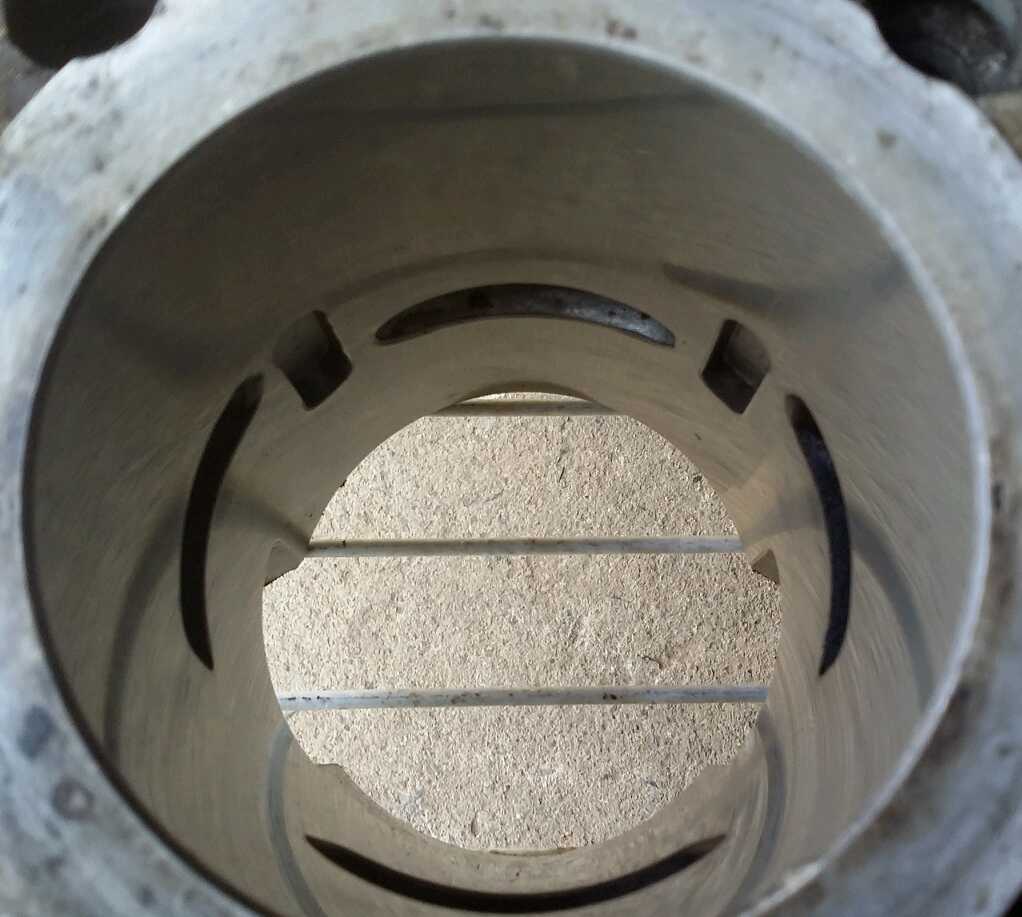

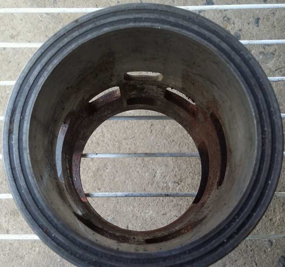

John, I really like how you think so I have added some more measurements of 3 sleeves from the inside as 242 is a chrome bore:
The 242 cylinder and piston are serviceable, it was a broken kickstart that stopped this Bike! I have only ever ridden one :montesa 242 that belonged to Chippy and yes I was very impressed with how it rode and the power delivery however I was really nervous about stalling it after Chippy handed it to me with the motor running as it was long overdue for the kickstart to snap off or strip the drive Gears!

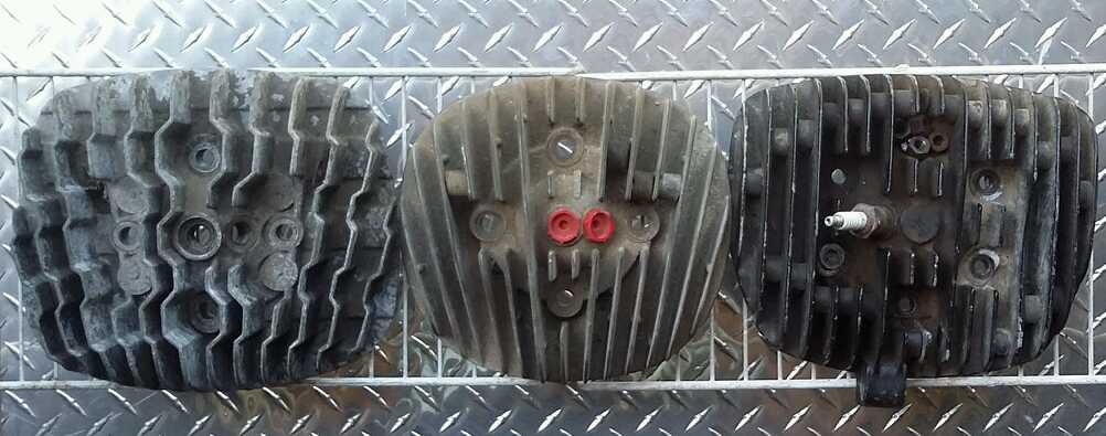

Greg Harding wrote: :montesa knew this was the era to change the shape of your head:
242--------------------------------------------------------------------------------------44M----------------------------------------------------------------------------------------------247
44M
44M
247
247
242
242
As you can hopefully see, the 242 is quite a bit different to the other 2 especially in the inlet area. Just don't ask me to explain how it works! I think the bridge in the exhaust port is a better idea for longevity and yes John the 242 transfer duct at the base of the cylinder is close to 247. If anyone can Come up with a better idea than 2 mm of the top and 5 mm off the bottom, please feel free to let us know as it is all hypothetical at this Stage? The 242 has more bore above the exhaust port makes me think it would have a higher compression Ratio?

Greg, I think there's a few dimensions on your 'mudmap' mixed up there.
However with the lower but wider transfers on the 242 and an extra boost port, it looks like the total overall tranfer/boost area is a little more on the 242 than on the 247.
But with such vastly different porting arrangements the idea of matching the 247 liner to 242 specs would be more than a little impractical.

JC1 wrote:Greg, I think there's a few dimensions on your 'mudmap' mixed up there.
John, perhaps I should explain that I snap the photos at lunch time and measure things and post after hours. The mud map dimensions can only be approximate as the ports are generally angled and around the curve of the sleeve. I have checked the dimensions and the only mistake I found was in my quote about the width of the transfer duct at the base of the cylinder should have read the the 242 is close to the 44M not 247.
242 = 30 mm wide, 44M is 29 mm wide and 247 is 25 mm wide.

Here is another mud map of 44M and 247 inlet ports:
EDIT, enough light for photo now:
TriCub wrote:As John has pointed out the bridge width on the intake could be an issue. If the crinkle rear transfer passage is wider than intake bridge you would need to weld the alloy passage in the barrel and bring it's width down before it is bored out to take the bigger sleeve. All possible but not economical.
The other idea would be to put the sleeves back where they came from and fit a longer stroke crank to match the barrel.
George, yes I see what you are saying, John mentioned quick metal before and I have no experience using it but would it be possible to adjust the duct width instead of Welding?
Secondly, 247 has a shorter stroke for a reason, I was thinking it must be better for Trials with motors running at lower Revs?

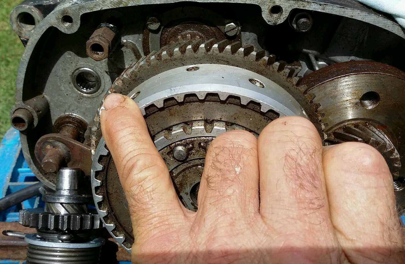

MMM, I see what you are saying here, how often do you see a 242 Competing? We have discussed this before, the :montesa 242 bottom end us fundamentally a 123 which on paper sounds like a good idea: small , compact and Light! In reality however, :montesa tried to squeeze too much into too small an area, yes parts got bigger through the series as capacities grew to 238 cc as is the case with 242. Here is a photo of where I think the problem lies:
That little hole that my pinky is pointing at is where the missing kickstart shaft used to live. The :yamaha kickstart shaft in the photo is too big to fit as both gear and assembly are too big! Now I think you are wondering what bike the :yamaha one came out of, it is a 72 cc TY 80. To quote 4 Non Blondes with different shaped heads: BIGGER, BETTER, FASTER, MORE :!:
