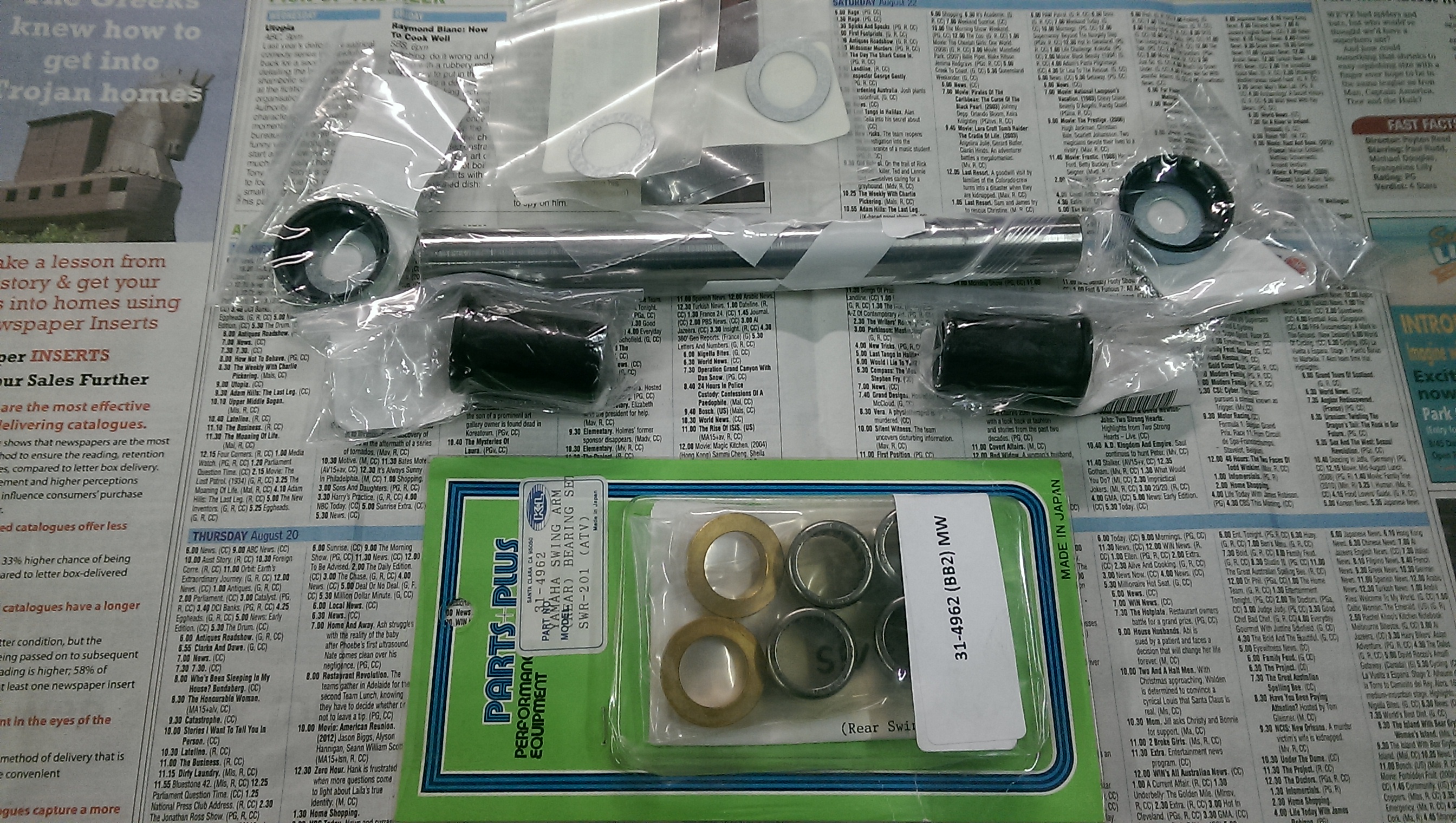

I will soon be replacing the bushes in a TY250 swingarm and decided to try out something a bit different this time.
The gear in the top of the photo are the normal bits used for this (Yamaha OEM parts and an aftermarket inner bush from John Cane in the UK).
The lower package is four needle rollers and two bronze thrust bearings from the US, supposedly for TY250. I'm keen to try them out but am wondering how easy the needle roller outers will be to get back out again when/if they fail. I think I'll need to be diligent with servicing it if/when I ride in water.
Has anyone tried this setup?
TY250 swingarm bushes/bearings
- IMAG4723.jpg (1.49 MiB) Viewed 10904 times
Hello David. Every winter I service my TY and I notice that water and dirt got in the swing arm pivot, I'll follow with interest your future post on the bearing vs bushing.
Guy
Guy

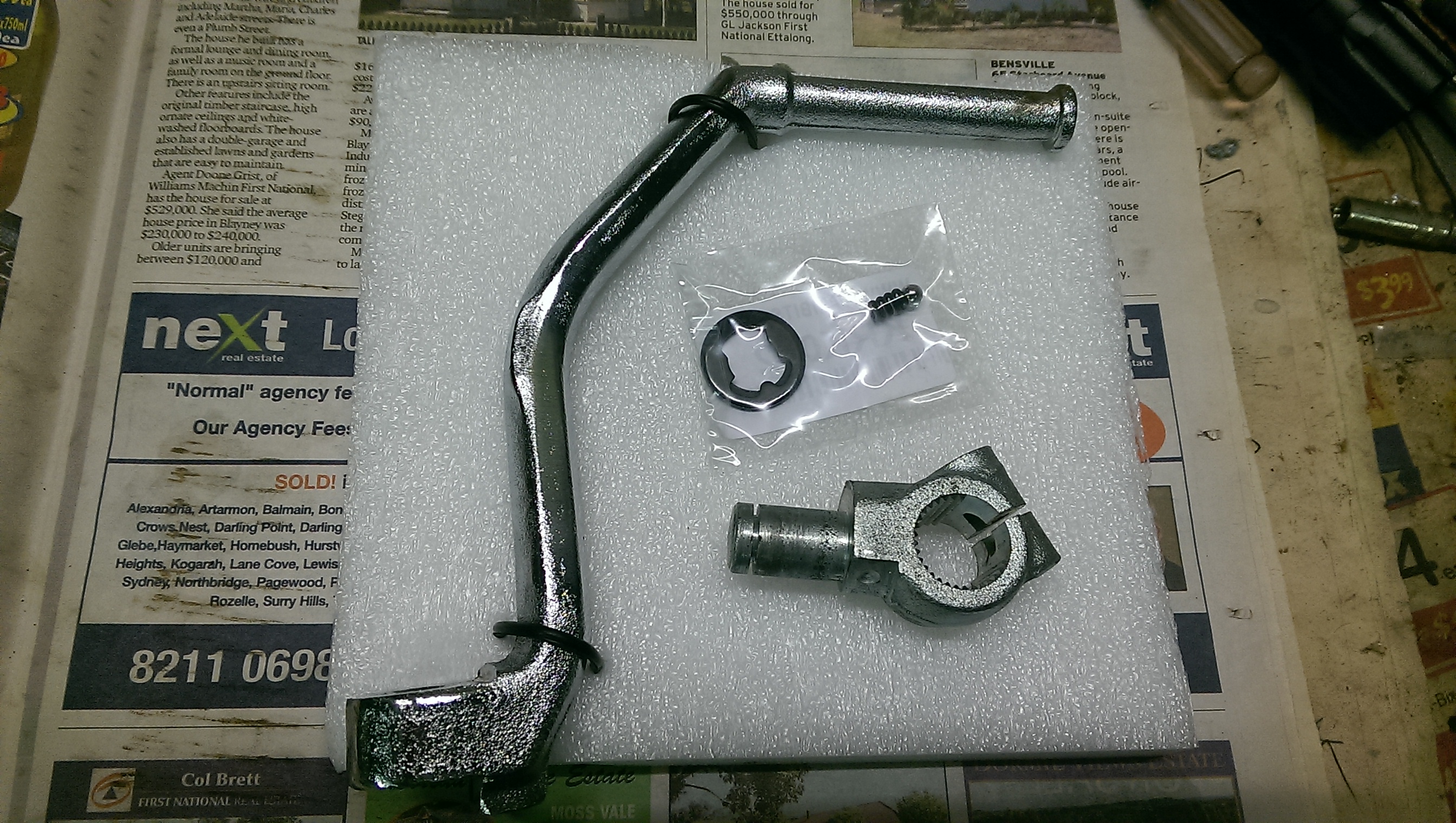

TY250 kickstart
It's been many years since you could buy new TY250 kickstart lever or knuckle from the Yamaha shop.
After 40+ years a couple of mine have suffered from the swivel pin cracking. I did buy a second-hand 1970s Yamaha MX250 kickstart a few months ago and it is very sturdy, has a larger diameter swivel pin and is slightly longer but the top end sticks out a bit and it is heavy.
For the past couple of years I have been watching eBay listings for new TY250 kickstart parts. I bought the knuckle about a year ago and the lever turned up in the post yesterday. Both Yamaha parts came from the US
- IMAG4724.jpg (1.47 MiB) Viewed 10690 times
