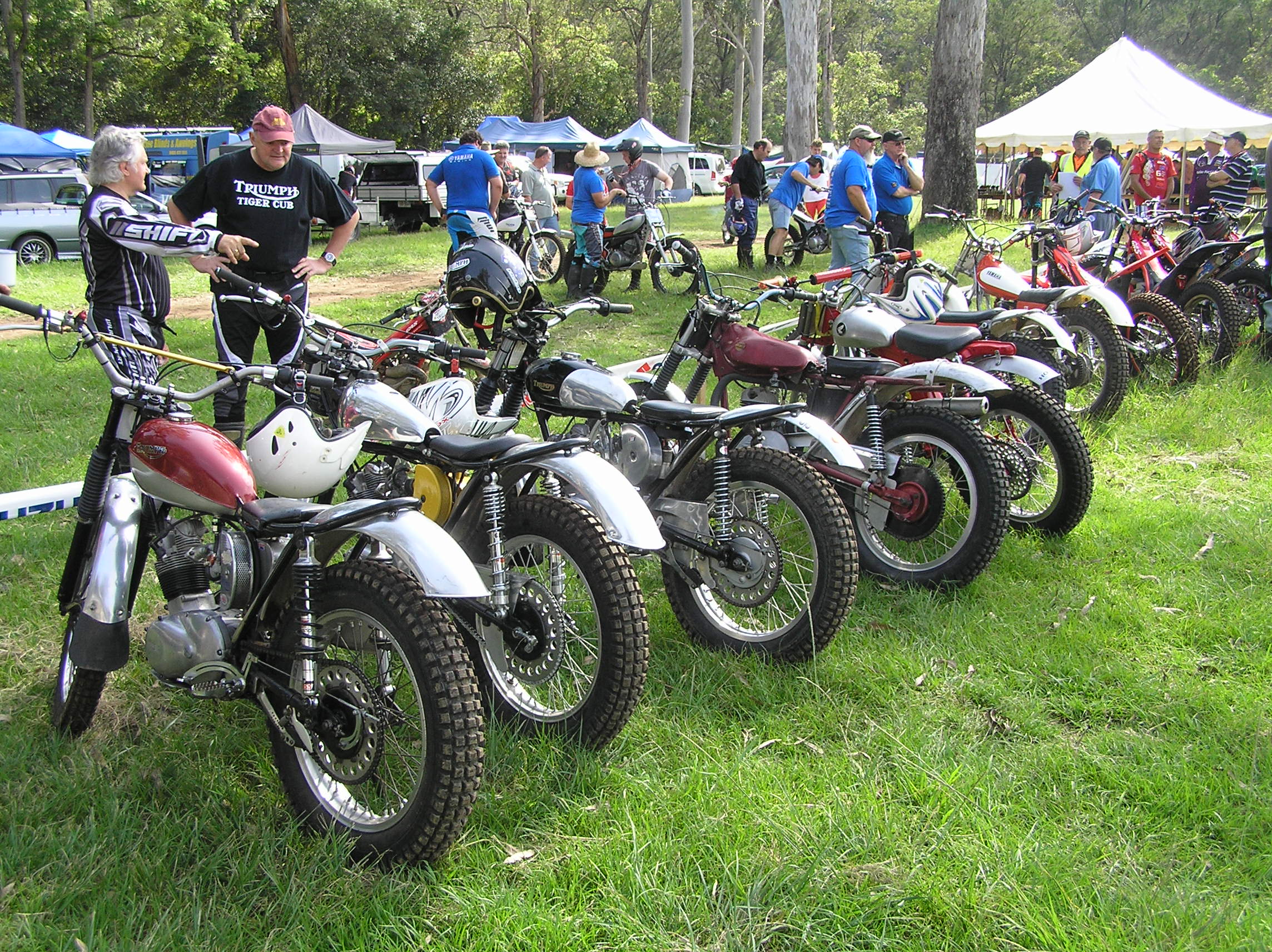

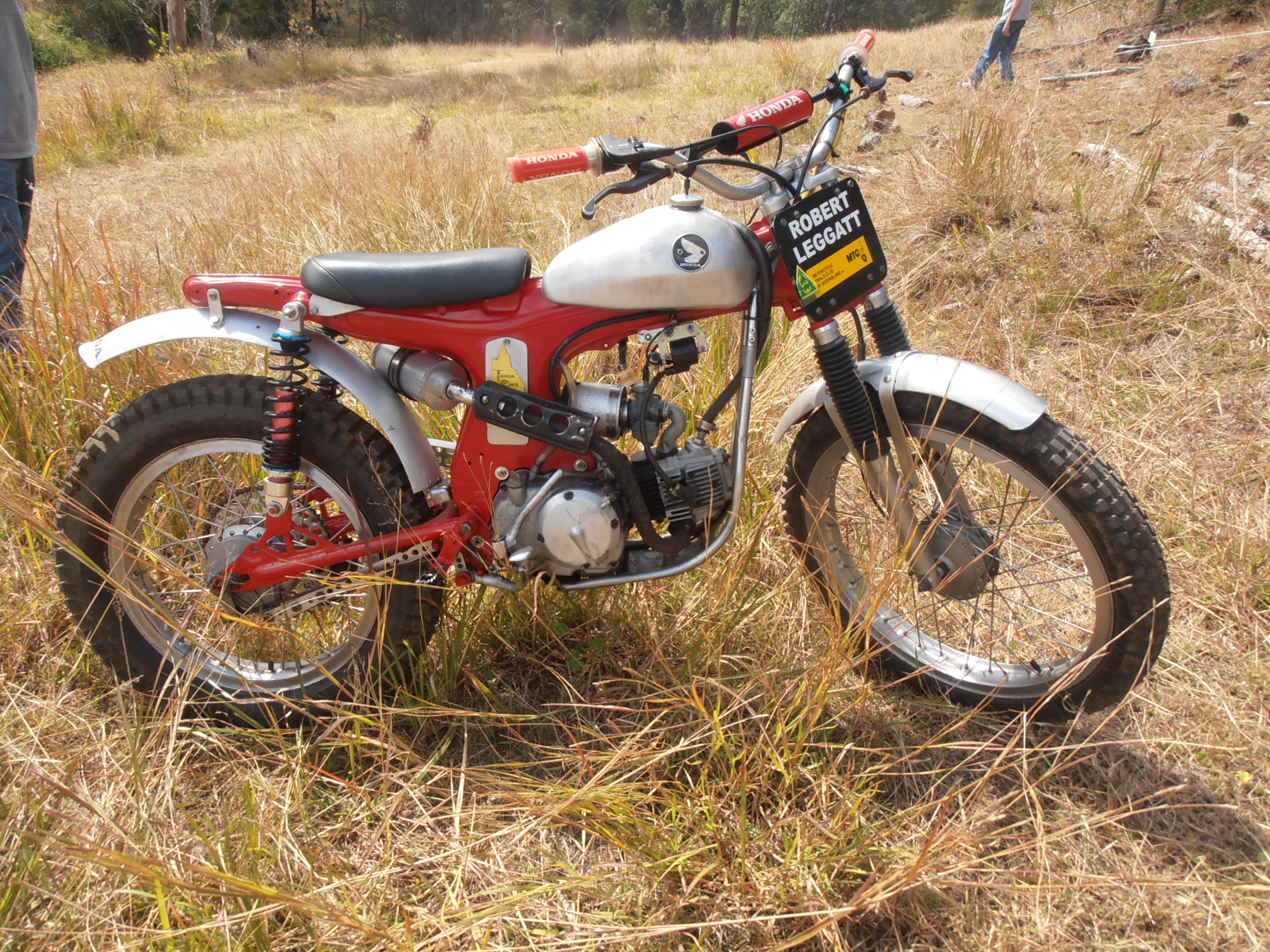

OK, here's some pics of classics in Oz, in no particular order:
- Hon S90, RLeggatt.JPG (1.78 MiB) Viewed 11681 times

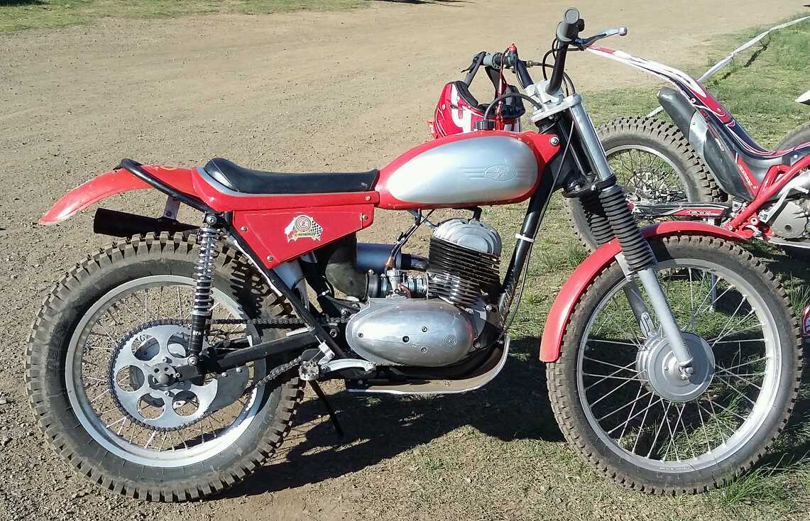

- CZ250 of G Lewis.jpg (461.01 KiB) Viewed 11681 times
- Ariel Colt, Connondale 2011 Classic Dirt, P Ariel & C Gillies.jpg (609.42 KiB) Viewed 11681 times

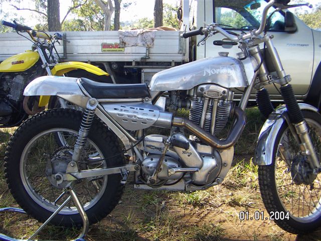

- CD6 Norton Trials.JPG (94.82 KiB) Viewed 11683 times

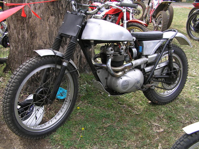

- Triumph, PLimbert.JPG (144.61 KiB) Viewed 11683 times
- P1010053.JPG (909.06 KiB) Viewed 11683 times
- Sprite trials.jpg (182.22 KiB) Viewed 11683 times
- CZ 175 trials, 2015 Oz Nats, GHarding pic.jpg (168.45 KiB) Viewed 11683 times

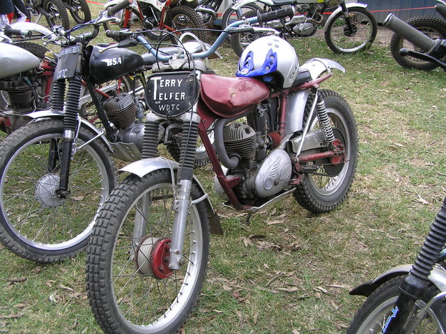

- Bantam-Villiers trials (CD6).jpg (149.06 KiB) Viewed 11683 times

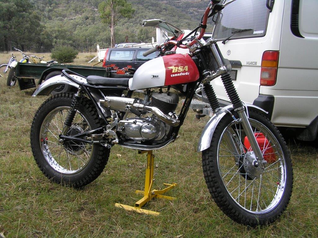

And a few more:
- Bantam, Comerfords tribute 2.jpg (206.06 KiB) Viewed 11330 times

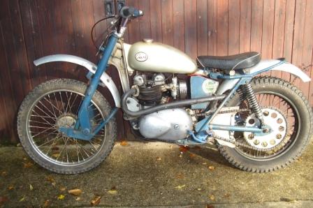

- Ariel HT5

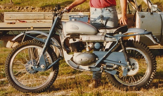

- Greeves 1960 24TCS.jpg (126.86 KiB) Viewed 11665 times

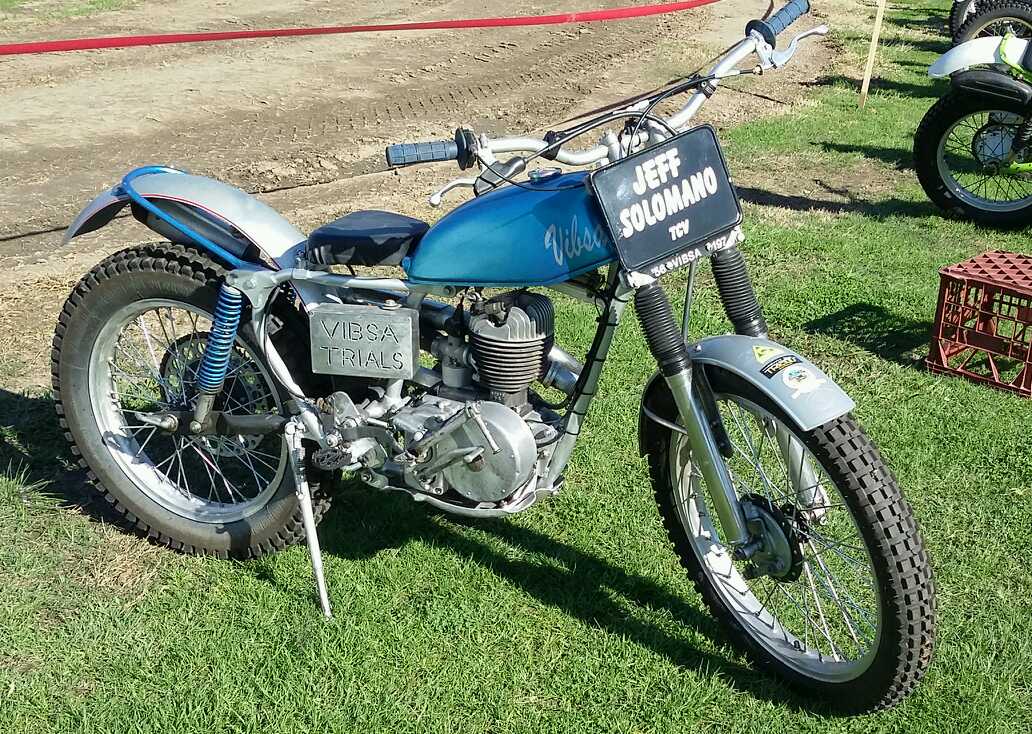

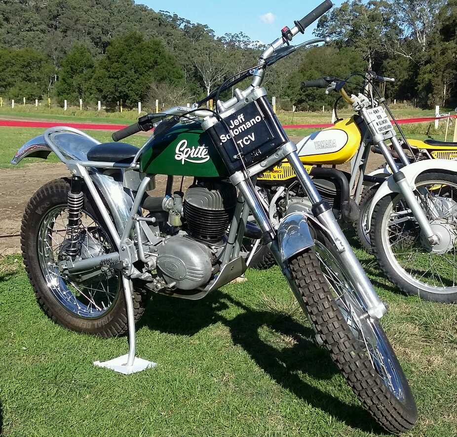

- Vibsa, JSolomano.jpg (190.75 KiB) Viewed 11672 times

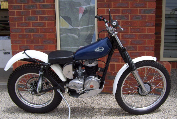

- Vibsa 200 2, Chris Leighfield.jpg (263.39 KiB) Viewed 11672 times

- James 197, T Telfer.JPG (151.58 KiB) Viewed 11672 times

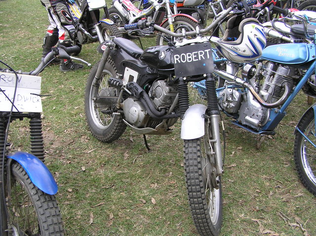

- Honda twin, Rob L 2.JPG (151.94 KiB) Viewed 11672 times

The Vibsa with the blue tank was the first Vibsa that Chris Leighfield built and photographed outside my house, I bought it off him in 2008. It was a 197cc Villiers motor in a BSA bantam frame with highly modified ****** forks,,, ssshhh.
I rode it a couple of times but the power wasn't to my liking (2 stroke) and the brakes needed improving but Chris persevered with the VIBSA theme and produced two more before he passed away.
It won a "Best presented Bike " and first place in Classic grade at a Logan river trial and I sent the "best Presented Bike" award down to Chris before he died.
Hey Jeff, is that one of the other Vibsa's in the pics above ??

Hi all, nice collection of classics. Wouldn''t it be nice to see them at a trial, now that would be nice! My blue "vibsa" is one I put together but have only ridden a few times (spoilt for choice!) . I thought , from memory the blue tank Vibsa hat Chris built was a 150cc and maybe ended up in Queensland? A biased opinion but it's hard to beat a Villiers 6E "something" for bang for bucks. Even with the 3 speed they are lots of fun for lower grade riders (not a Cub or CZ beater) .
Cheers Jeff
Cheers Jeff
