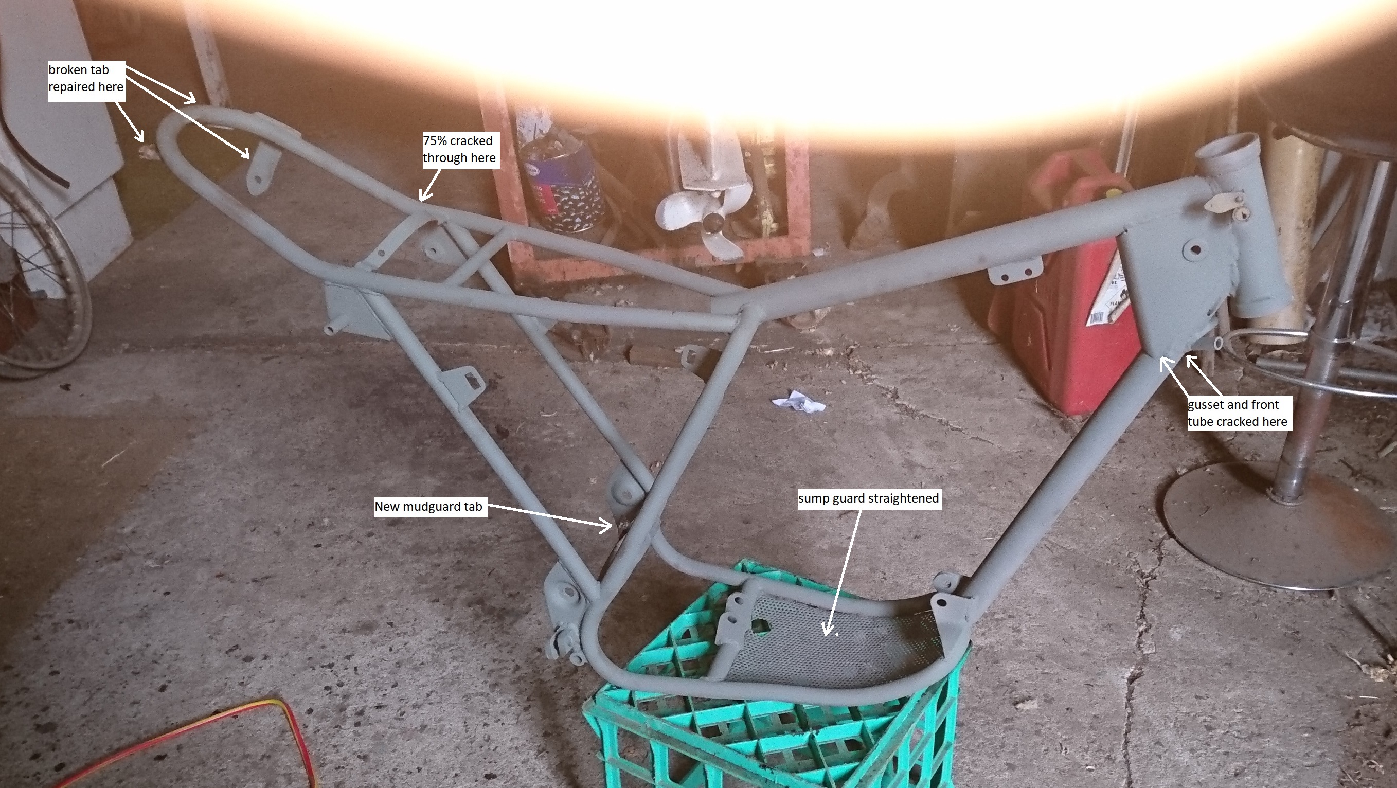

Thanks David. Project seems to have started a bit earlier than expected. I found I needed to strip things down to find just what parts I need and need to repair. So it's stripped to bare frame and sand-blasted to A clean it up and B so I could do a full inspection. Just as well as I discovered frame cracks as well as missing mounting tabs all over the place. Cracks have been ground out, welded and reinforced, then stress relieved and all missing tabs replaced. A heap of parts has arrived from overseas and local supply, with more on the way. The bike was a lot worse than first thought as all "bits" were badly weather damaged from years of neglect and weather exposure. Hold up at the moment is the fork tubes, one is usable but the other needs full grind and hard chroming, so I need either one good second hand tube, or pack the pair off to Brisbane.
Anyone have a spare reasonable fork tube to suit??
