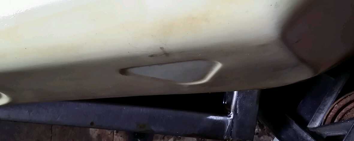

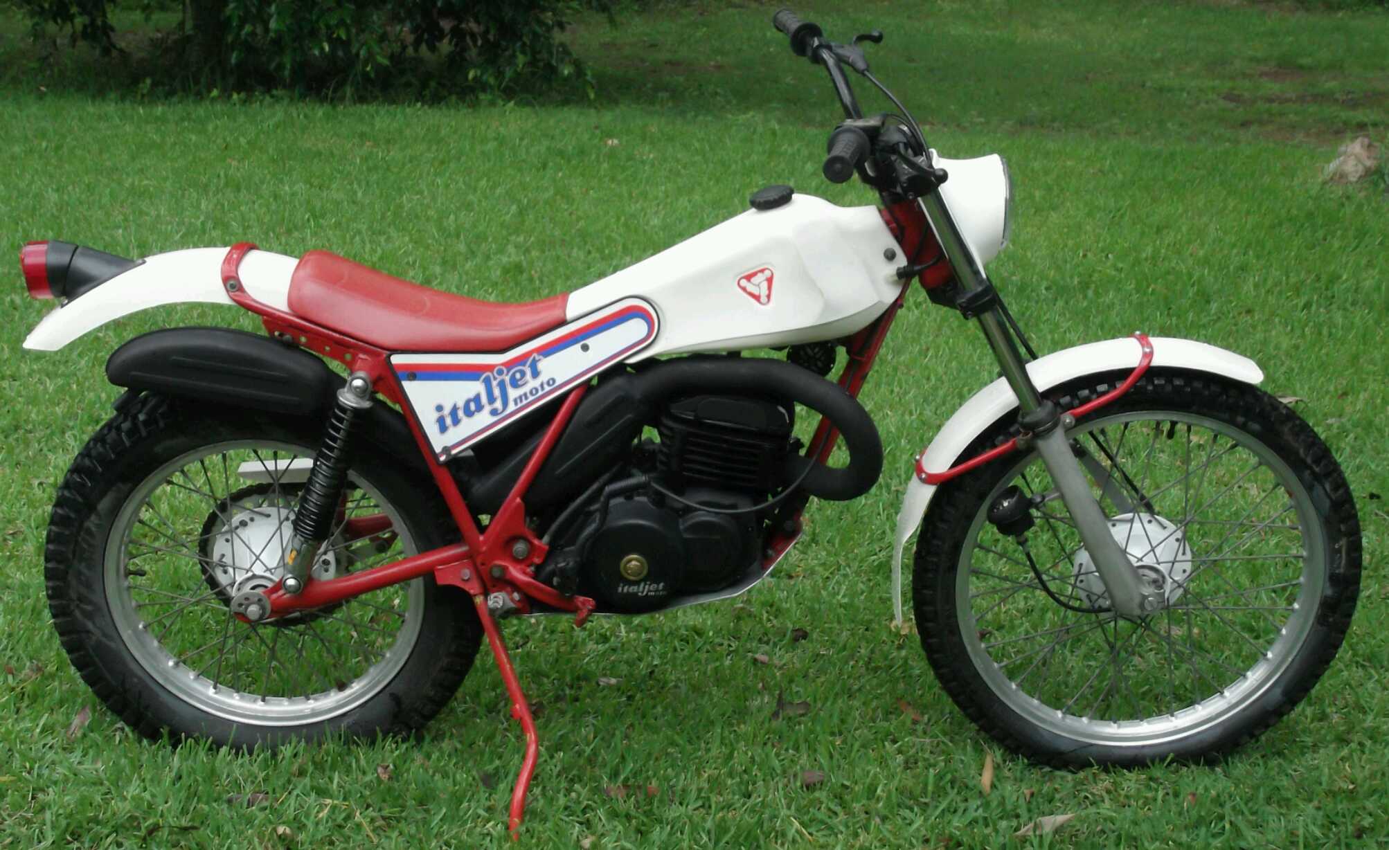

Bully fanatic wrote:That looks good Greg. I know of a very late Piuma with a red frame, 2/86 on the compliance plate which sat for years with no fuel in the tank.
I got it going last week and we left some fuel in the tank and it cracked on both sides on the front sharp bend behind where the 250 or 350 stickers are supposed to be.
It ran well but now needs crank seals and the petrol tank being repaired. It is a 350 by the way. It had only done 3 trials with a sidecar on it. Oh well! :italjet:
Graham, thank you for the Photos! Something tells me the RED :italjet: were all 350? Trail and Track October 1986
The bike looks really good Graham, there was a Red one just over the hill from me that belonged to a Mate before I met him, when he told me I thought it was a repaint. Anyway he tried on a couple of occasions to track it down for me but no such Luck!
The photo of the tank shows the sides sucked in stressing the corner which is what happened to mine just before cracking.

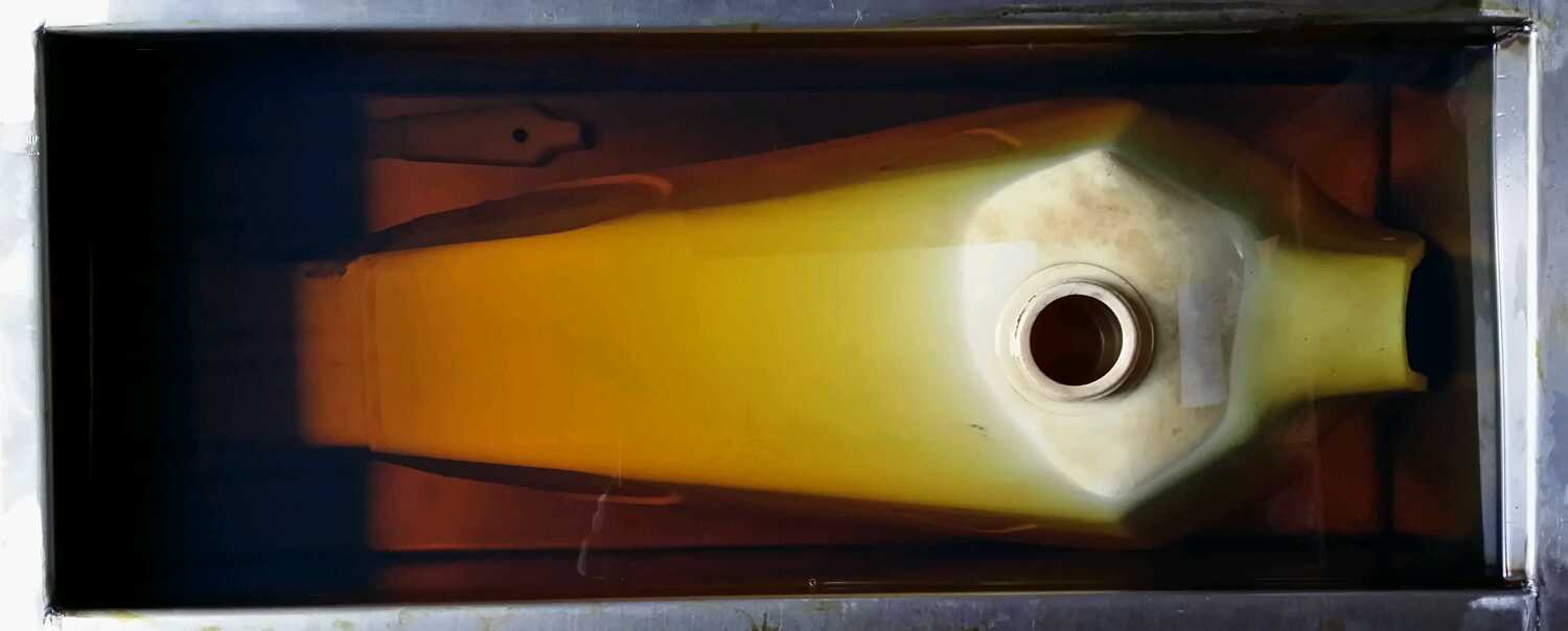

Anyway, curiosity got the better of me so I had to have a look inside:
The fuel level has gone down, I think the insertion rubber is absorbing it as it has grown and the fuel has gone a darker shade but still good for the Fergy!
The sides seem to be holding their shape and I can't feel any cracks but not ready to order a coffee yet David!
Anyone got any suggestions about how long I should leave it in the Tank?

So after some new crank seals and a new condenser the red Italjet now starts and runs very well. I did also have to clean the carby out again. When I first pulled it apart the carb had all this black stuff in the float bowl and it was hard. After all of that it goes again. Engine is very nice. Graham. :italjet:

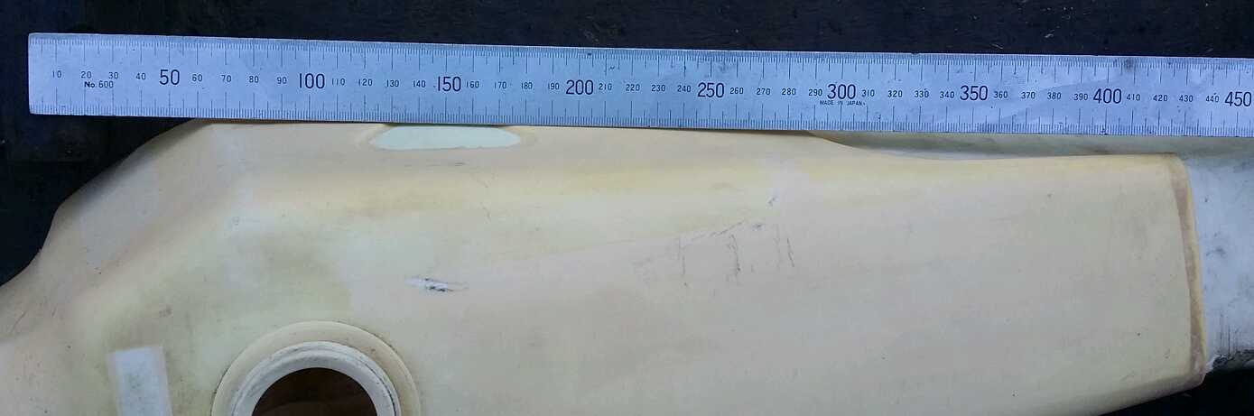

Don, your :honda: tank would have to be much thicker than the White :italjet: one which feels like about 2 mm thick in the sides.

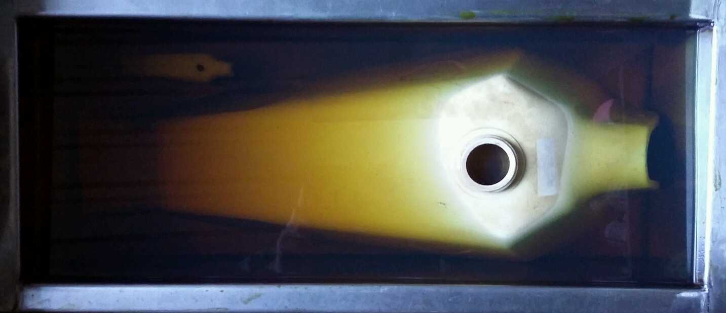

After a bit of thought, I decided to soak the tank in the fuel that I intend to use, BP Ultimate.
As discussed previously, E10 is really good for dissolving rust in old steel tanks but until now I have not talked about my experiments with E85. Yes the type used so sparingly in V8 Super cars:
My theory was fairly simple, If E10 works than E85 must be 8 and a half times Better! Wro, wron, well it was a little better, maybe 10 percent but not worth the expence. Plus it came with a warning: Do not get it on your skin and Do not wash parts in It! So shaking a partly filled tank with magnetic drive bits inside to loosen and grab rusty bits is almost impossible to empty without getting it on your skin.

Anyway, here are some photos:
The sides have actually Bulged Out unlike my last tank that Sucked In!
Now for the thinkers, there is something dodgy in 2 of my photos, 1 in last post and 1 here! Have you worked it out?
Would the dodgy bit be the extra small fuel tank in the corner of the stainless petrol tank holding tank? Top left. Very sneaky Greg. Having a mini :italjet: Piuma and not telling us. =D>
