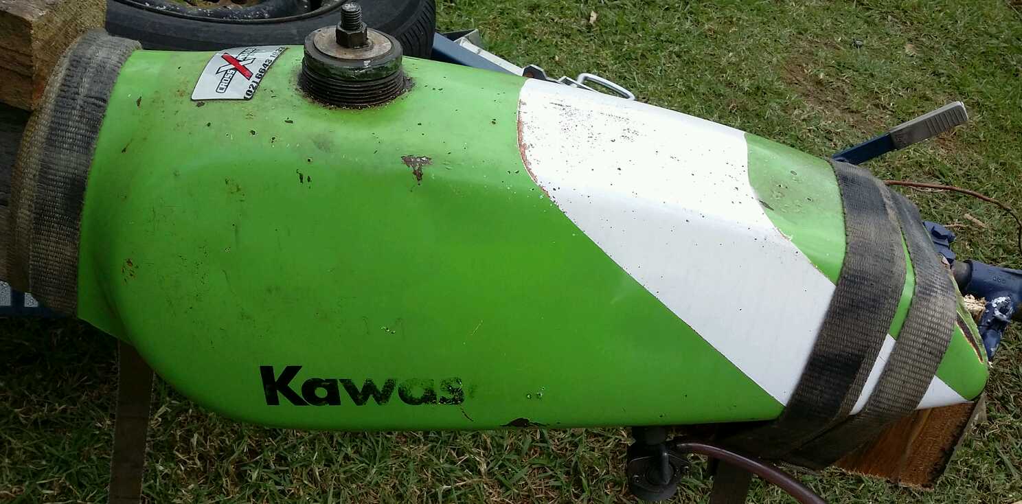

Greg I have had some success with compressed air with shallow dints like that on the :kawasaki KT. I did a :Honda: TL125 tank and blocked all the exits & at first I put too much air volume in and the tank splayed out somewhat.
However the process did work after having to re shape the tank back.
Chippy
Chippy, I too have splayed out a :Honda: TL 125 tank, the arch inside is fairly straight so not much to stop it opening up. One of my :yamaha TY 250A tanks had been pressurized by the previous owner and the side effect was to make the tunnel so small it would no longer fit over the frame.

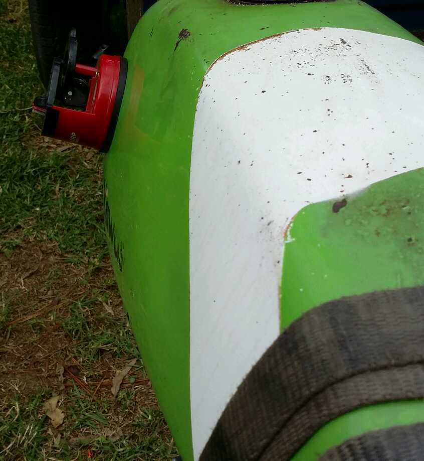

After considering the suggestions and what I had learnt, I made a jig to hold the :kawasaki tank with timber and packers in the tunnel and wrapped ratchet straps around each end to stop it spreading.
Jools wrote:Yes Chippy, but the danger is that that technique can blow out good seams.
EEEEeeek!
The actual problem is that with compressed air you can't control WHERE the expansion happens, so it's just as likely to split a seam or push out a good area as fix the dented bit.
Maybe if you heat the dented part to soften the metal there then pumped it up...
I'm a sucker for the sucker.

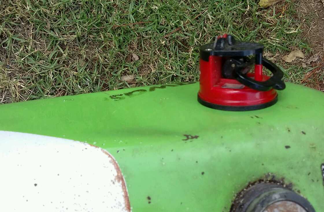

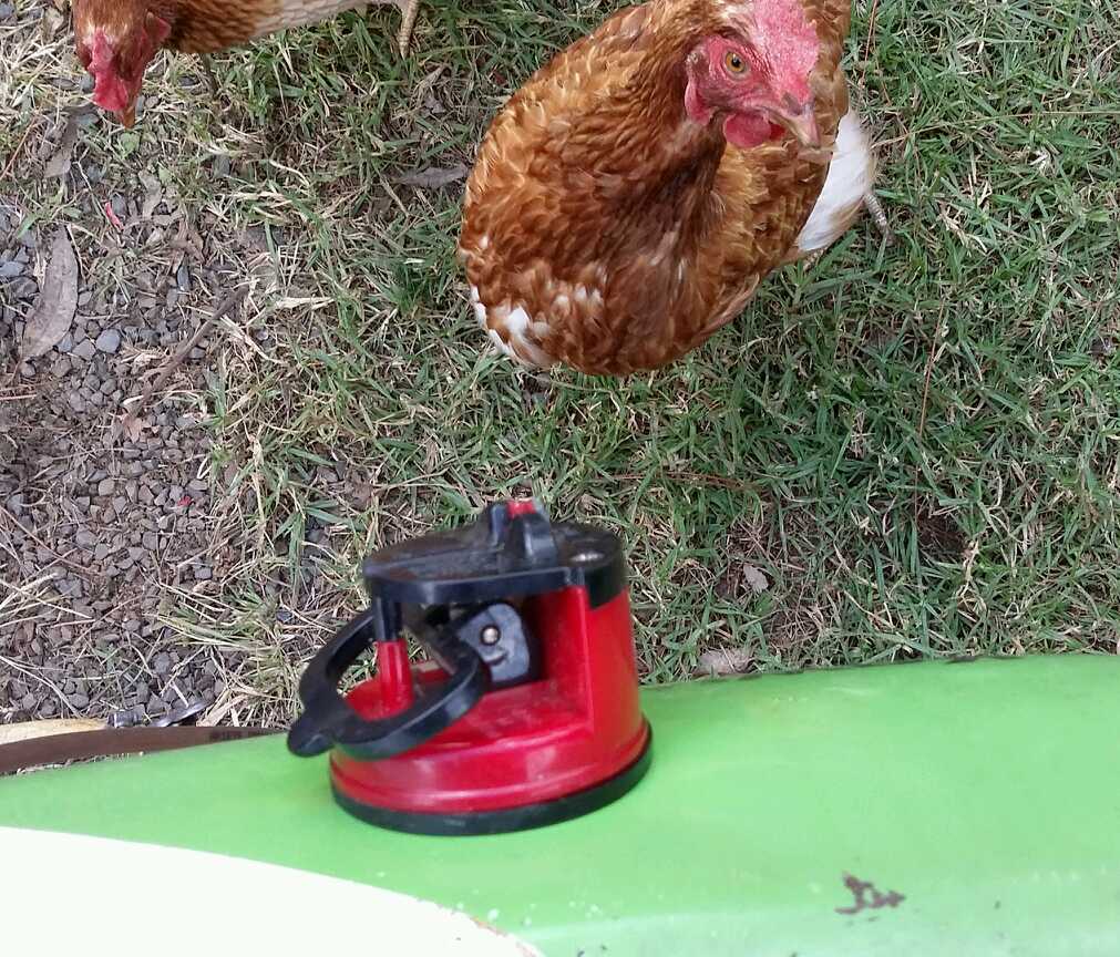

Jools, that sucker would be good on big flat panels like the side of a van but would not seal on ripples.
However I do have one of these:
So with a little help from some offsiders, a combination of pressure inside the tank and the little sucker pulling, we were able to get most of the dints out. Good enough for this old girl and I like the 43 year old patina!
Now I am considering Rare Earth Magnets for the crease near the top. Maybe one on the inside and one on the outside with a pulling hook?

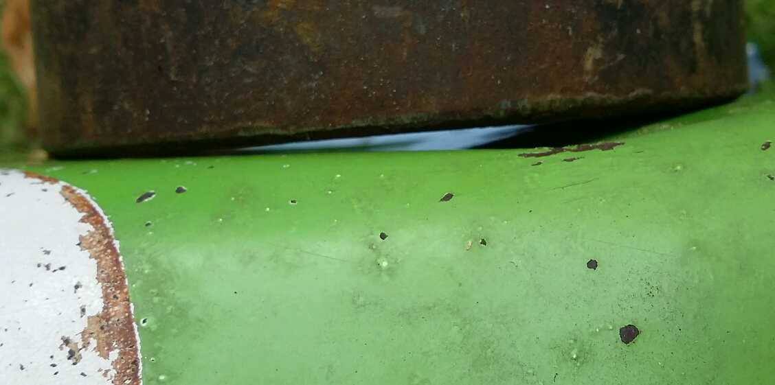

The last little bit of the dint in :kawasaki FrankenKT's tank is more difficult to remove than I first thought. This looked like a good thing:

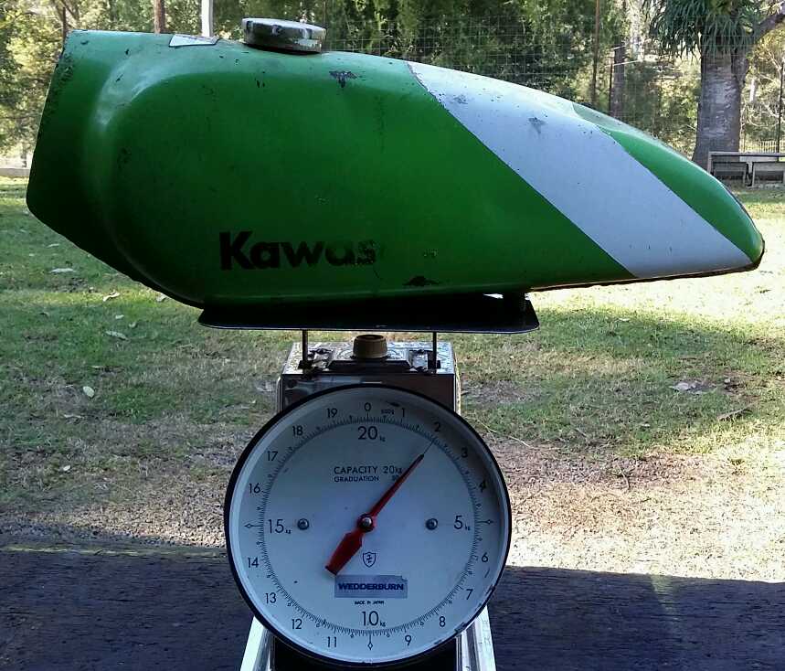

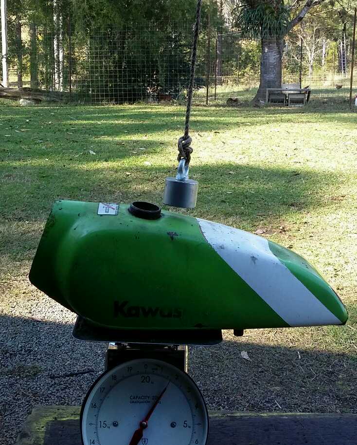

Wow, I thought, a magnet that will pick up 200 kg, that should pull a dint out of a steel tank? But it seems, I was wro wro ____ng:
Empty tank = 2.1 kg.
Magnet hovering over top only lifts 300 grams or in other words it reduces the weight of tank to 1.8 kg, somewhat short of 200 kg lifting capacity! In hindsight, that bloke only looked good for 35 kg, so I think I have been suckered again, just think all that way for very little result. Now I am not one to give up easily so I had a rethink about the tank only being sheet metal and hollow. My solution I thought was to add another magnet inside the tank to increase the attraction.

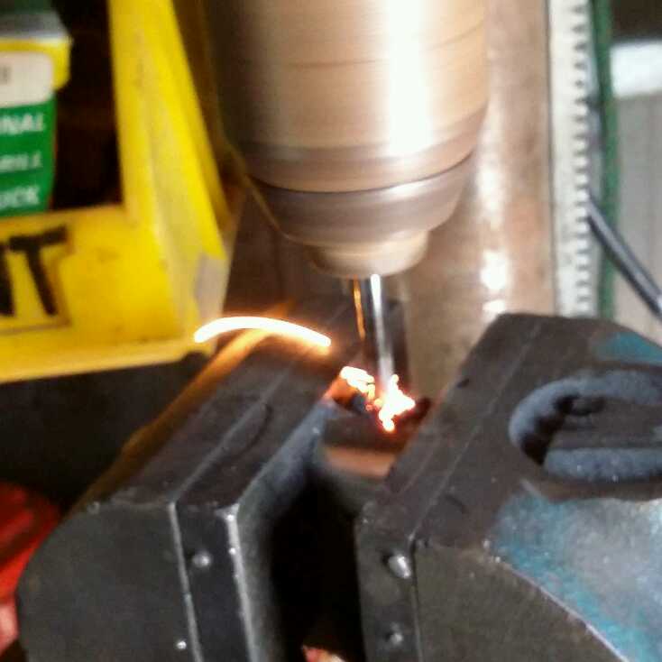

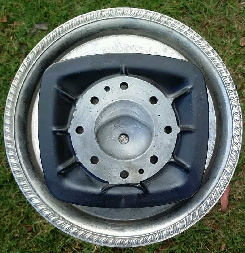

☆☆☆ Warning, don't do what I did, that is put 2 neodymium magnets close together to feel how much they attracted. The result was little magnet left my right hand and struck the big magnet with enough force to chip the surface in three places with a spark big enough to start a worn out :Bultaco: !

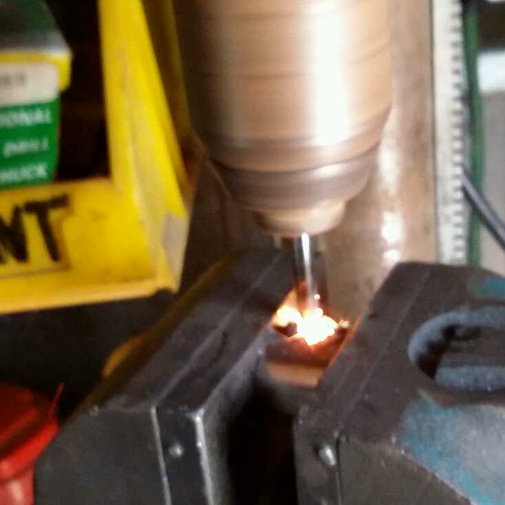

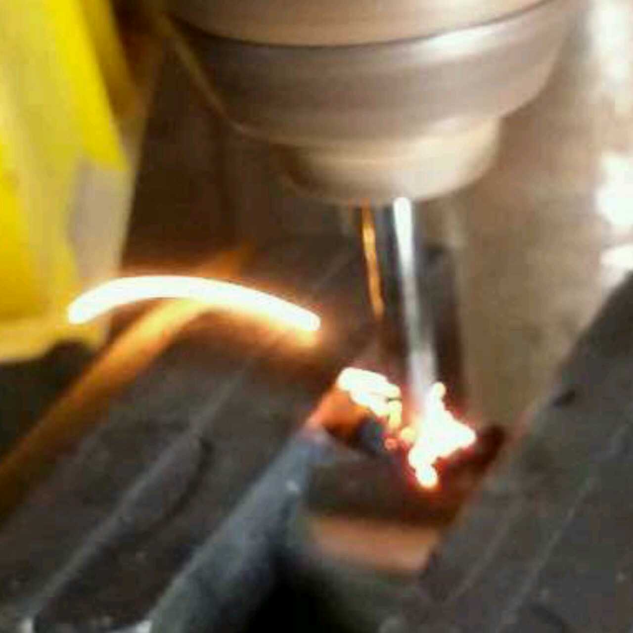

OK, now how do I get the magnet out if the tank if I put it in there? Using the old theory about taking a liability and turning it into an asset. I decided to drill a hole through the damaged outer surface for a draw wire to remove it from the tank:
That was another fail! Anyone got any brighter ideas?
Don't "permanent" magnets lose their magnetism if they are heated up a lot? Maybe as atest try heating up the magnet you tried to drill a hole in. What can go wrong? :shock: :roll:

Obviously it was the first time I have tried to drill a magnet, it worked at first. The principal is fairly simple, the cutting edge does the cutting and the twisted flutes remove the swarf but in this case the swarf would not leave! It bundled up and generated heat, I think you are right about heat causing a loss of magnetism, the curved spark was one of the Clingons leaving the Party!
