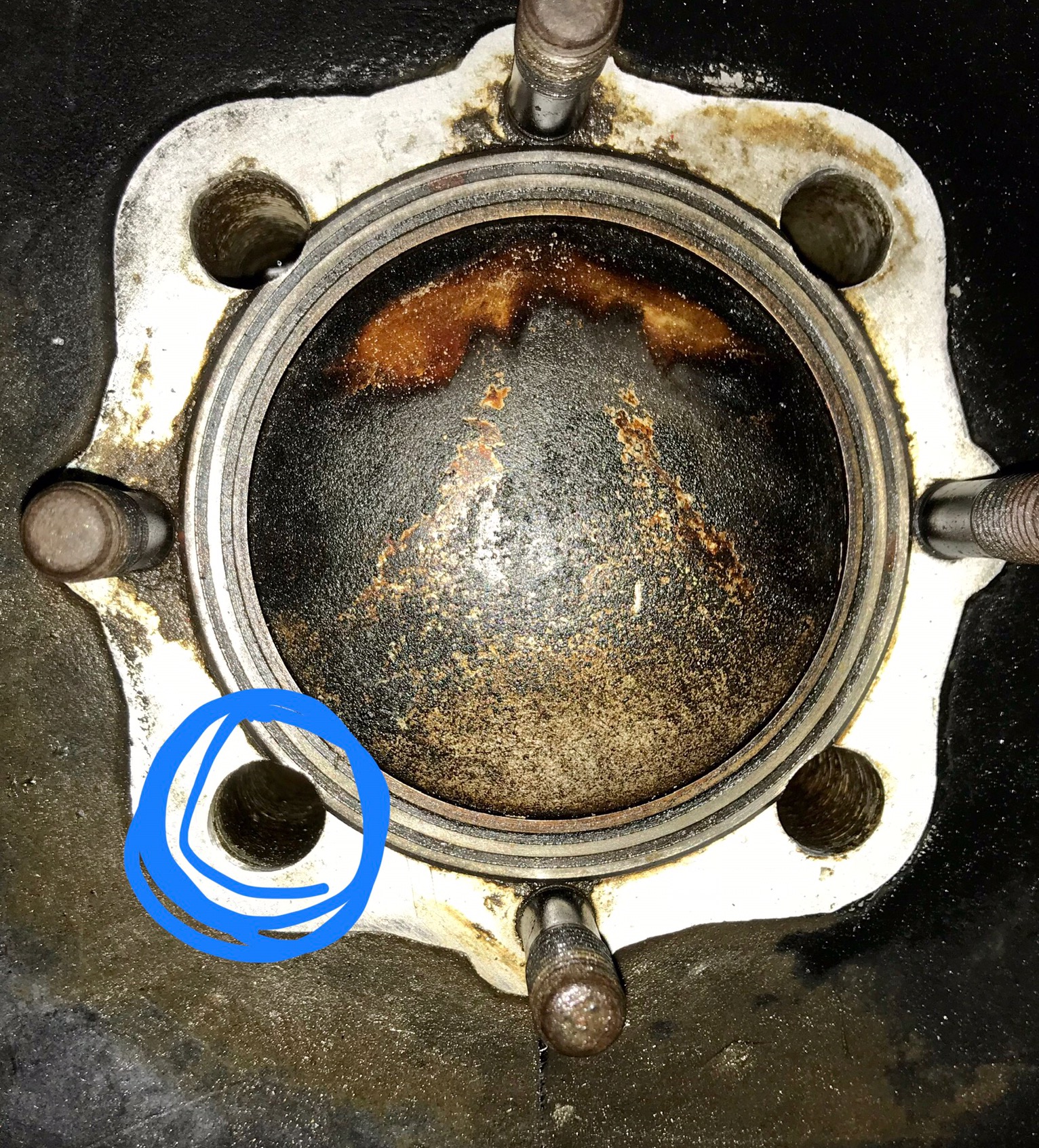

Ok tried everything now, absolutely no movement from any head bolt. Tried brass drift, heat, numerous penetration oils, impact driver, rattle gun.
I’m going to outsource the problem.
Any got any good small engine specialist north side of Brisbane?

Barrel bolt
Barrel bolt
I can 100% confirm that an impact socket on a 1/2inch rattle gun has only helped me start the rounding process so I can start drilling out the nuts!! :oops:
This :montesa is fighting me all the way, reminds me of an old girlfriend but meaner.
Time to get the drill out I think.
