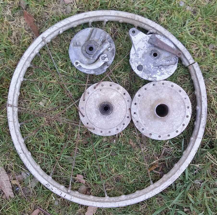

I am getting off to a slow start with the refurbishment of my TY175. I'm stripping bits for vapour blasting at the moment and it's brake hub time.

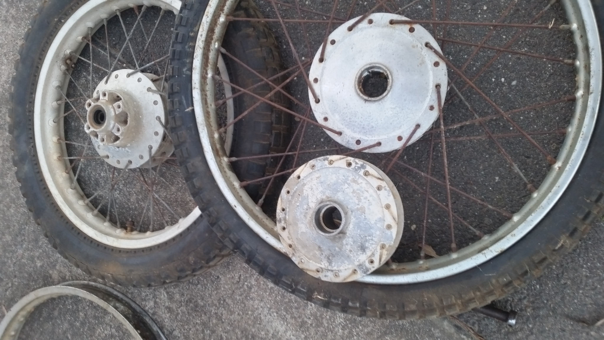

I have 2 different types of hubs and am not sure if 1 is a ring in, or if it's correct. The problem I have is that all 3 of my TY's are 1976 build, 2 are standard C models and the other is a road going version - the JC?
So I stripped a front hub out and looking at the other one from the JC, it looks way different. The rim is also chrome. It wasn't fitted completely when I got it. The fork legs are all the same looking units.
For those who know their TY's, is it the correct wheel or a ring in?
Yes the chrome rim front wheel is from something other than a TY. Does it have a matching backing plate? Are there numbers cast into the inside?
The front hub with no rim or spokes looks like a TY but the photo showing the insides is too blurry to be sure

Thanks for that David.
I should have said that the stripped hub is the same as the hub from my trusty TY175C that I've been riding for a while. So I guessed it is correct. The backing plate isn't the same as the other 2 and this had me thinking incorrect wheel or possibly the JC had a different one. As I don't know anything about them.
The only thing that I could see in the ring in was the wear limit of 410.5mm, huge for a 175.
Is it possible that it's off a 250?
Or more likely not even a TY?
I'll clean everything up and get a couple of clear photos. Someone might know what it belongs to.

Don, the JC model has the same wheels as all of the 175s and some of the 250s. I think you have a typo with 410.5 wear limit as that is bigger than the hub, a good way to end up with nothing. I think you have a
front wheel as they are fairly similar in the way they bolt up. See photo of
TL 125/250 front wheel and brake plate compared to
TY 175 assembly. Yours is not a TL wheel because of steel rim but I think the hub is the same. We should get together and buy a job lot of Stainless Steel spokes as I have a pair of TY wheels I am rebuilding.

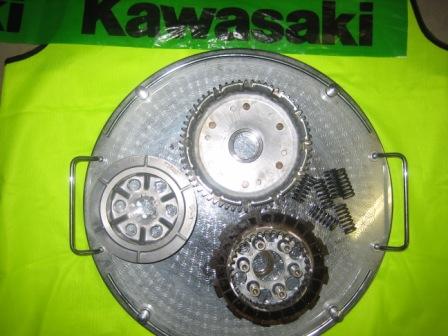

David, I have managed to get the clutch basket apart on my
KT basket case and was wondering what needs to be done to "service" the clutch basket and the steel plates etc... Do you mean to file back the small ridges in the clutch basked left by the plates? What else do I need to do while its apart? I looked through my
TY spares and I dont have any spare clutch springs.....

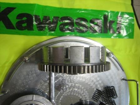

David, I have managed to get the clutch basket apart on myKT basket case and was wondering what needs to be done to "service" the clutch basket and the steel plates etc... Do you mean to file back the small ridges in the clutch basked left by the plates? What else do I need to do while its apart?
Either file down those ridges or take it to someone who knows how to use a milling machine where it could be done very fast and you will get the surfaces nice and square and parallel (much better than filing). I gave up on filing them after I had my first basket machined.
Terry Telfer will probably disagree with making them square but mine work amazingly well.
Another thing to do is to order a set of new friction plates because with old friction plates it will slip more readily after you use less clamping force on the pressure plate. I don't know why friction plates lose friction over time but they do.
Check that all the steel plates are perfectly flat. If there is curvature, the clutch will require too much travel to take advantage of the high ratio hand lever you are probably going to use.
Pull the rack and pinion out and clean them and the casing and have a real good look for anything that might cause friction before you reassemble. Don't do the final rack and pinion assembly until you have fitted the new plates and assembled the clutch onto the gearbox, so you can choose which position on the rack you need to use so that the arm on the pinion is at 90 degrees to the cable as the load goes onto the release bearing. Make sure you have the gasket fitted to the primary cover when you do this.
KTs come with thin wavy springs between the plates which are intended to reduce clutch plate rattle and help the plates to separate but I find it works fine without them.
As well as being flat, the steel plates need to be rough so they don't stick to the friction plates. With new friction plates it is not that important because new friction plates are usually a bit rough anyway, but with older, smooth friction plates it is critical to have rough steel plates.
