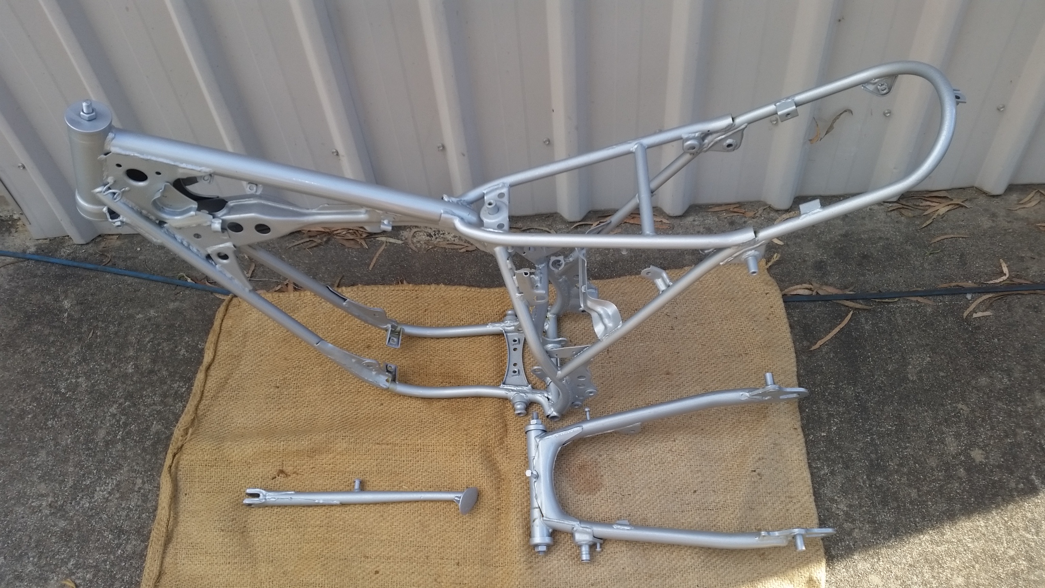

Chippy asked and a couple of other guys may be interested in how I'm going with my s l o w TY rebuild.
It actually started off as 2 bikes bought as spare parts for my perfect patina twinshocker.
I've had the frame blasted and painted locally. Most of the alloy parts are being blasted at the moment. If I like the finish and the company is happy, I'll post their name with the photos when I get them home again.
I've put both heads on my lapping plate, had both barrels rebored and I painted with VHT and baked. Now, I may have used someone else's oven... Karma is a bitch though. As I forgot that the windows were closed. Cooking paint smells awesome haha.
The left side engine cases have both been damaged from the drive chain coming off and all the lovely remodeling that it does. I have had 1 welded and that's where the engine stalled.
I figured if I build a rolling frame, I'll have a reason to build the engine and so on.

- Main frame sandblasted and painted

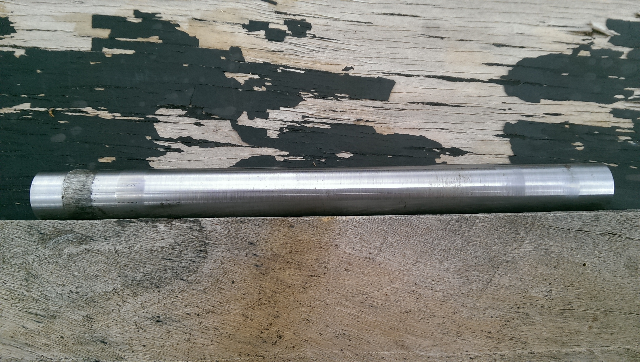

chippy wrote:Hi Everyone,
Phil you are correct. The end of the shaft has been machined down where the spline was. Someone has been at it well before it came into my hands.
Your previous picture:
Chippy
Thanks for the info.
Do you think it is possible to find another shaft with the correct spline and weld it to my shaft (hopefully concentrically).
Any ideas on what other bikes have the same kick start spline as a Cota 123/172 ?

In reply to Phil,
I would be very surprised if a kickstart shaft with the end welded on would last more than 2 kicks.
The weld would create a weak spot in the steel shaft due to the heat imparted by welding effecting the microstructure of the steel.
The steel they use for shafts isn't the garden variety and doesn't take kindly to welding.
Which leaves you with three options:
1. Have a shaft manufactured by a good machine shop.
2. Search for a replacement for sale.
3. Pretend that you haven't noticed the bend and twist in the shaft and see how long it hangs on for.
Hi Kurt
Yes, I realise the issues with a welded shaft.
I’m constantly using option 2, but will probably end up with option 3 unless my luck changes.
I did order a lot of parts from a Spanish supplier including a kick start shaft as they had it advertised on their web site. But they unfortunately couldn’t supply it for some reason
Phil
Phil
