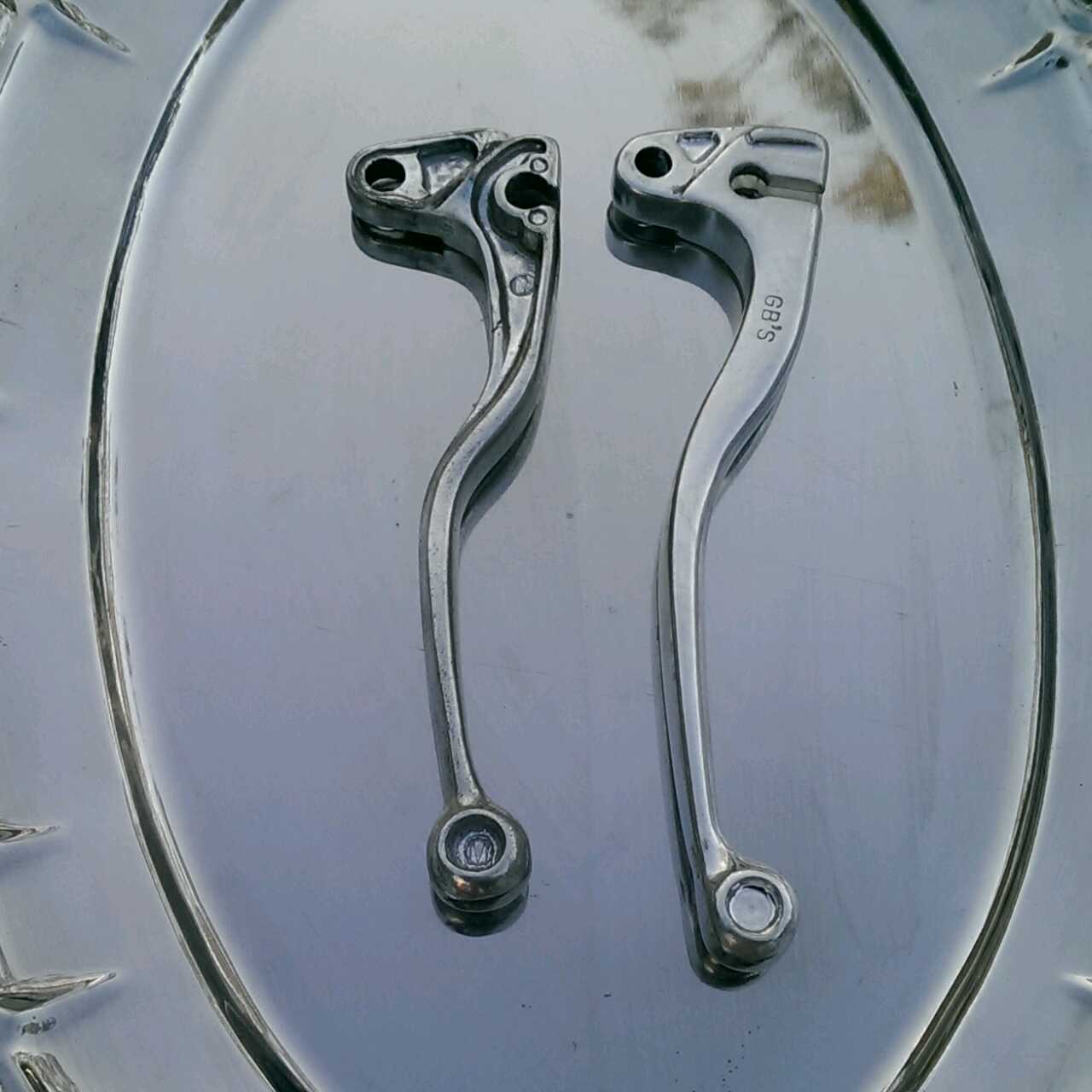

This photo illustrates one the top secret things I'm doing in preparation for the
KT250 clutch pull competition with Greg Harding and Chippy and anyone else silly enough to join us.The clutch lever with GB's on it has the holes 20mm apart and the other one from a
RM80X has the holes 30mm apart.How wonderful it is also to be able to see a reflection of the wonderful western evening sky at Wurdong Heights, by courtesy of a suitable receptacle that appeared in our mail delivery today. Thankyou Chippy.

So David, can I enter my Sherpa in this clutch pull competition? There is a big difference between those two levers. I know which one I`d prefer. That`s why I still stick with the Amals on all of my
s. Much better leverage.
s. Much better leverage.- Greg Harding
