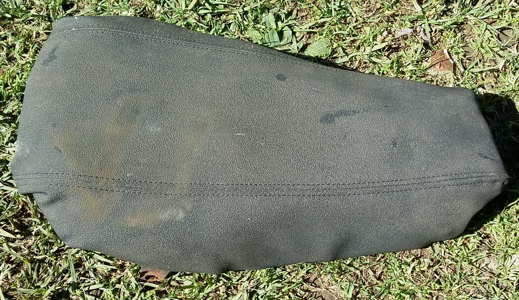

And he also wanted the rear wheel of the TLM (Not sure what it was off?) and in exchange I got a TL 125 seat:
Not perfect but not rusty either:
