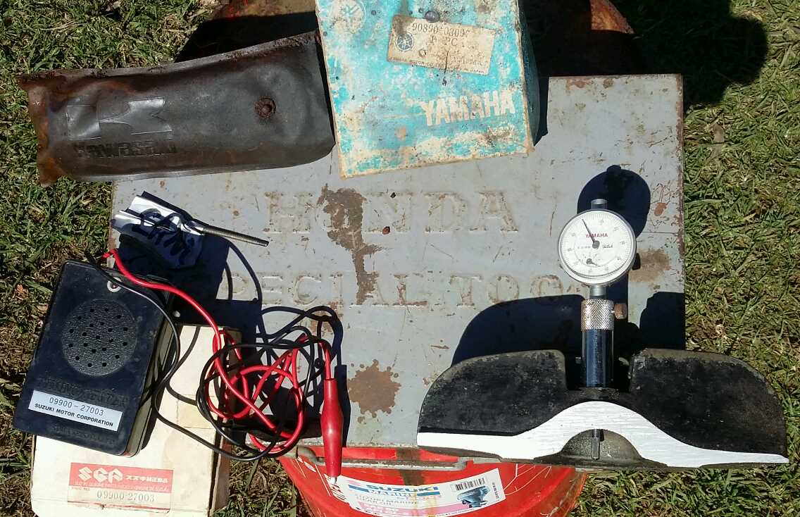

David Lahey wrote:The points are supposed to open just before the piston gets to the top. I use a mark on the rim of the flywheel to indicate when the points should start to open. To decide where to put the mark, you need to make a mark on the flywheel rim for when the piston is at the top. You can use something inserted down through the plug hole for this. Once you have the piston exactly at the top, make a mark on the flywheel rim where it lines up with something on the engine casing, like a screw hole.
Love your work David, here is the :yamaha something to put down the plug hole. Thanks PA, I now have a set.
If you are wondering what came inside the :honda: metal box, M3 x 0.5 camchain adjuster screw with tape on it so I don't loose it. Oh and the :kawasaki pouch contains heavy duty stuff!
