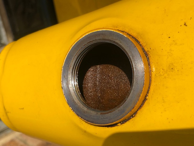

Hi,
I was able to buy my Dad's original TY175 back after he had passed away, the tank outside was still very good.
But inside it was crap. See attached pictures.
I used White vinegar to clean all the rust out. I filled it to the brim, left it for two days, put a short length of dog chain in & shook it round to dislodge the rust.
Emptied the crap out, refilled & left for 3 more days & hey presto.
Just like new.

Well I had another look in the molasses-filled TY250A tank this evening and it is getting pretty close to being finished. I did the Gary B trick today but using 250 large clouts instead of dog chain and it did a good job knocking off more of the remaining scabs of rust. The photo is how it looked after the Gary B treatment. There are still some scabs away from where I could get a photo so it's back full of molasses again. Two weeks so far.
