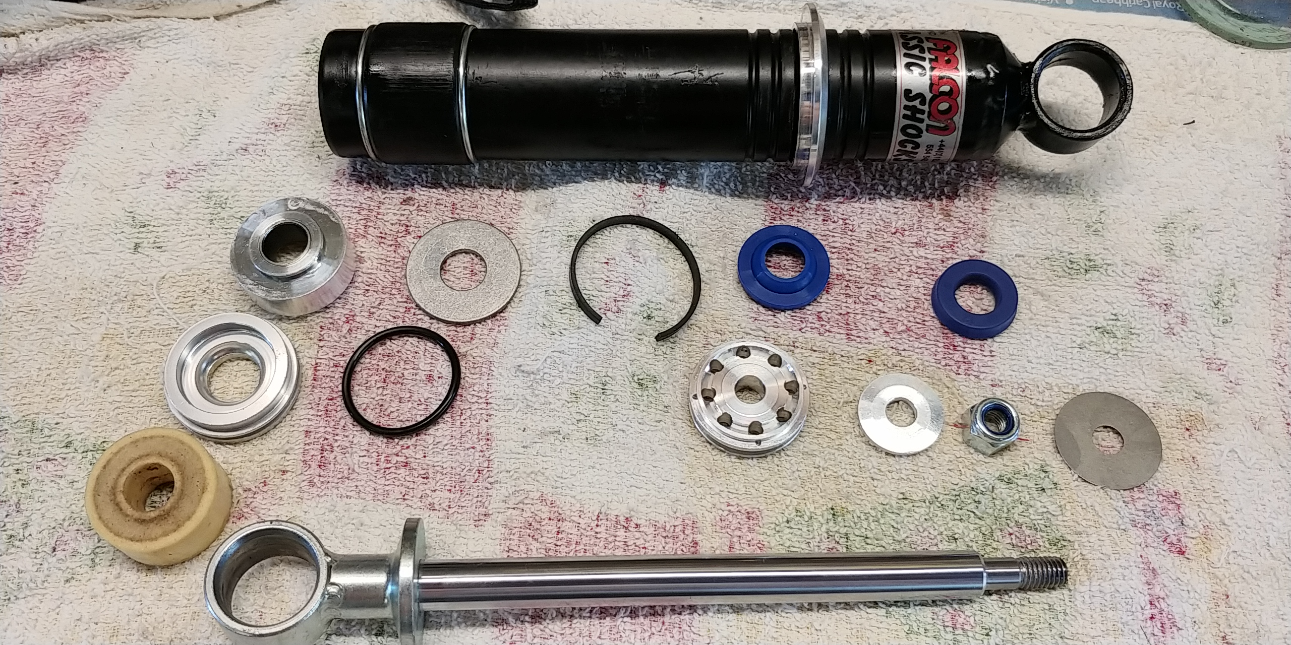

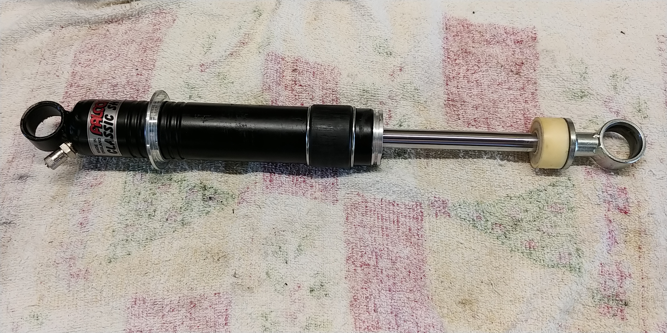

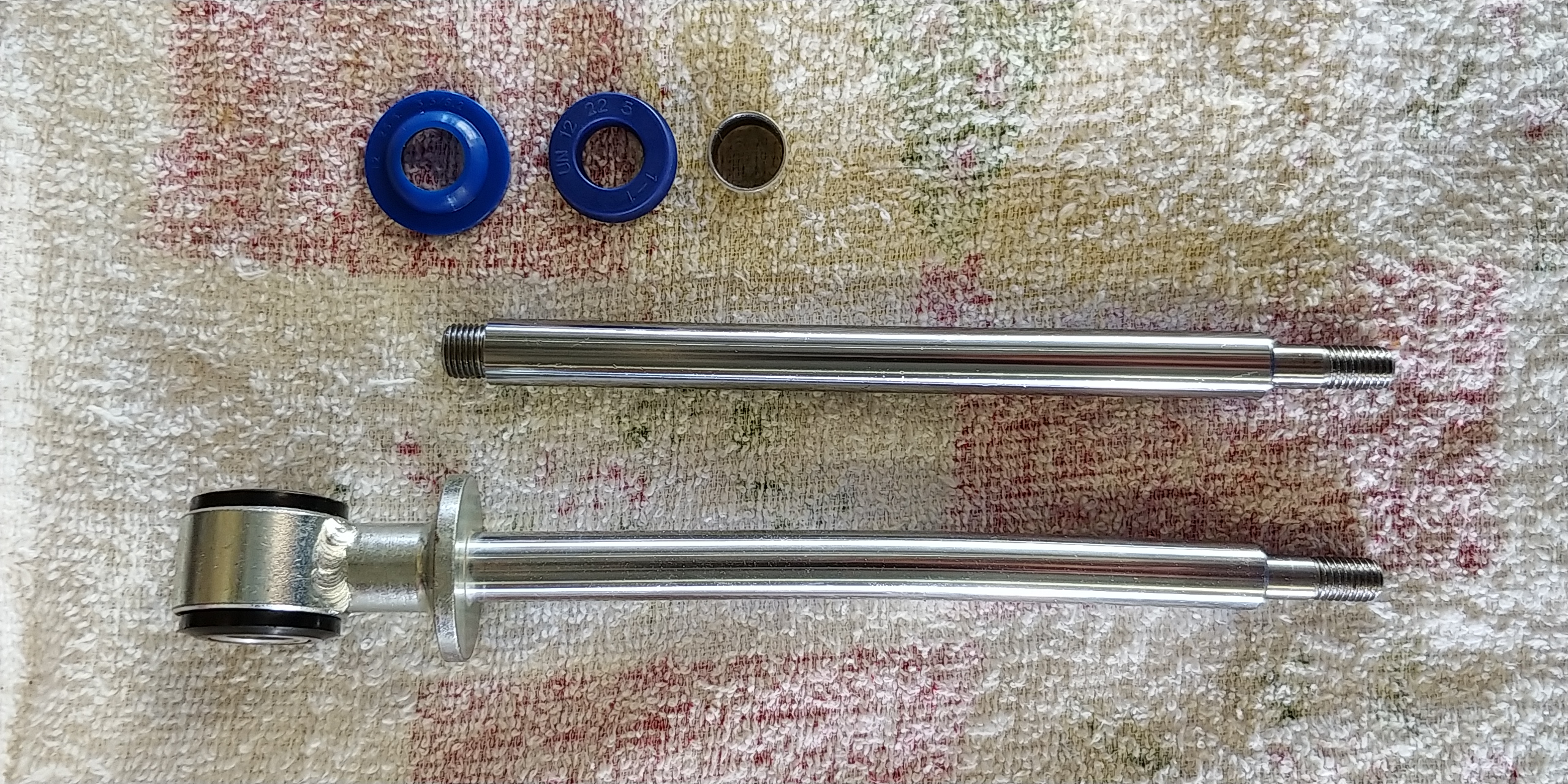

Late last year I had a crash on my Majesty in the final section of a trial up at Seeonee Park. I didn't think much about damage but I did notice that the plastic sidecover would need repainting to look good again and there was some paint missing off the swingarm.
Late January I looked at the bike from behind for some reason and finally noticed that one of the shocks was quite bent.
I then thought OK I'll have a go at straightening it so pulled it apart.
It is a Falcon Classic Trial shock and only about 6 months old so it's got a neat groove in the cover(dust seal holder) so it's really easy to get the cover off now. My oldest Falcons don't have this groove.
Close looking at the shaft revealed a dent, so straightening the shaft was not going to make it a goer. It's made of 12mm chromed rod and a friend has some of this that I could use to make a new one on the lathe but I decided to try and buy a new shaft.
Well buying the shaft turned out to be very easy from the same place I bought the shocks and they said to replace the oil seal, dust seal and the guide bush at the same time and bingo a week or so later it all arrived in the mail.
For someone who only owns old motorbikes, it's great for a change to be able to buy newly-made genuine replacement parts.

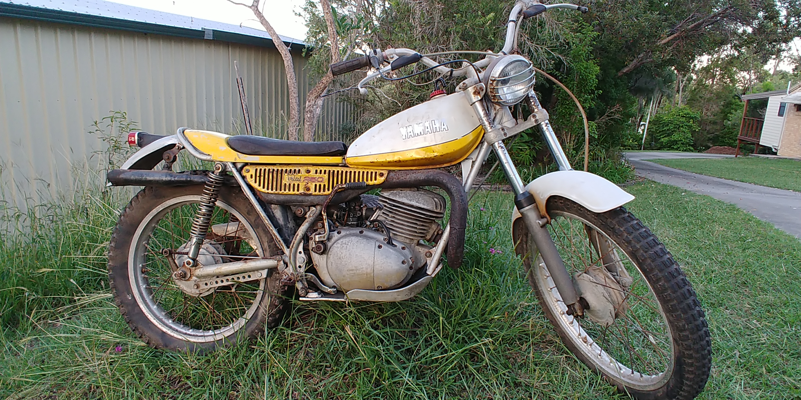

The :yamaha TY250A fuel tank de-rusting is complete now and the tank has been protected internally by coating it with WD40 and then drying it out using an electric frying pan.
I then put the tank back on the bike for some photos for a local Historical MCC show. It was going to be a normal bike show but due to corona it's now a going to be virtual bike show.
In case you were thinking wow that's a fairly ratty-looking bike for a motorbike show, there was a category for Barn Finds and this bike sure fits that bill. It has amazing patina.

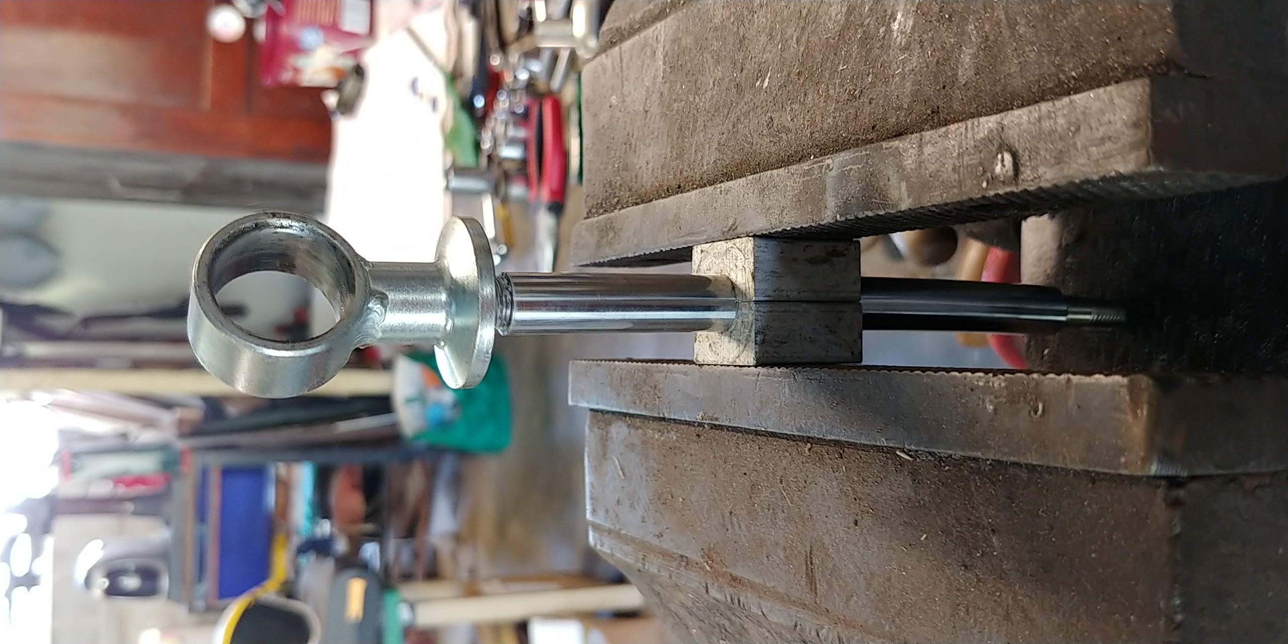

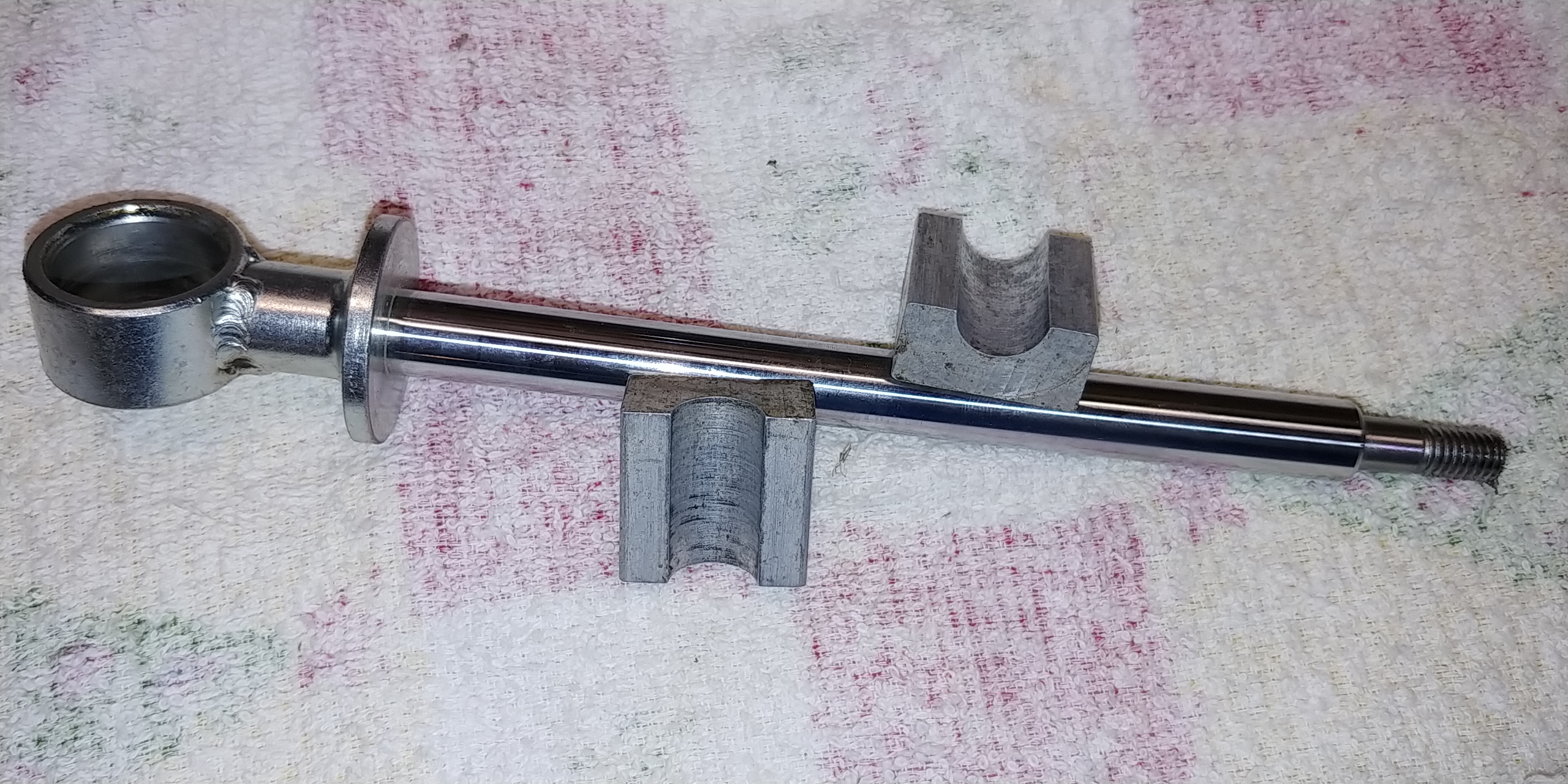

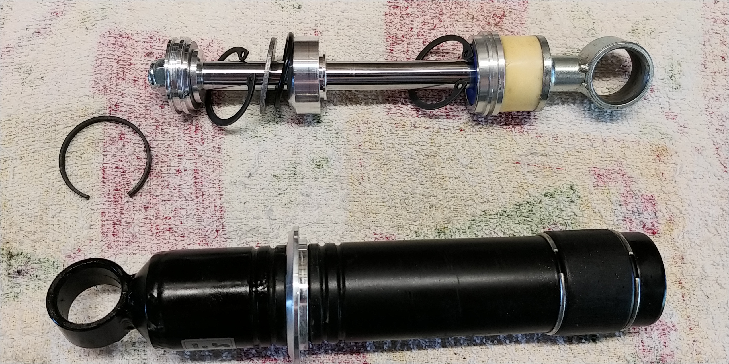

I finally got back to the shock with the bent shaft this afternoon and dug out the shock shaft clamp that I remembered was in the shed somewhere.
Those aluminium clamp blocks are something I bought for working on my KONI shocks in 1976. From memory KONIs have a shaft that is an odd size. I'll soon find out how well they fit the 12mm shafts.
I'll probably need to warm up the mounting eye on this to free it up because the thread will have been loctited. Wouldn't want that coming loose while you were riding.
Re: Extra home workshop time

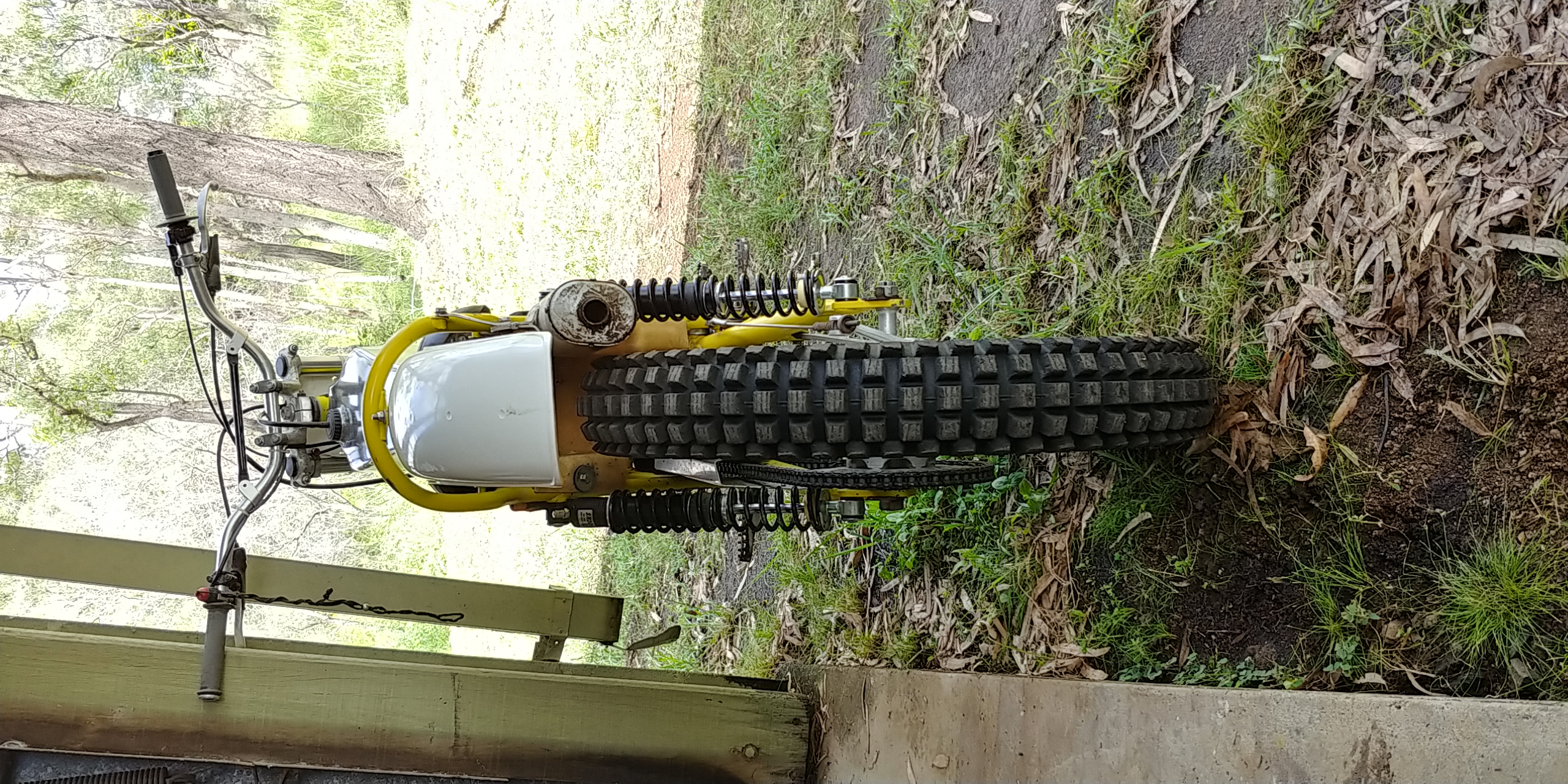

Two nice straight shocks again ready for a test ride when the day cools off.
Yes the end fitting did need to be heated up to soften the loctite.
