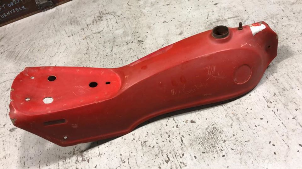

I have a 172 tank for sale if anyone is interested. $50
It is posted on the Facebook Page Trials Bike Parts for Sale Australia as well.
Can post.

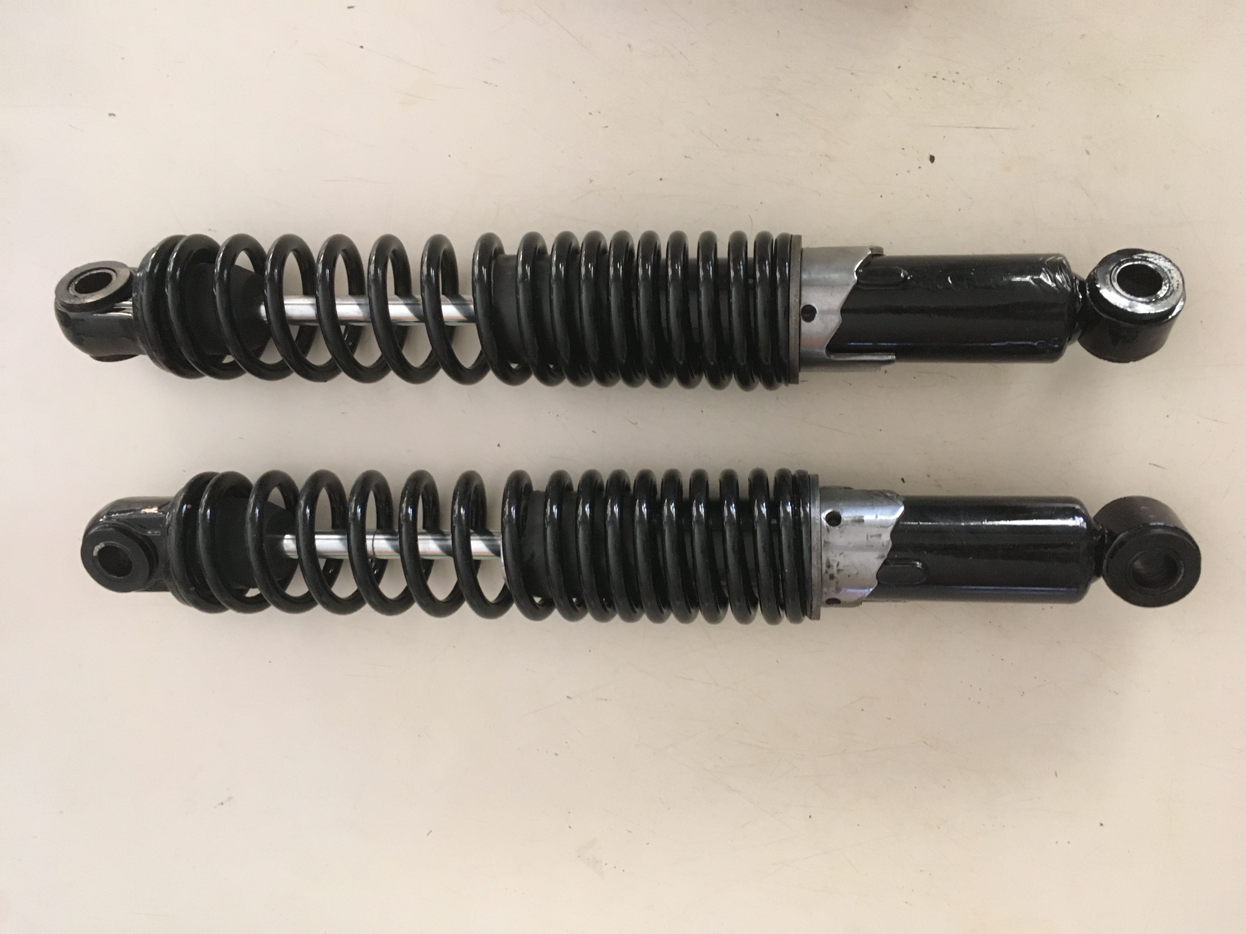

Received my Telesco shocks today.
Certainly in a lot better condition than when I sent them away.
