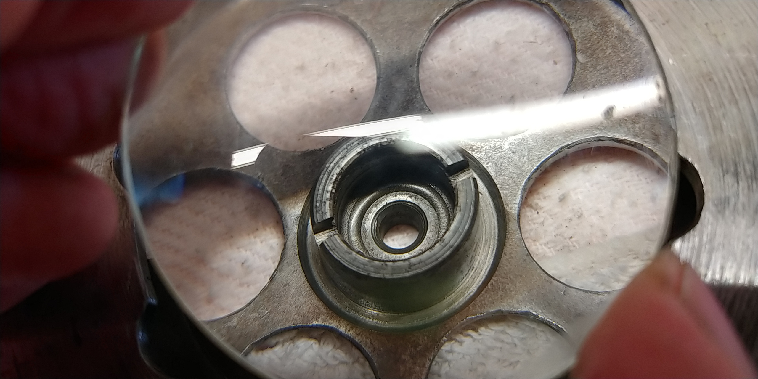

I got back to working on the M49 this morning and reckon I found why the clutch pushrod was being spun strongly enough to cause the damage shown in the earlier posting.
Today I pulled apart the thrust button thing in the pressure plate. This is what transfers the axial force from the pushrod to the pressure plate. On later model Bultacos, there is a radial needle roller bearing there. On this early 5 speed motor, there is a tiny ball race with loose balls, like a miniature version of steering head bearings.
When I looked with a magnifying glass I could see that the inner race had been rubbing against the outer race, due to wear of the races and the balls. The places where they were rubbing together are shown in the photos. This rubbing would be why the pushrod was being spun around so strongly.
Luckily I had a few other old style pressure plates and found one that had a thrust bearing that was not worn much, cleaned it out and reassembled the clutch.
