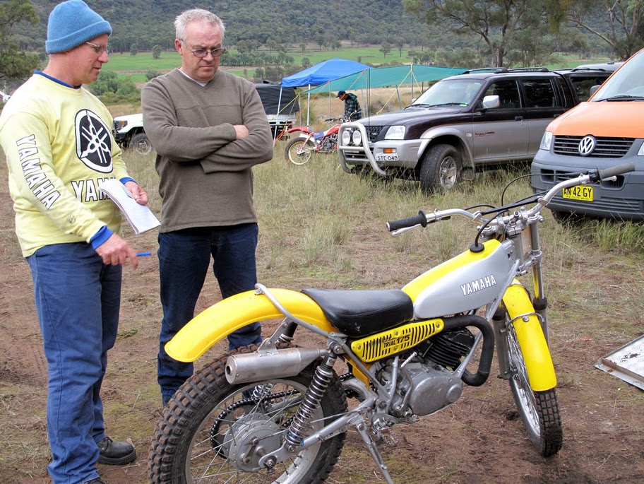

I'm always interested in modified twinshock trials bikes and while looking through old photos, came across these photos I took in 2006 of an interesting bike. Photo taken at a Denman MCC trial at Martindale, NSW.

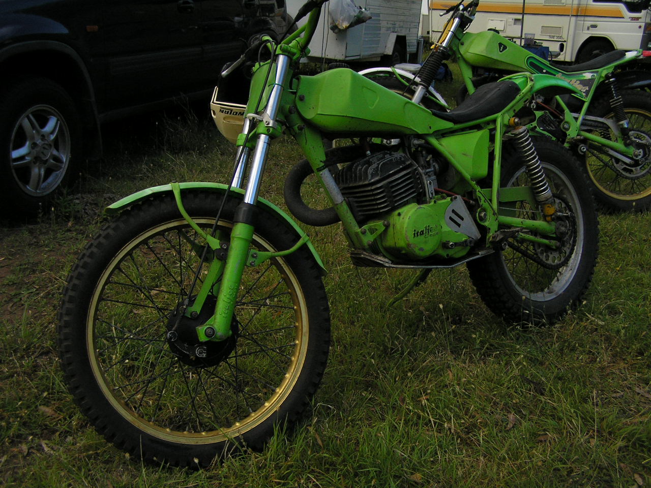

Here's another interesting Australian twinshock creation
- P1010120.JPG (840.97 KiB) Viewed 2449 times
Honda TLR 250 and TLR 200 Comparison

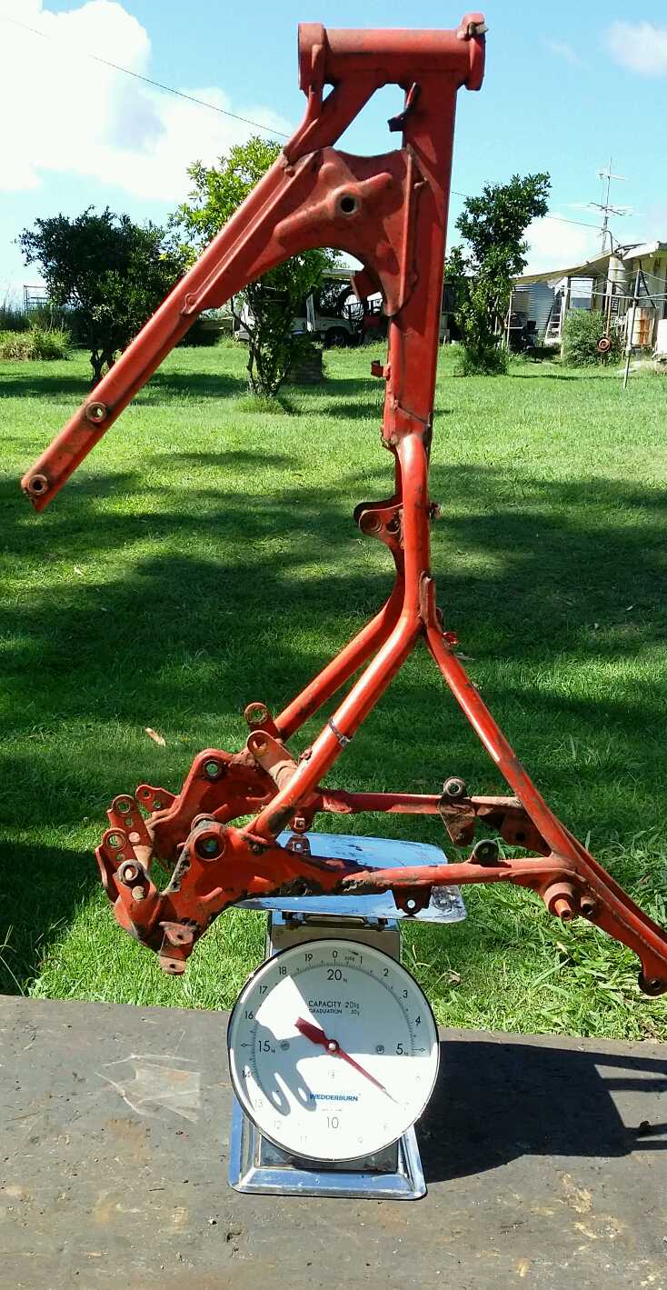

Thank you John, whereabouts did you get those specs as all I could find as a google search was an old post on here of yours from 2014 stating the same thing for
TLR 250 but not a comparison with
TLR 200.
Obviously the wheelbase is variable, what do they use, maybe Centre of axle slots?
Ground clearance variation of 10 mm makes sense with my personal data because TLR 200 damper rods are 10 mm shorter than TLR 250. Coupling that with TLR 200 shocks being 10 mm shorter between centres than TLR 250 even though they are not true lengths because of forks and shocks are mounted on an angle, so I think close enough? Not knowing the ride height that they are working with is a bit like the wheelbase that is adjustable!
Seat height makes sense because TLR 200 has a padded seat.
Footpeg height makes sense as TLR 250 has very high footrests in standard trim and footrests do not interchange between models!
Rake Simply Does NOT make sense because my frame jig for reworking the steering angle on the BLOODY
fits my TLR 200 frame which proves the steering head angle is exactly the same!
Maybe
hype comes into the equation as I cannot see how the slightly shorter forks and shocks can change the steering angle, (same ammount both ends)!
Trail Does Not Make Sense as well, yes I realize Rake is different to Trail but it can't be different on both models for the same reasons I have just stated about Rake! Pretty sure the Triple clamps measure the same ammount of offset!

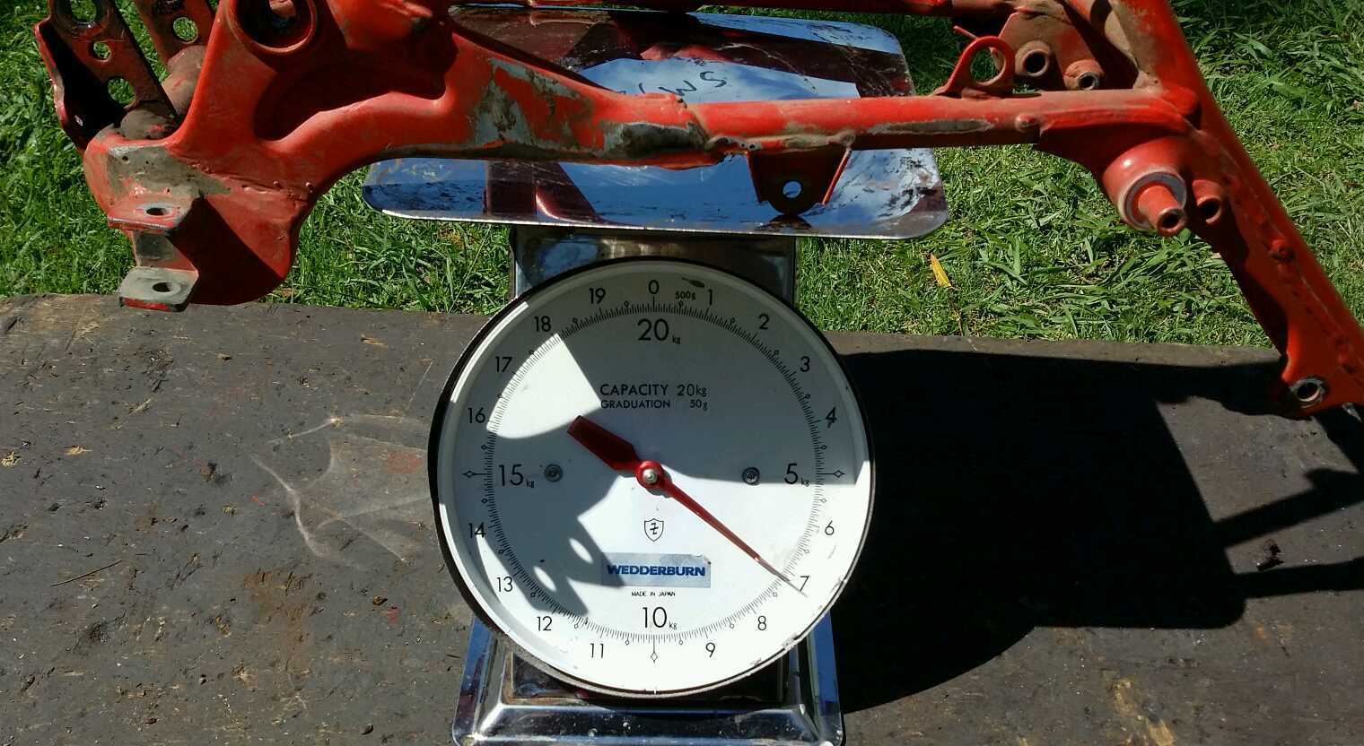

Both of my TLRs now have the same frame geometry modifications along with a couple of others that I have done, both of the others were TLR 250s, my TLR 200 is the first one that I have done. When you look at both bare frames side by side. The TLR 200 has extra brackets for repositioning the gear lever, a cup shape bracket in front of the top steering head bearing may be for steering lock and another bracket behind righthand side cover rear mount maybe for battery box? As yet I have not had a good look at a Reflex but I think the frame is very similar to the 1983/4 TLR 200s?
TLR 200 frame is slightly heavier than TLR 250, I assume because of the extra brackets.
David, custom bikes are the ones I find the most interesting, the YamJet in your last photo is nice to ride! Never know what's next but i would jump at the chance to ride the TY 175 powered
Piuma!

Greg, I got them from Honda manuals uploaded to the web somewhere. Can't remember what site now. Thought it might have been the honda onlytrial site but a quick check now didn't show them.
I'v always assumed wheelbase to be as delivered from the factory, ie with standard gearing and chain tension adjusted to factory specs. Which means of course; change sprockets, change wheelbase specs and I'd guess they're different for the 200 & 250.
I have long wondered about the diff rake/trail specs too since they're often said to be the "same frame". Perhaps the 200's specs listed are for the Reflex model. (Interestingly they are the same as for the TL250 too.) As we know the Reflex model had different forks & triples.
I've just checked part nos from the cmsnl site and TLR200 & 250 have same triples as you thought.
Frame nos are different but that could be just the extra brackets for the 200.
Swingarm nos are also different but that may just be to suit the diff hubs & brake plates.
Fork sliders (bottoms) are diff nos too which again may be to suit the diff hubs and brake plates which are also diff nos, but it might be worth checking the offset in the sliders Greg
