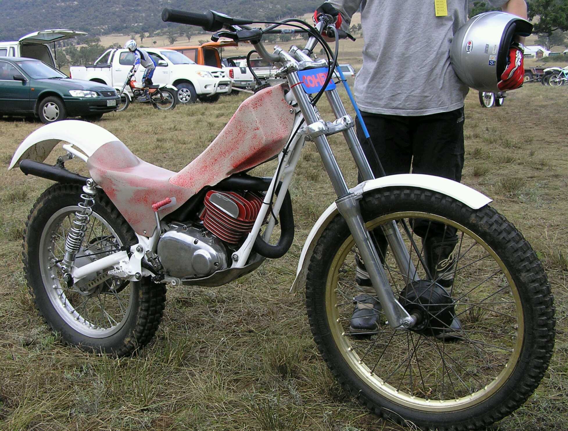

David Lahey wrote:I found another photo of that modified :yamaha TY175/ :Honda: TLR200 that shows the amazing workmanship
David, it might be a :Honda: TLR 200 front wheel but I think it is a :Honda: TLM 50 front wheel. They are the same with the same puny hub and brake, the reason why I think it is a TLM 50 front wheel is because they run 30 mm forks and they most likely came off the same bike? The bike looks like it is set up for someone that is small, maybe a junior rider and it would be a lazy steerer which might be good for someone learning?

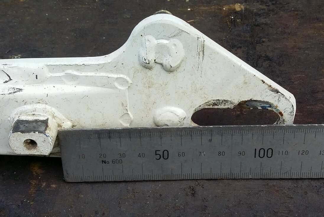

Swingarm nos are also different but that may just be to suit the diff hubs & brake plates. TLR 200 has puny 12 mm axles and brake stay is 20 mm further back than the TLR 250 one here:
Fork sliders (bottoms) are diff nos too which again may be to suit the diff hubs and brake plates which are also diff nos, but it might be worth checking the offset in the sliders Greg Pretty sure they are the same as mine has 250 on one side and 200 on the other. Having said that, I think either 200 or 250 forks will accept TLR 250 wheels or puny wheels!

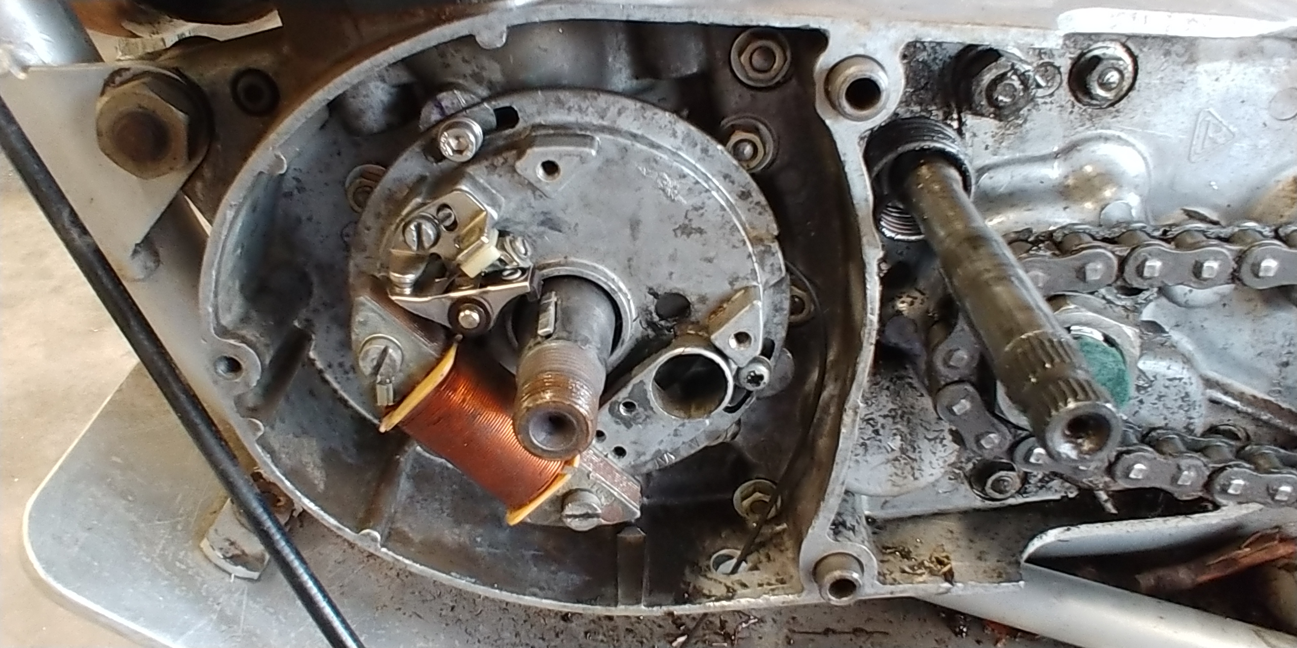

Bultaco ignition

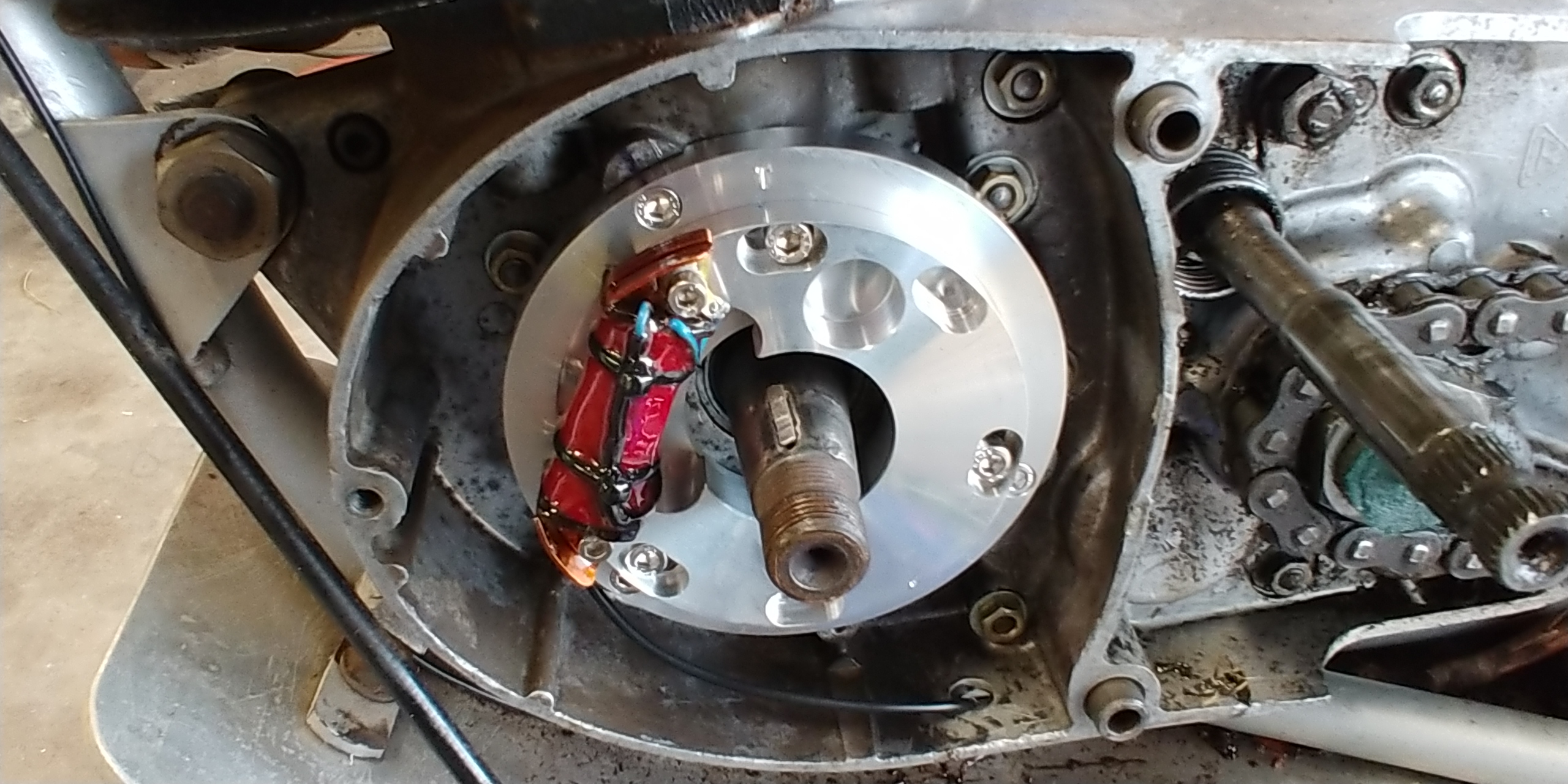

This afternoon's project. It goes well
Very good move David. Even though I really like timing a Bultaco I also love not having to time my M199B as it has an In Motion ignition on it. The auto advance curve is also brilliant. You can have a really smooth bottom end with a screaming top end. I`m assuming that is your M49? :Bultaco: :Bultaco: :Bultaco:
To answer your question David. Is it because Trials riders leave their entries until the last possible moment so they also don`t post anything unless they absolutely have too! :roll: :roll: :roll:
Bully fanatic wrote:Very good move David. Even though I really like timing a Bultaco I also love not having to time my M199B as it has an In Motion ignition on it. The auto advance curve is also brilliant. You can have a really smooth bottom end with a screaming top end. I`m assuming that is your M49? :Bultaco: :Bultaco: :Bultaco:
Yes it is Graham and I'm really impressed with the M49 :Bultaco: motor performance with the In Motion ignition. It is the same performance at low RPM as it was with points but in the mid range and upper revs the thing now goes like a rocket.
