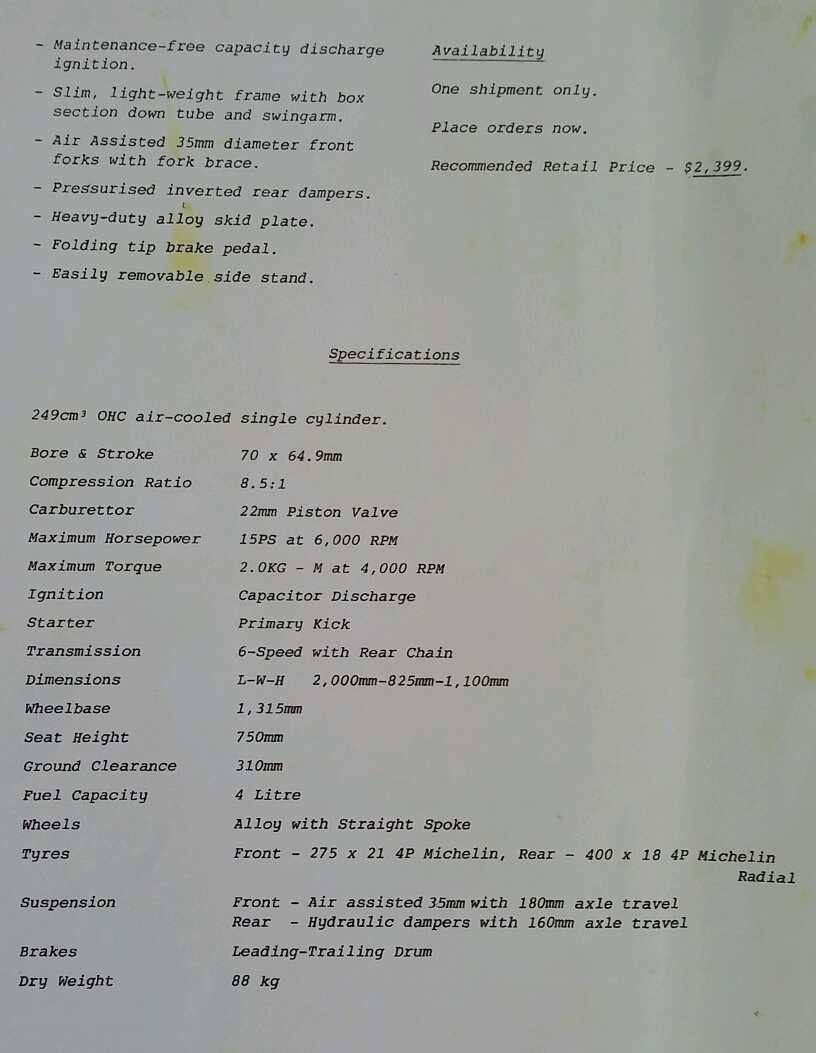

The difference between the TLR models is in the primary drive with the 250 being a lower ratio.
Apparently the 250 has a different 6th gear as the bigger cylinder gets in the way, I have never had either apart.
The wheels and hubs are different, the clutch actuation arm is shorter on a TLR 200 and anyone can feel free to add to the list........
Has anyone got similar brochures for TLR 200? There is an old story that :honda: Australia bought 1 bike in but never pursued it until the 250 came out, I have always been curious about how many :honda: TLR 250s were sold in Australia?
Might it be 80?

:honda: TLR250 = 88 kg (measured at the brochure) :roll:
