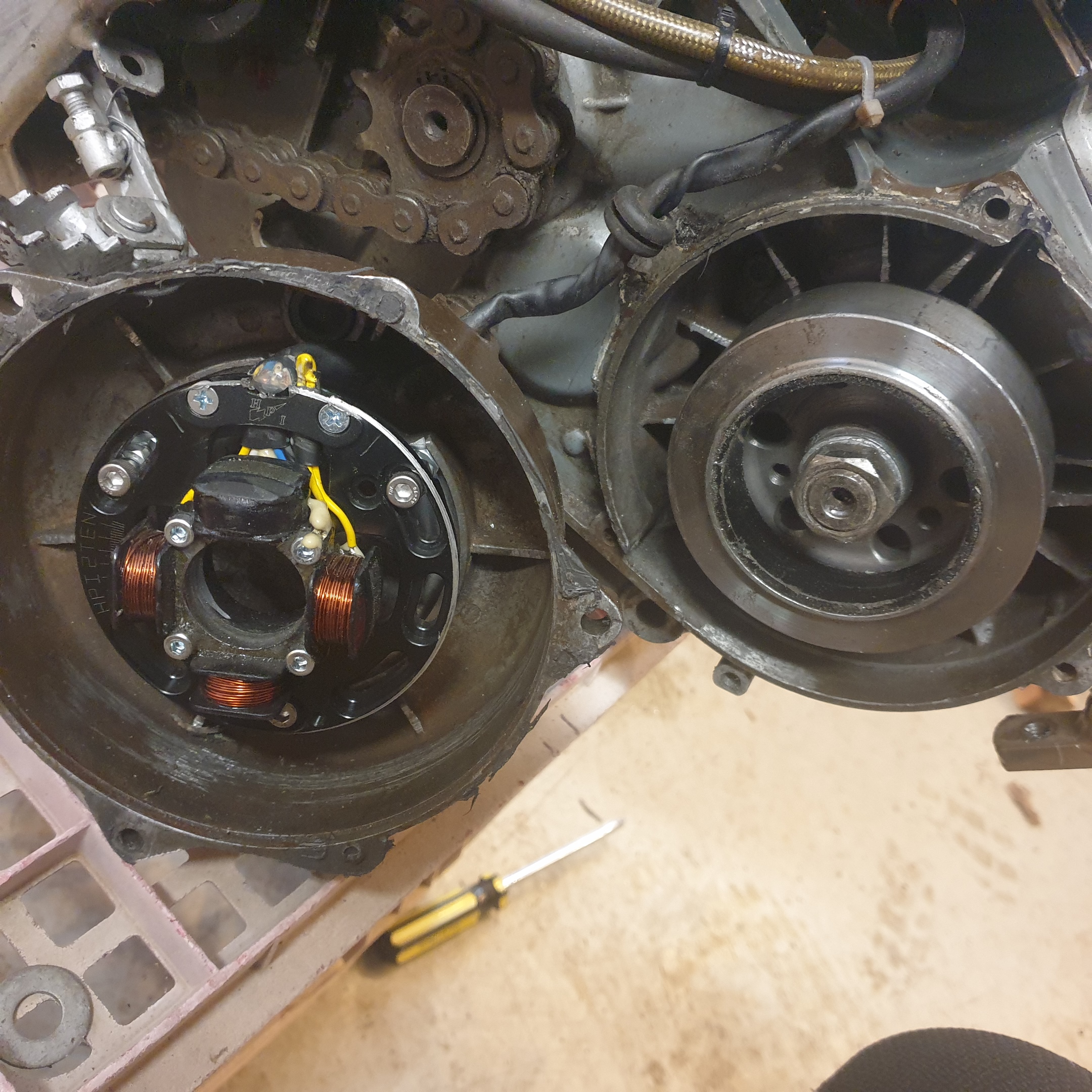

The stator is mounted on the cover not the motor, there does appear to be some spacing issues which affect how close stator sits near flywheel. This issue is not mentioned in the manual - nothing that should stop it starting but will need to be sorted. The previous owner appears to have tried to fix with stacks of nuts as packers.

Can you post up what info you have on the ignition and maybe a photo of what your flywheel setup looks like.
Some brands of aftermarket ignition that do away with the key require you to get it close enough to the right timing so that it runs then use a strobe to get it right. Alternatively you can spin the motor with a drill with the plug out to get the strobe readings.

Post by Mudnut »
The ignition is from a Belgium based company Horse Power Ignition. It's the 210 model. I refitted the flywheel again today and managed to get it to fire briefly - very briefly. It is close but just not close enough. The stator lines up ok with indicator marks on the cover ok. The flywheel is still a bit of guess work. I've attached a photo of the setup.
