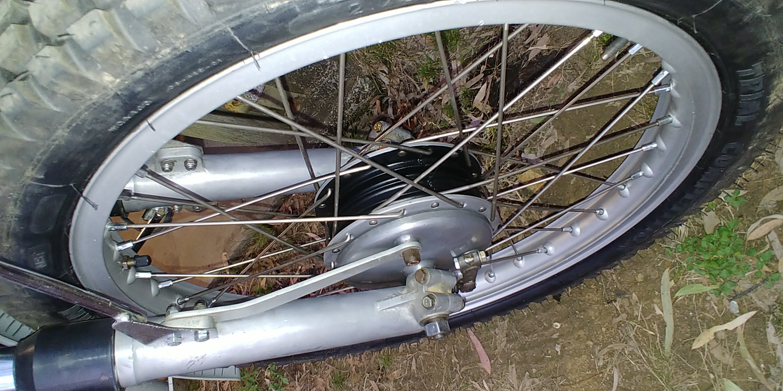

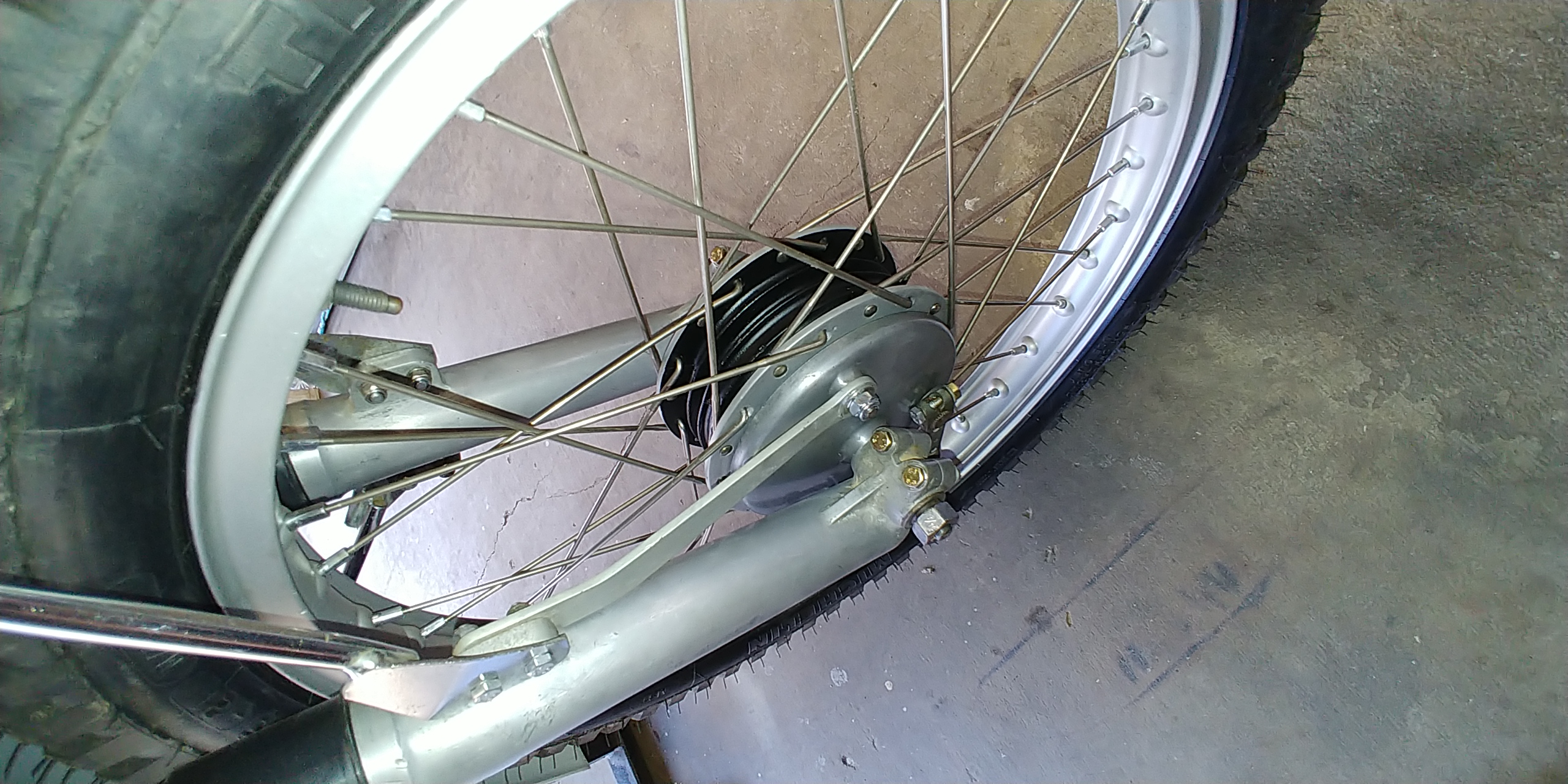

Bultaco wheel rebuild continued
I finally got back to rebuilding a front wheel for my model 49
and it's now on the bike and ready to ride.
These are the before photos:
The newly done front wheel is the one with the machined brake drum, modern brake lining material machined to exactly fit the drum, new wheel bearings, new spokes, vapour blasted rim, vapour blasted and painted hub and a nice new Michelin tyre.
The front end of this bike also recently enjoyed a rebuild of the forks with green SKF seals, Magical springs, correct-looking dust scrapers and a new guard and guard mount.
and it's now on the bike and ready to ride.These are the before photos:

You could of at least put a new nut on the torque arm where it bolts to the backing plate David. Or replated the old one. Looks good though!
Bully fanatic wrote:You could of at least put a new nut on the torque arm where it bolts to the backing plate David. Or replated the old one. Looks good though! :Bultaco: :Bultaco: :Bultaco:![]()
Howzat Graham? That nut was bothering me too. I was procrastinating about using a more modern-looking nyloc nut, which is not as deep as the 1960s nyloc nut. You tipped the balance in the decision.
After that, the mismatched axle clamp bolts really stood out, so they got the flick as well.

That looks much nicer David. My CDO isn`t playing up now! I don`t have OCD, I have CDO which is in alphabetical order as it should be!
