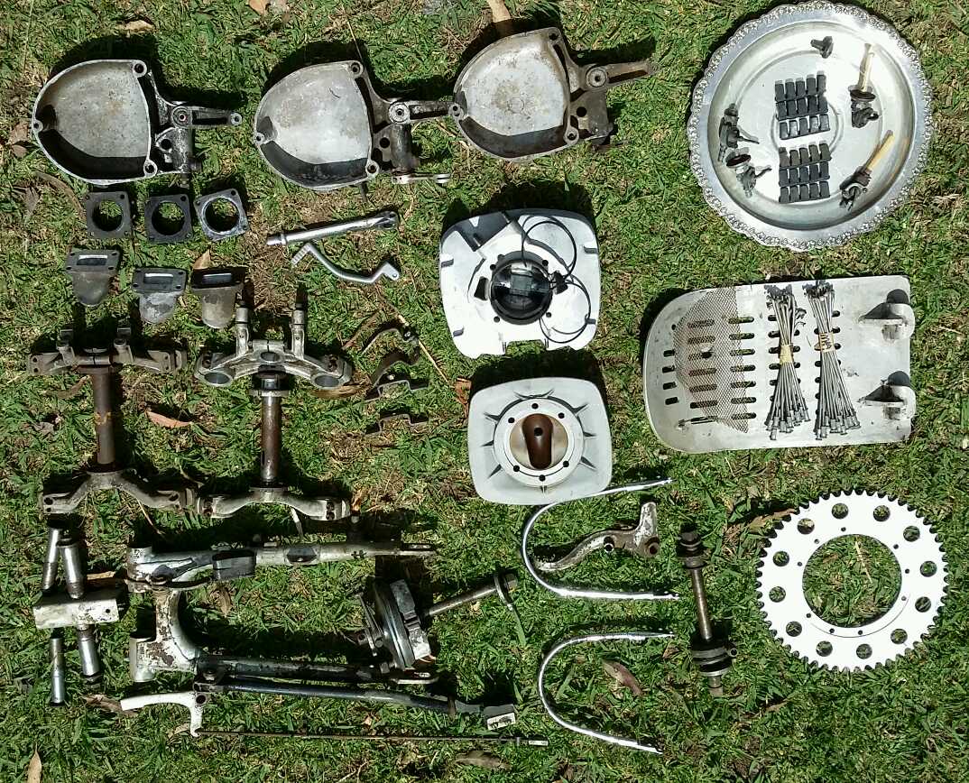

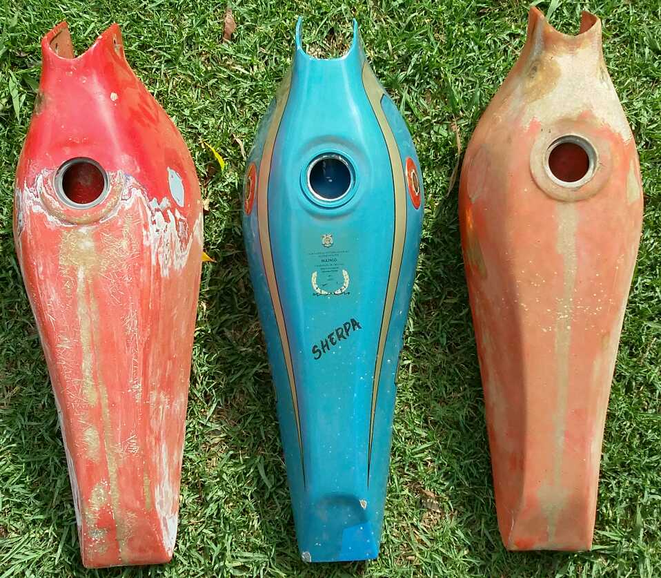

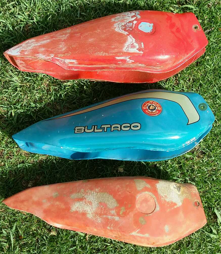

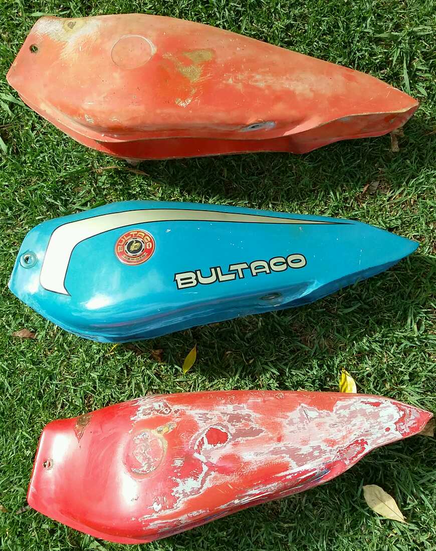

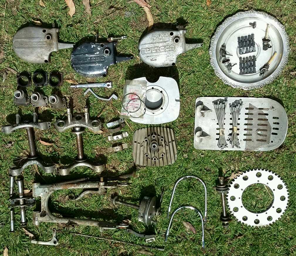

Just sharing photos of some more
parts, kind of gives you a warm and fuzzy feeling in your gumboots hey Graham
So I have been back to the
Emporium and it still amazes me:
325 Cylinder rebored with new piston and rings! Can someone please identify the 2 different triple clamps and which model/s they suit?
Tanks in advance.

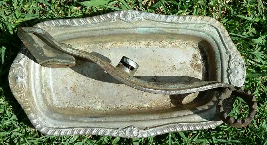

So I saved the best bit for last, finally a brake pedal for the correct right side:
Left normal clamps 124/125 onwards, right 158/182/190 clamps for the short forks I think
Early 325 barrel and head
You must have won the lottery buying all these parts

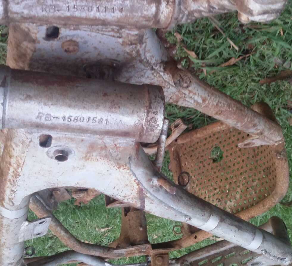

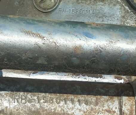

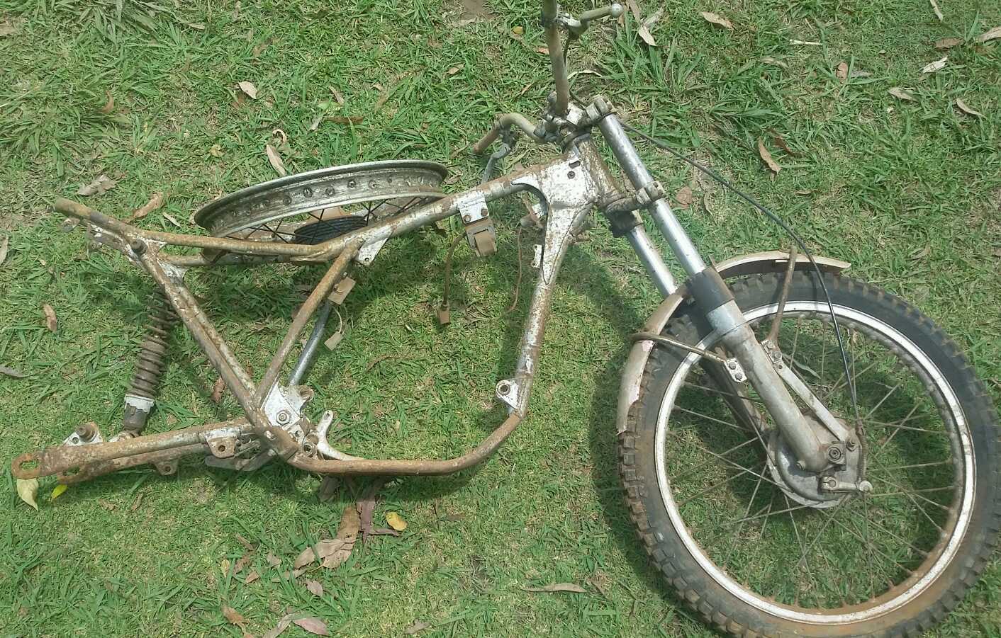

Matching numbers Bultaco frame found!
Just sharing that we found the matching (sort of rolling) 158 frame under the house at the
Emporium.
Ross, I see now what you mean about shorter frame, forks and swingarms, a
158 is more
TY 175 size and dare I say it, like a
172.
Also I can narrow the round hole to elongated hole change to somewhere between 158 01114 and 158 01581

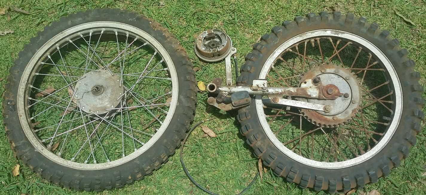

AND I picked these M99 wheels to order:
No lottery win Ross but I am very happy with purchases and I hope I am not the only one picking up parts in these unprecedented times?

The 159 and 158 swingarms have different part numbers probably shorter on the 250’s to make up,with the shorter frame and forks, the 1 inch shorter wheelbase
With over 3 times as many 158’s produced than 159’s which seems odd to me but they were brought out around when those nasty ty175’s arrived and sections turned into mostly tight turns, anyway maybe they changed the bashplate Some where in the middle of production, all the 158-159’s I’ve seen haven’t had the slotted plate.

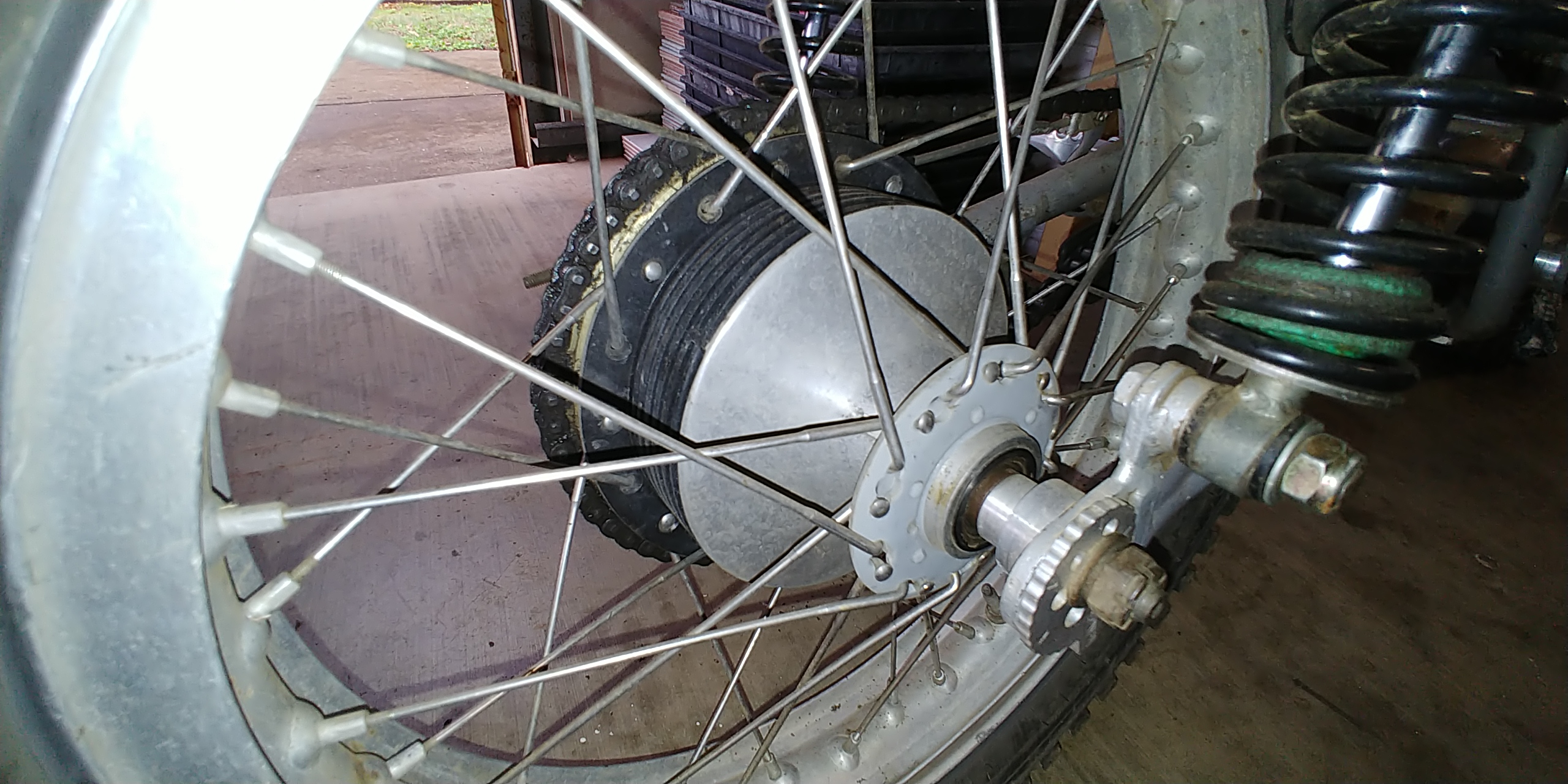

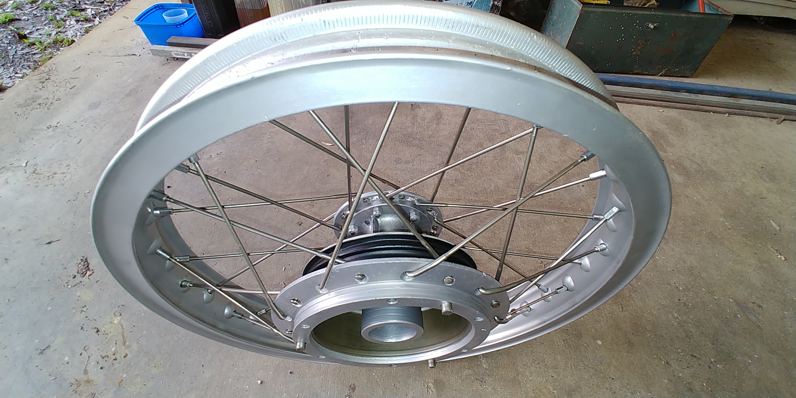

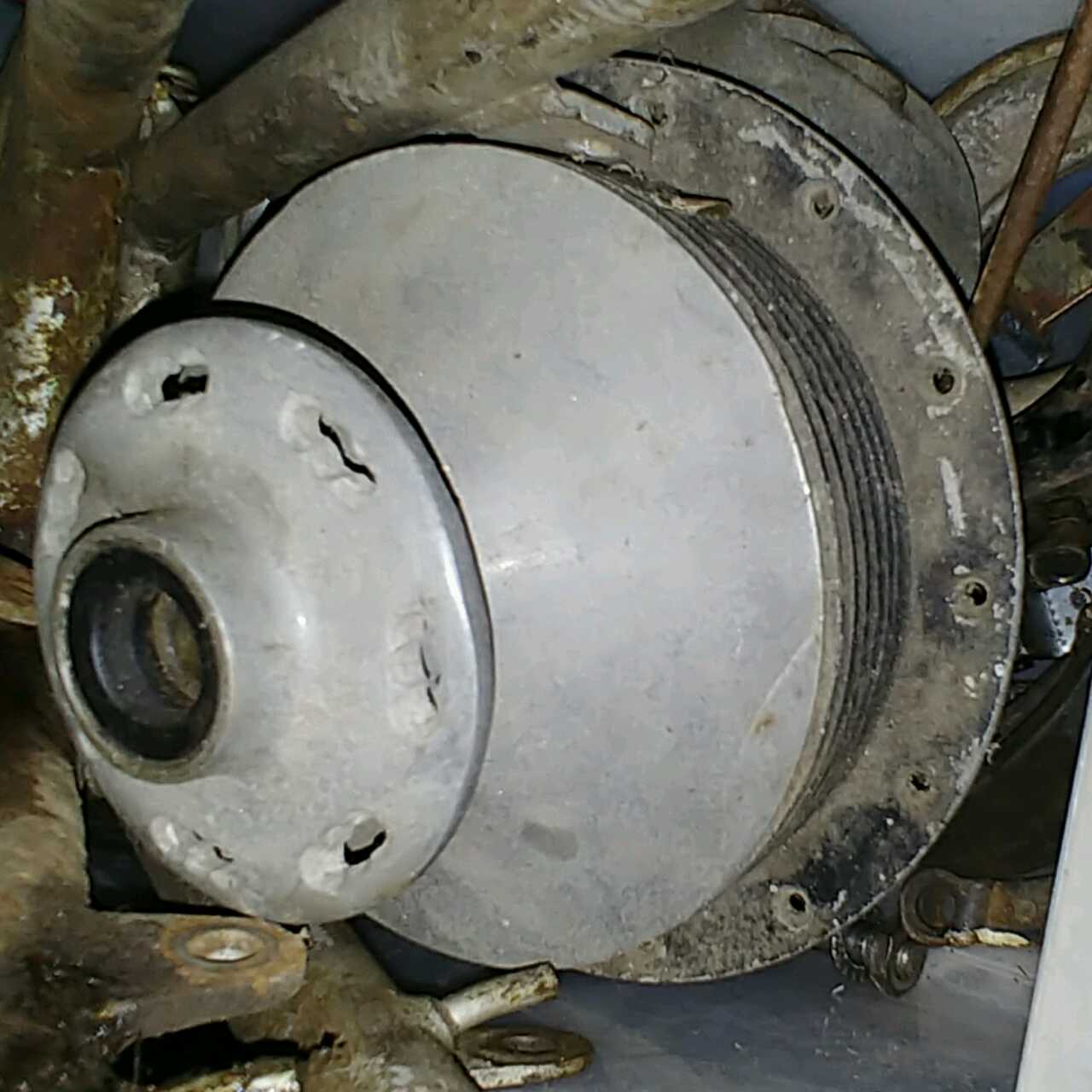

Greg there were quite a few different
rear hubs in the late 60s to mid 1970s.
I went looking and found one of those "all aluminium" hubs you had spoken about but it came without a motorbike attached so I don't know what it is from. Looks nice though. Here is the "all alloy" hub I found tonight:
and here is the back wheel from my 1968
Sherpa T model 49. I think it is the same as was fitted to the model 10
and model 27
Sherpa Ts. The little spoke flange is riveted on.
And here is the hub that followed and was fitted to late model 49
, model 80
and model 85
and probably lots of other
. This one is going on my model 85

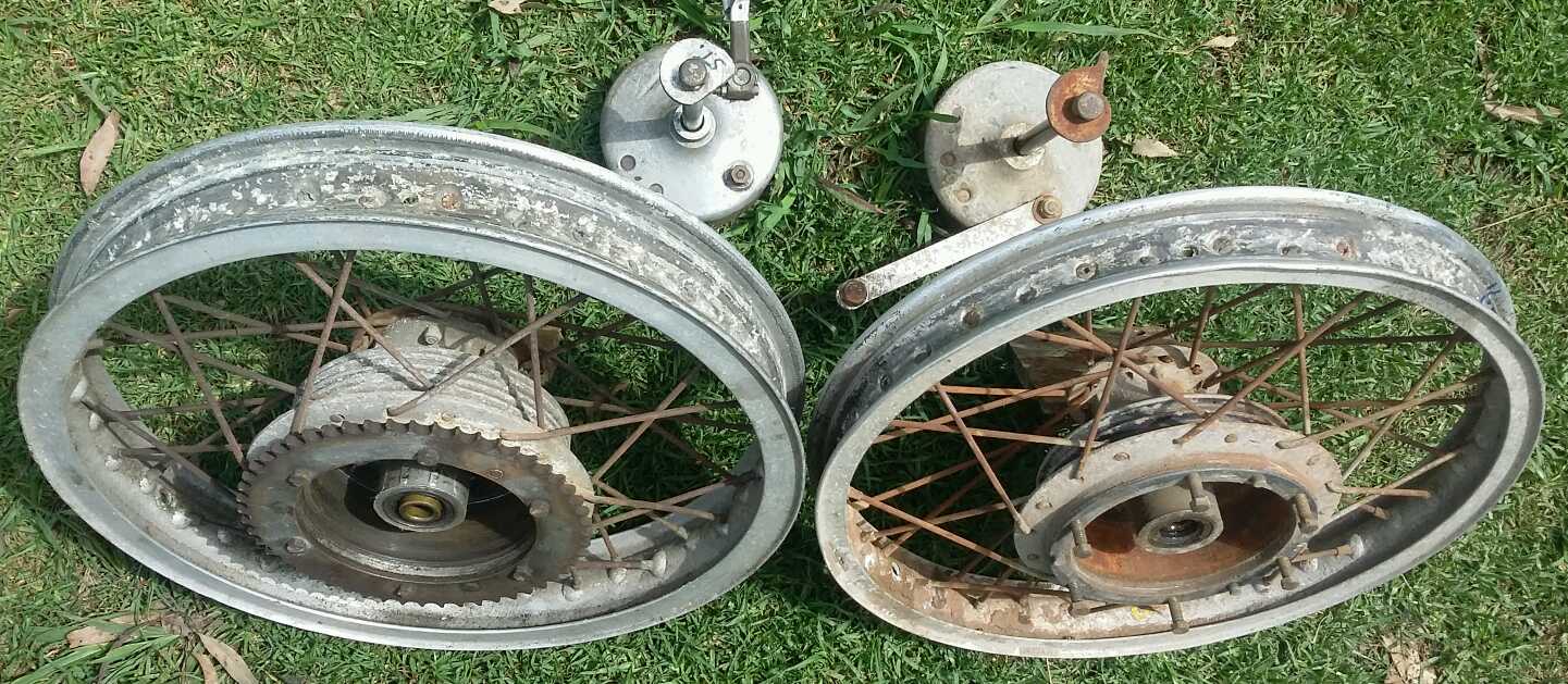

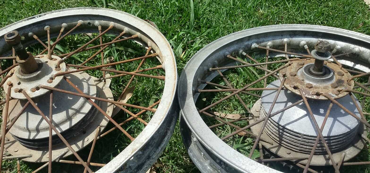

David, I know you said no motorbike attached but something tells me that the bike you are imagining is nothing like the reality, I will let you think about it. Here is some photos of
M49 rear wheel and what I think is
M99 but not sure, warning that might be backwards?:
The sprocket mounts and brake assembly are the same.
However the springs and shoes are different.
The axles and brake plates interchange but the spacers are different.
So here is my theory about the steel spoke mount on small side of hub, I think they were worried about the spokes pulling out of the hub. Also I am pretty sure that the 2 holes is where speedo drive goes?
