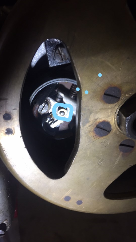

Hi I need to attach a Magnetic killswitch to my James for this weekends Pre 65 trials event. Can I attach the power wire from the killswitch to this wire circled in the photo of the points and then the negetive to the frame?

Can't see well enough in the photo Barry.
One kill switch wire connects to the wire that goes up to the HT coil.
The other kill switch wire is connected to a good earth.
The easiest location for the kill switch connections to be made is usually at the HT coil.

Re: Killswitch for a James
thanks mate i was trying to get around it by not taking the flywheel off.
David,
This is a Villiers engine and all the HT stuff is behind the flywheel not up on the frame. A HT lead comes out from behind the flywheel straight to the spark plug.
My Villiers engine has been converted with the HT coil on the frame.
Barry,
I think you should identify which side of the points is the earth side. Attach the Kill Switch wire to the electrical connection on the live side of the points. The wire should be able to be routed in behind the flywheel from behind - maybe beside the HT lead to the spark plug. It would be a fiddly job working inside the flywheel, but I think you should be able to do it. The other kill switch wire just needs to be earthed as David said.
Barry,
thanks, Terry that was the reply I was hoping for. I will be starting work on this tomorrow then onto wheel building the day after. will ask for help if ok? thanks

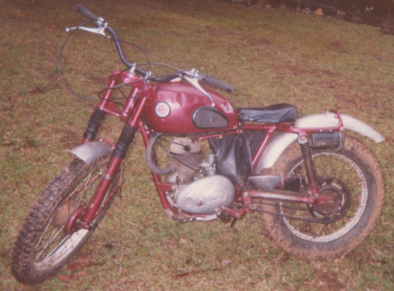

Hi TerrY.
Better catch up this year, somewhere.
30 odd years since I built that James. Did i put alloy rims on it ? Got a feeling I did from my pic.
I cut the Tank badge stencil from a piece of cardboard and Stanley knife.
