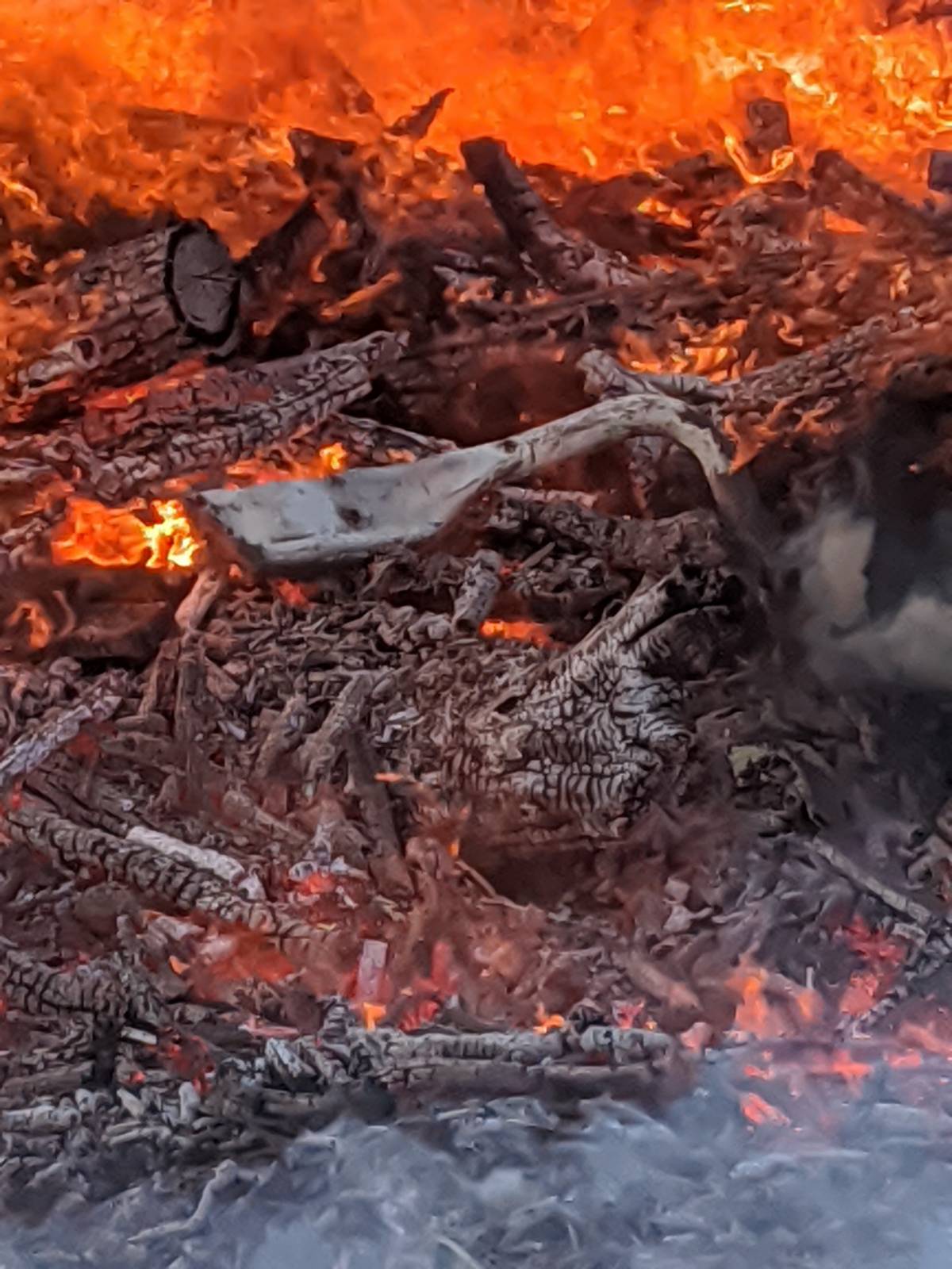

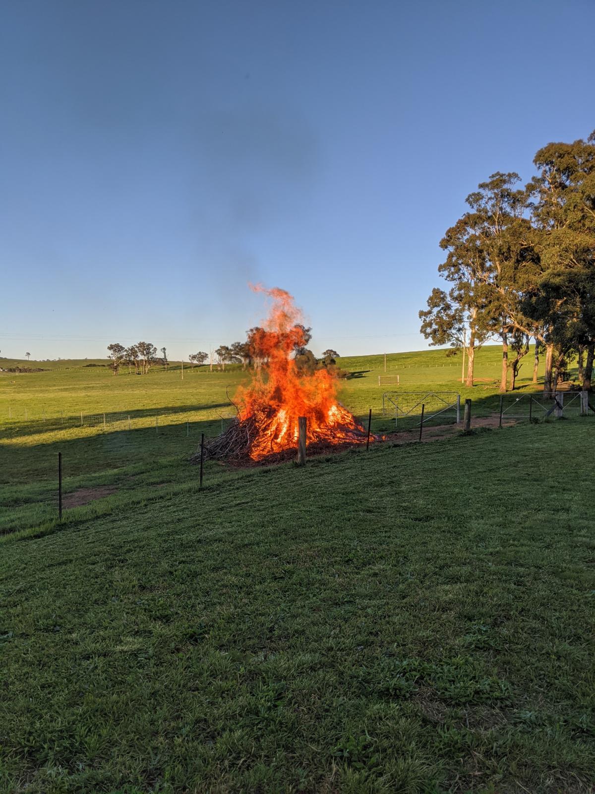

I'm told that the cooking was managed by waiting until the fire was down to a dull roar before putting the exhaust in and a chain was attached to enable retrieval when it was considered to be cooked to perfection.
Preparing the oven:
The cooking phase:

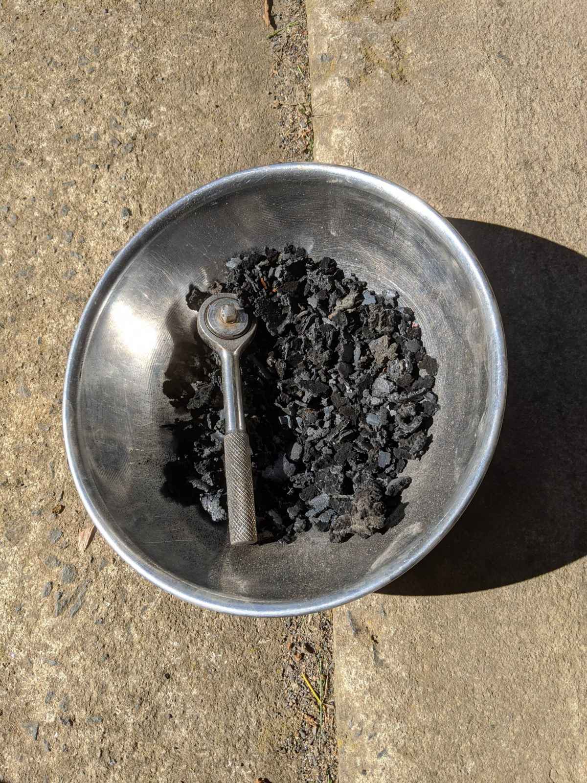

Some of the cooked internal detritus:

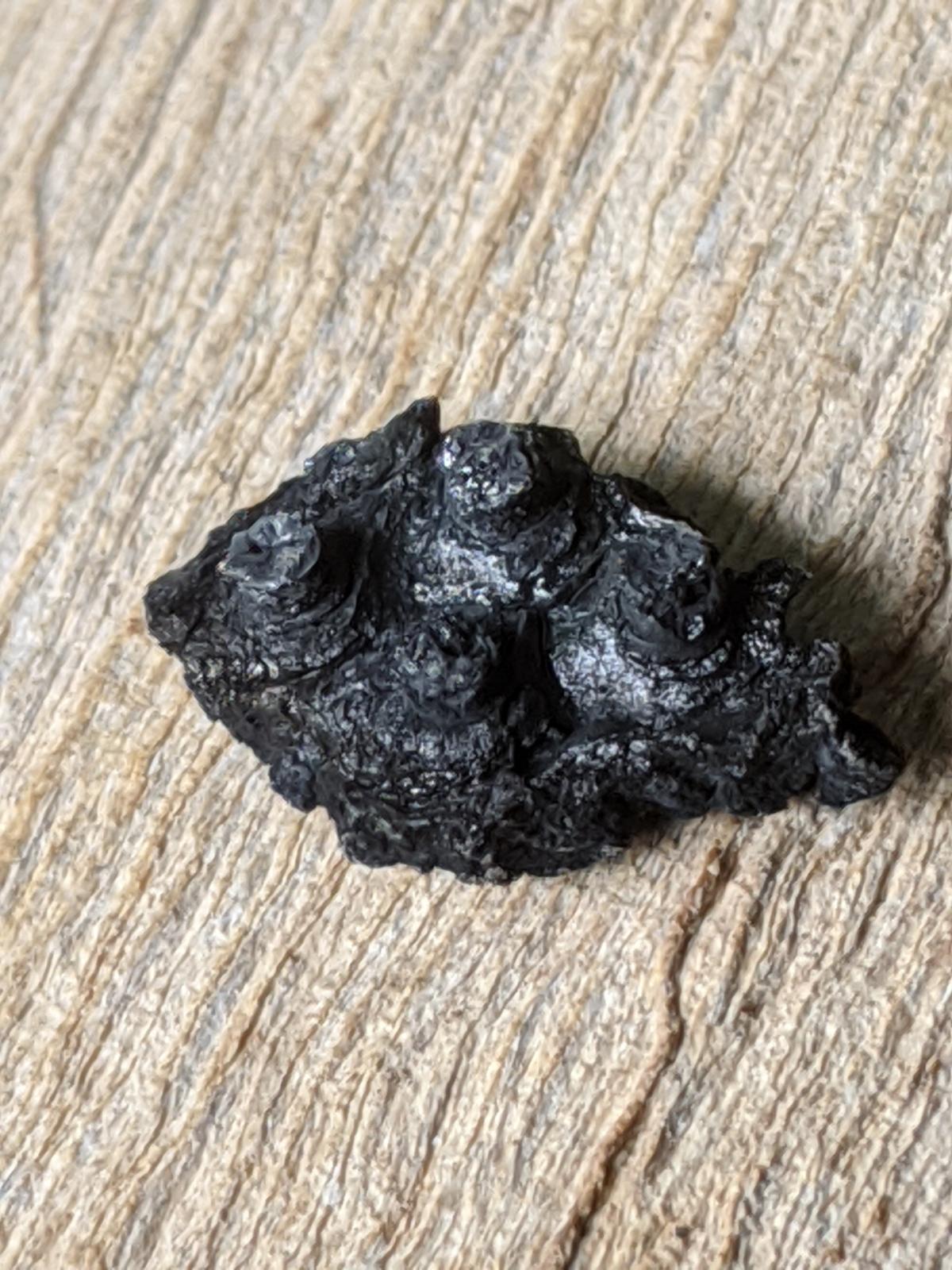

Close-up of detritus:
Afterwards the exhaust was a lot lighter and enjoyed much better breathing

Forget the exhaust. I'm looking at those beautiful green paddocks! So nice.
