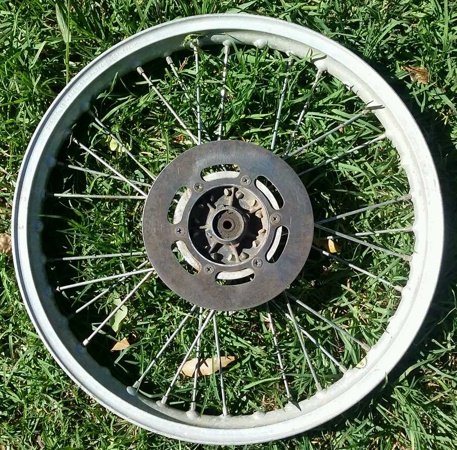

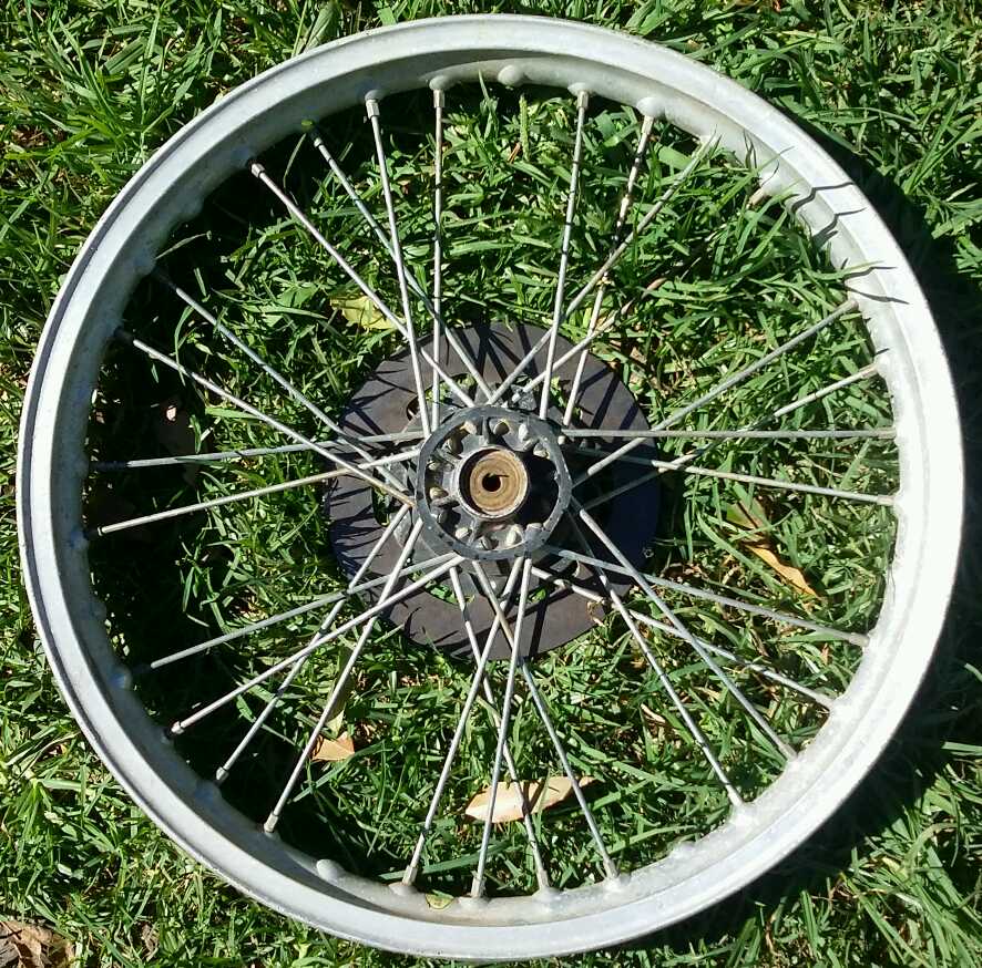

You are on to it David, 28 spoke holes is what I got when I first laid eyes on that hub of yours. My first thoughts were :bultaco: Tiron but the hubs are different and looks like many more spokes to me?
While we are going, I think this is outside Post Classic Era but has 28 spokes in a 19inch Akron rim:
Interesting as it skips spoke spaces that have never been drilled and no valve or rim lock holes, the valve comes through an unused spoke hole!

You are on to it David, 28 spoke holes is what I got when I first laid eyes on that hub of yours. My first thoughts were :Bultaco: Tiron but the hubs are different and looks like many more spokes to me?
That is seriously dodgy spoke work there Greg. As well as the deliberately missing spokes, it looks like not enough rake on the spokes. Surely that's not the original rim for that hub

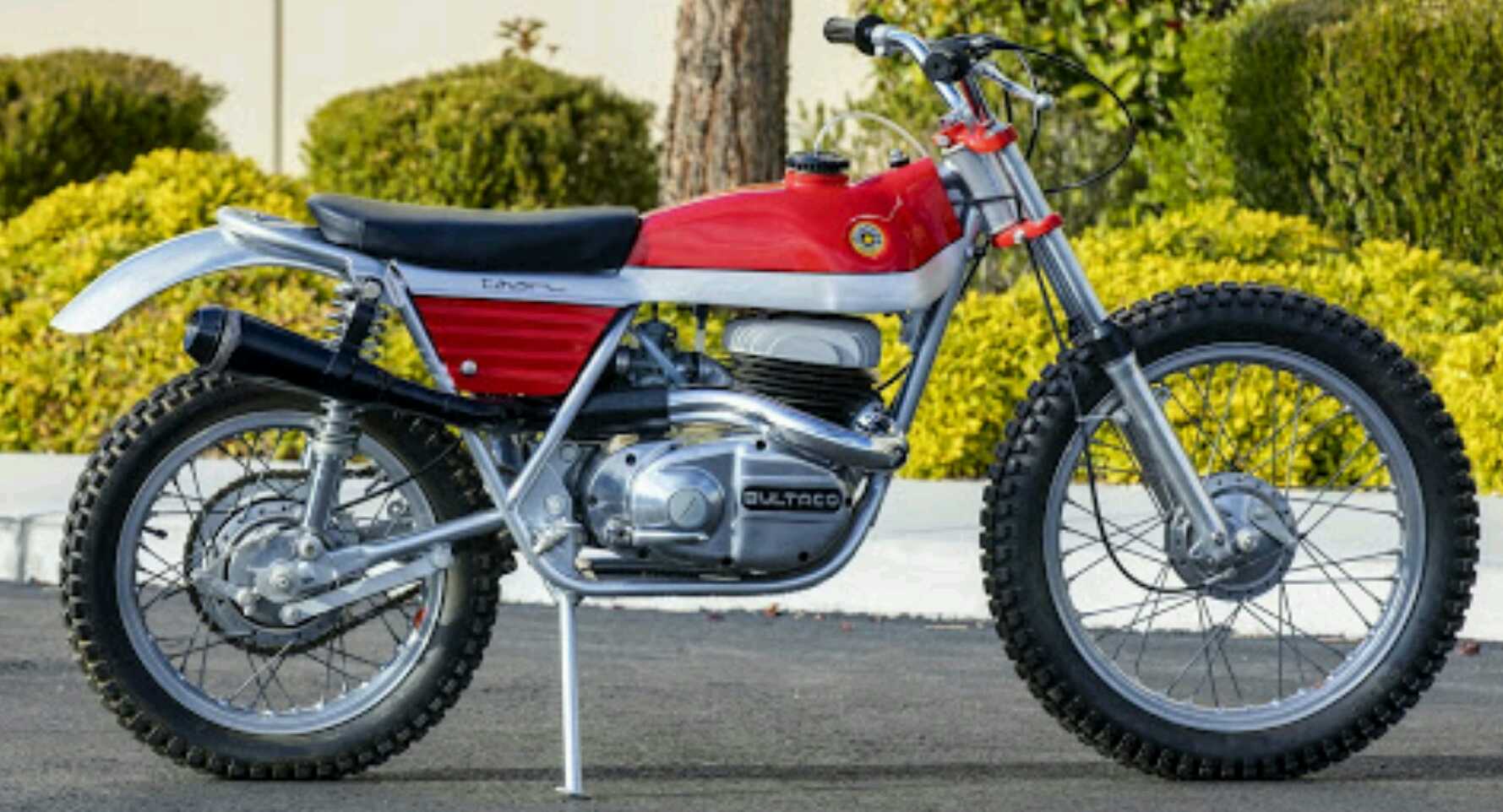

As for my 28 spoke rear :bultaco: hub, I finally decided to do a google search and was rewarded with someone selling a set of 28 spokes for a :bultaco: Mercurio. With that info, I then did a google search for photo showing the back wheel of a :bultaco: Mercurio and there it is.
One mystery solved. Now what about the 36 hole :bultaco: all-aluminium rear hub?
Posts: 4118
Seeing I was on a roll working out the identity of old Bultaco parts, I had a go at identifying the other all-aluminium hub which according to this UK eBay listing appears to be early :bultaco: Pursang. Wow
