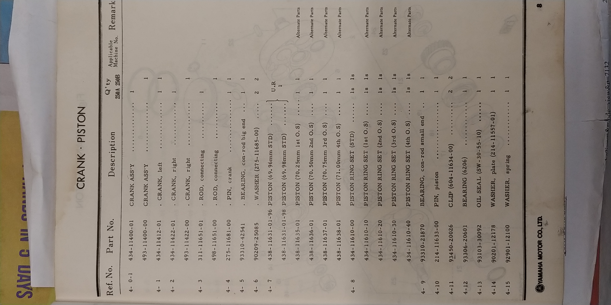

1. My TY250A parts manual was published June 1973
2. The manual lists the following part numbers for O/S pistons and rings
Pistons:
1st: 438-11635-00
2nd: 438-11636-00
3rd: 438-11637-00
4th: 438-11638-00
Rings:
1st: 434-11610-10
2nd: 434-11610-20
3rd: 434-11610-30
4th: 434-11610-40
3. Alongside the O/S piston and ring part numbers Yamaha flags *Alternate Parts* which correspond to O/S 'Piston Assemblies' with the following part numbers.
'Piston Assemblies':
1st: 434-11630-10
2nd: 434-11630-20
3rd: 434-11630-30
4th: 434-11630-40
4. A quick Google/eBay search suggests that a Yamaha partial part number of '-11630-' corresponds to a 'Piston Assembly' which (now correct me if I'm wrong) is a kit that contains at least a piston and a set of rings (and possibly other bits that are inconsequential to this discussion).
So, from the above I would hazard a guess that a 434-11630-XX is a kit that contains a 438-1163X piston and corresponding 434-11610-XX piston rings. Or perhaps even a 434-1163X piston with XXX-11610-XX non-Dykes-type rings from another bike (perhaps a DT2?) Maybe this why early TY250A's are found to have non-Dykes-type rings. Either way, my guess is that a 434-11630-XX is a kit with a matched piston and set of rings.
So from this I suspect the following (again correct me if I'm wrong)
1. 434-11610-XX rings suit 438-1163X pistons
2.'Early' TY250A's used 434-1163X pistons with XXX-11610-XX non-Dykes-type rings from another bike (perhaps a DT2?)
So, I guess I still haven't answered all of my original questions, but I am feeling confident that 434-11610-20 rings will be what I require for my rebuild.
(But I'd still like to know the differences between the 434 and 438 rings).

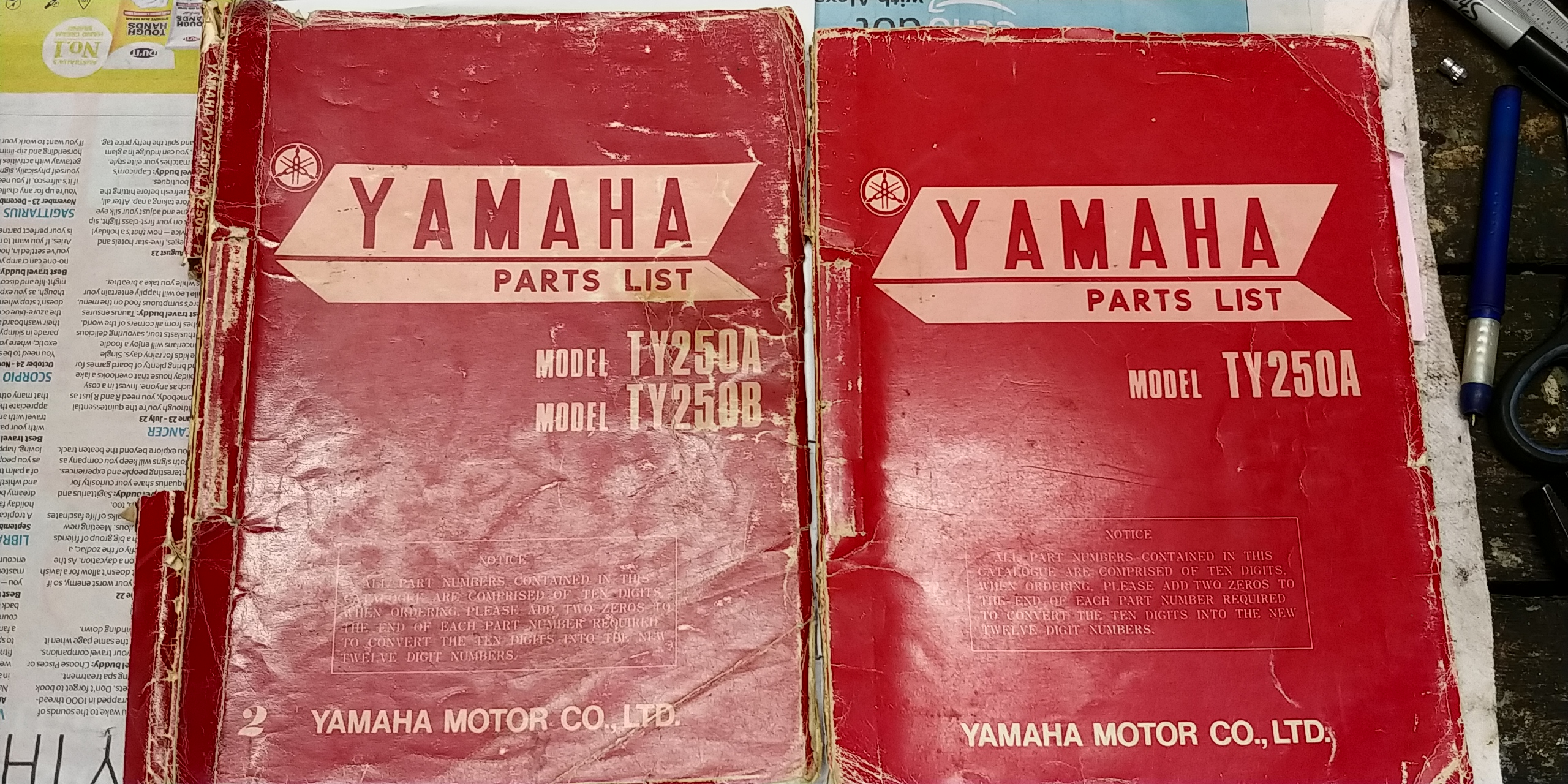

Re: TY250 Twin Shock OEM Ring P/N
I thought I'd post these photos of TY250 parts manuals up to hopefully help with solving the mystery
- 20201103_172648.jpg (1.09 MiB) Viewed 6240 times
- 20201103_172808.jpg (1.73 MiB) Viewed 6240 times
Thanks David
FYI my parts manual looks the same as your ‘TY250A’ only manual
