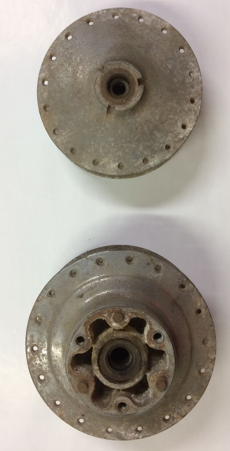

David Lahey wrote:So I decided to have a closer look at the all-aluminium :Bultaco: rear hub I posted up a photo of a couple of days ago. When I lifted it up for a better look I found another all-aluminium :Bultaco: rear hub hiding underneath.
I then realised that they are quite different and this might give clues to :Bultaco: experts who might see this posting to identify what :Bultaco: models they might be from.
I see that one of them has 28 spoke holes while the other has 36 spoke holes. I figure the 28 spoke hub is made for a small diameter :Bultaco: rim because old 18" wheels usually have either 36 or 40 spokes.
Both have 140mm diameter brake drums.
Does anyone know what :Bultaco: s they are from?
You are on to it David, 28 spoke holes is what I got when I first laid eyes on that hub of yours. My first thoughts were :Bultaco: Tiron but the hubs are different and looks like many more spokes to me?
