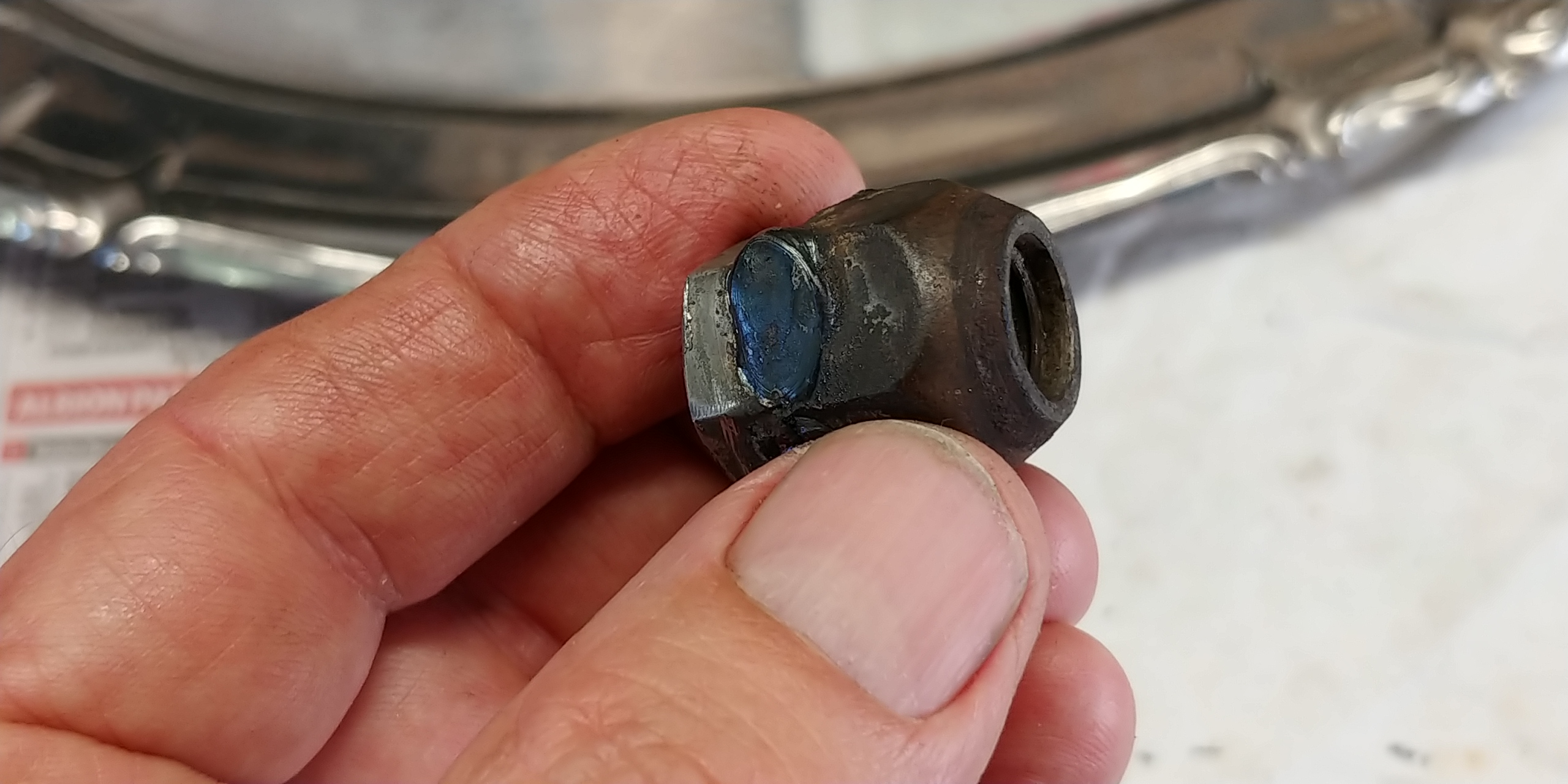

To make a tool I needed a piece of tubing big enough to fit over the crankshaft to push against the bearing inner race. I used a piece of light steel tubing from an old office chair post that I had kept for a rainy day. One end had a plastic bush in it that was almost big enough to go over the crankshaft so it got machined out a few mm and being plastic will protect the crankshaft seal contact area from damage. The other end had a flat plate with a 13mm hole in the middle which was perfect for the puller rod to go through.
For the puller rod I used a piece of 12mm threaded rod from Bunnings.
To connect the puller rod to the crankshaft thread I found that a wheel nut from a 1968 Datsun 1600 from my youth was the right thread, so it got welded to a nut that suited the threaded rod.
Here are the pieces on a Team Hardwood display tray:
Here it is in position:
It wasn't plain sailing though. Just as the crankshaft shoulder reached the bearing, the plastic bush broke. I wasn't certain that the crank was all the way home, so made a plug from 5mm aluminium plate that fitted into the end of the steel tube. Again, having that part made from something soft will protect the seal contact area on the crankshaft.
