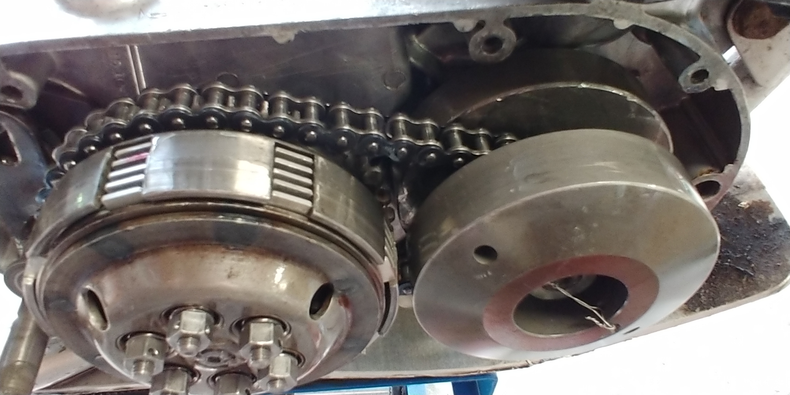

The photo is mainly to provide photographic evidence of five Barnett friction plates fitting comfortably into the :Bultaco: basket.
By fitting this :Bultaco: clutch with Barnett friction plates and Surflex driven plates, it has the best action I can get with off-the-shelf parts and most importantly, Bully Fanatic will be happy.
I had a brief test ride before it got too dark and am impressed with the clutch action. Light lever pull, very low drag, smooth action and smooth engagement over a fairly short amount of lever travel. Will be good to give it a full tryout on Sunday.

Thank heavens you showed a real primary drive David. I thought I was watching a horror movie there for a moment. Looks like the M49s have a lot more room on the primary side too David. I tried to put 5 Barnett plates in my M151 engine in my B motor and I had to chop all the clutch nuts in half to make it turn over without the nuts grinding on the primary case. I ended up only using 4 on all of mine. M159, M199 and the M151 engine in my M199B. So :Bultaco: :Bultaco: :Bultaco:
