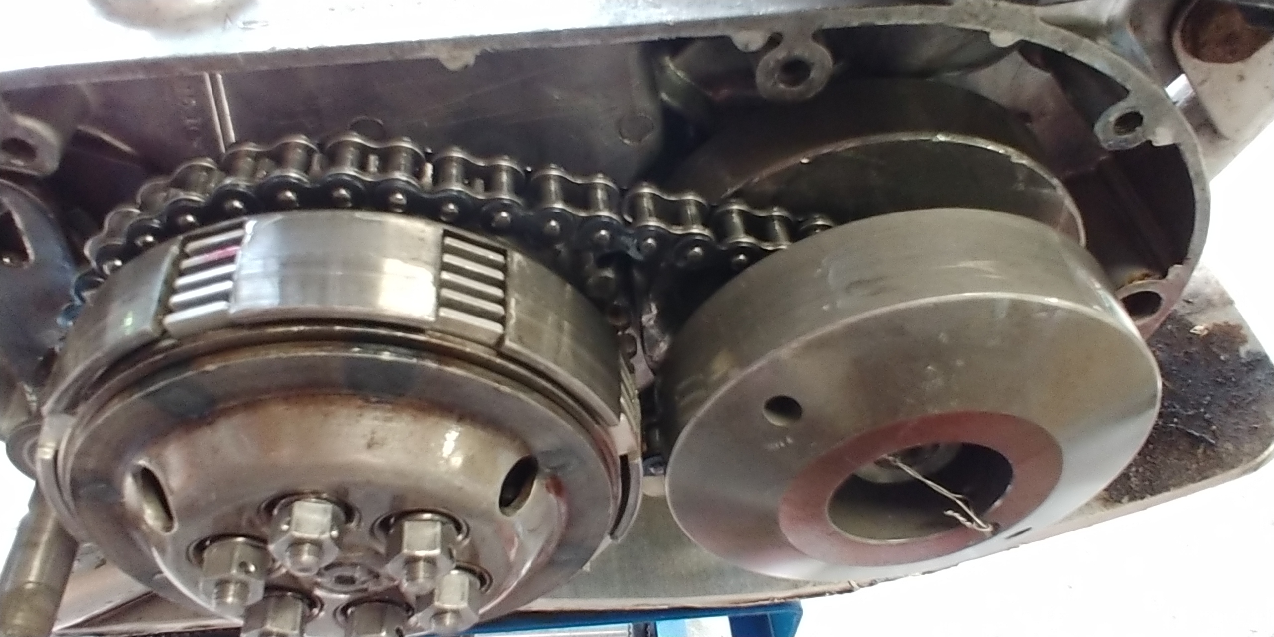

It just so happens that today after work I was preparing my 1968 :bultaco: for a trial on the weekend and it involved taking the primary drive cover off but sorry - no gears!
The photo is mainly to provide photographic evidence of five Barnett friction plates fitting comfortably into the :bultaco: basket.
By fitting this :bultaco: clutch with Barnett friction plates and Surflex driven plates, it has the best action I can get with off-the-shelf parts and most importantly, Bully Fanatic will be happy.
I had a brief test ride before it got too dark and am impressed with the clutch action. Light lever pull, very low drag, smooth action and smooth engagement over a fairly short amount of lever travel. Will be good to give it a full tryout on Sunday.

Thank heavens you showed a real primary drive David. I thought I was watching a horror movie there for a moment. Looks like the M49s have a lot more room on the primary side too David. I tried to put 5 Barnett plates in my M151 engine in my B motor and I had to chop all the clutch nuts in half to make it turn over without the nuts grinding on the primary case. I ended up only using 4 on all of mine. M159, M199 and the M151 engine in my M199B. So :bultaco: :bultaco: :bultaco:

Very nice Lobito David. John, I have to wonder at that geared primary drive kit for a Bultaco. All the stuff I have read over the years says that the reason Maico, Bultaco and many other European makers used a primary chain was the chain was quieter and let more horsepower through. All of mine work well with 4 Barnett drive plates in them.
