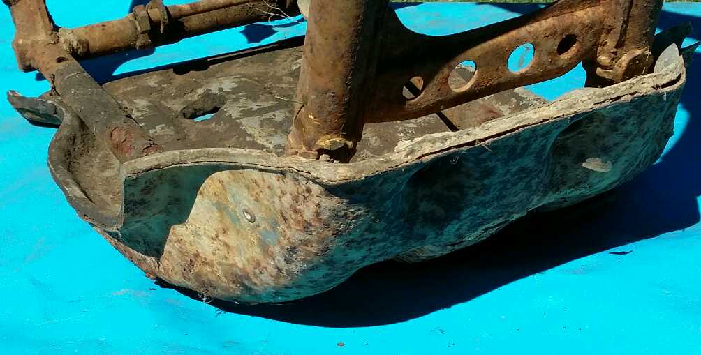

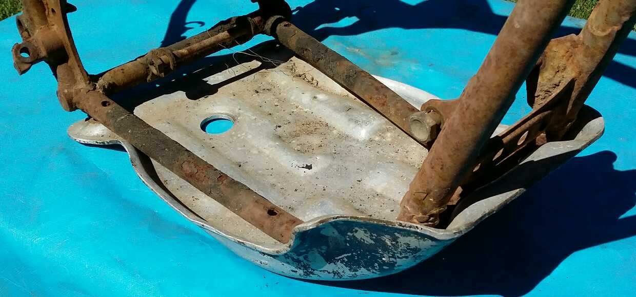

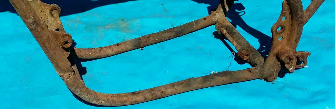

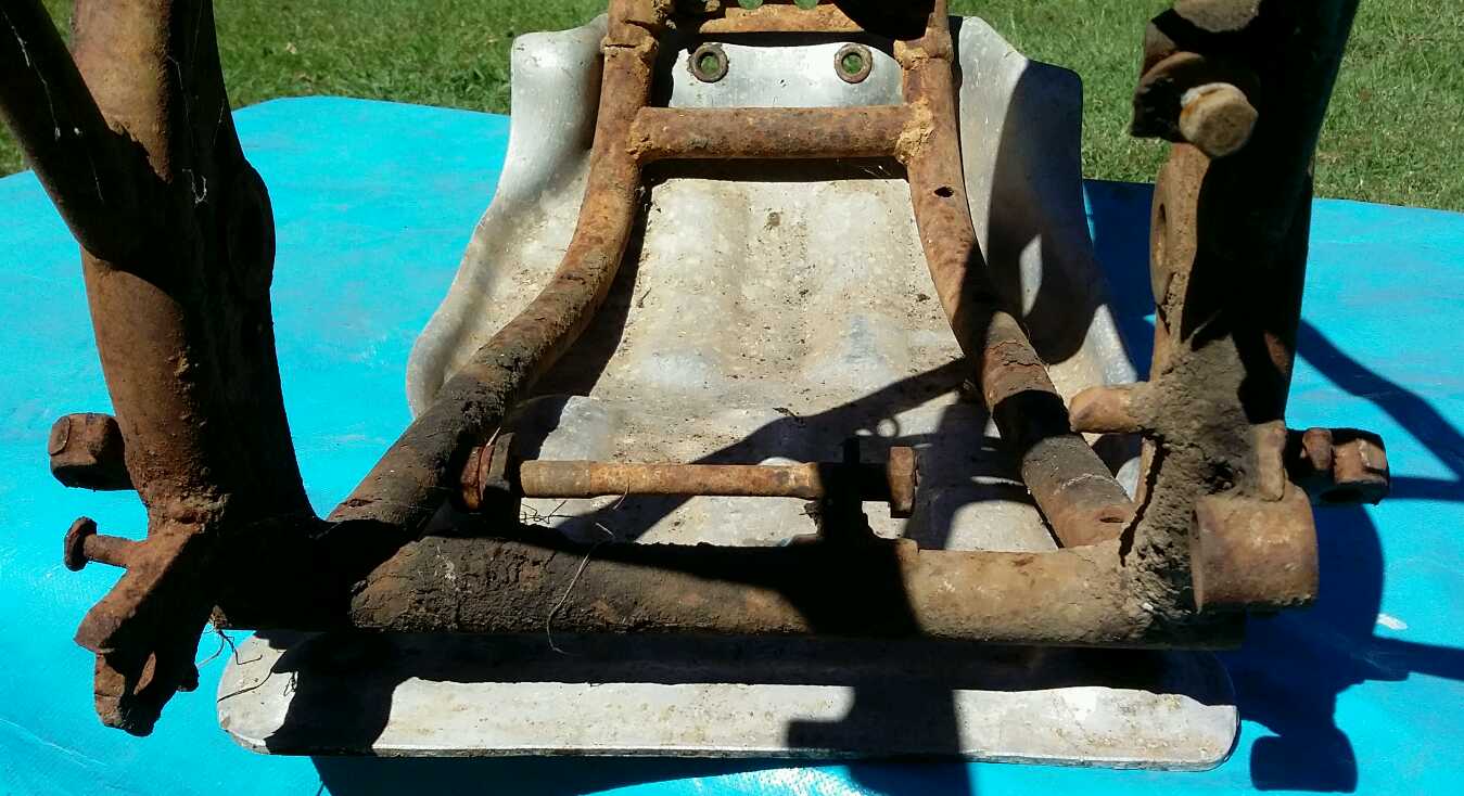

Here are some more photos of that :yamaha "A" model, I am not sure why either as it seems to be :
"What the hell were they thinking?"
On closer inspection, there are holes through the tubes presumably to mount a new bashplate and there is the age old argument that there should be frame tubes under the motor, what poppycock! Maybe the plastic/sheet metal bashplate failed and they wanted to start fresh?
You are right Mark, it has added weight and reduced the ground clearance by at least 20 mm......
Greg I agree with your logic about why they fitted tubes under the engine after the original bashplate falls apart.
You mention the metal-clad fibreglass bashplate being fragile. What about the first version that was just fibreglass which would have had an even shorter service life?
This :yamaha TY250 bashplate is a home-made copy of the original made of super thick fibreglass and has survived pretty well.
It came fitted to a :yamaha TY250B I bought in the late 1990s that also had a lot of other home-made things so I'm thinking the owner was fairly creative.
One other home-made thing I remember from that :yamaha TY250B was the swingarm pivot inner bush didn't have the normal setup with a hole through it for the bolt. The home-made inner bush had a threaded hole in each end and was held into the frame by a hex headed bolt at each end.
Another thing was the rear brake backing plate axle hole had been re-bushed and they made the axle hole with much less clearance to the axle than the standard hole had. I'm thinking this was an attempt to improve the brakes but am open to other possibilities
