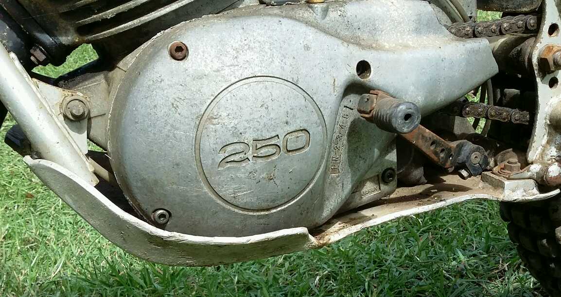

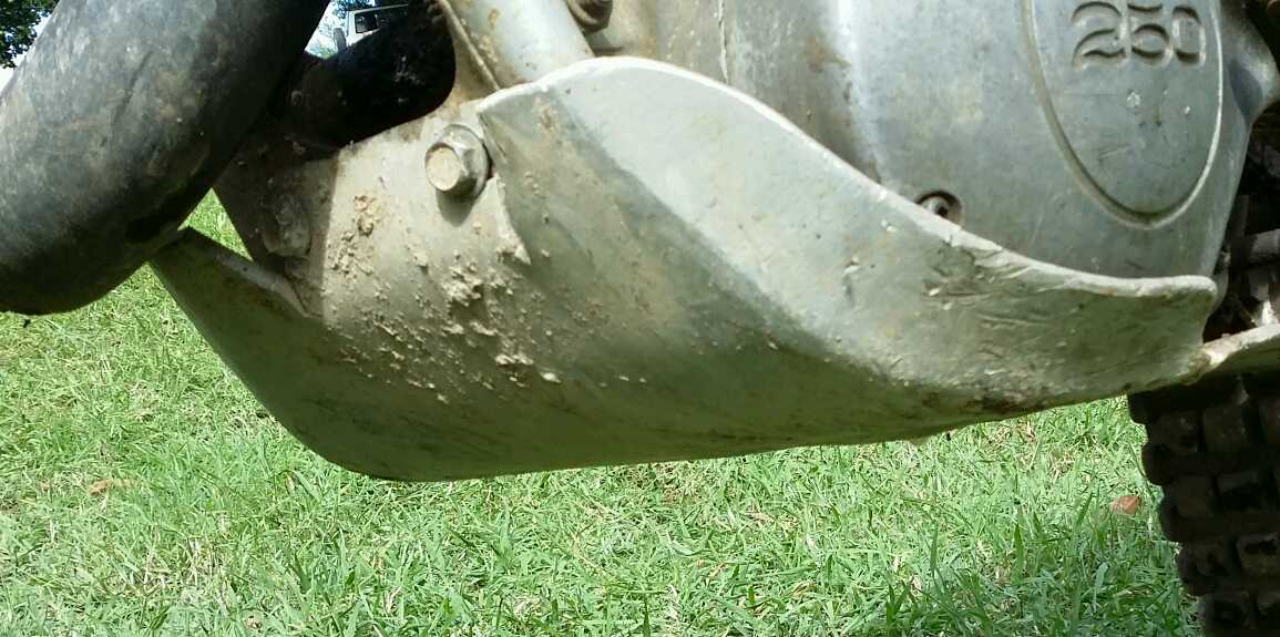

Here are some photos of the custom bash plate on one of my "A" models, Alastair might recognize it?
It certainly does the job well when you consider the gouging and the deformation under the gear lever, then look at the casings. Not sure what grade of alooooominium was used but I think it must be 5005 which is fairly pure and soft. It always makes me laugh when components like this are offered for sale new and a grade is NOT stated as it pretty much means melted down Pots and Pans!
Recycling alooooominium is important as it take five times the amount of energy to make alooooominium out of raw materials than it takes to reuse. However if you are melting down Pots and Pans, you are only going to end up with Pots and Pans strength.

The stunning Allooooominum bashplate on my bike was actually made by fellow Shatterer Greg Henry ... from material supplied by Gary Boniface. I reckon David can find photos of it. Should there be just a little warning of an impending nuclear holocaust ...my plan is to remove it from the bike ... put it upon my head ... shut my eyes and hug the bike ... tightly.

I reckon this is the same type of bashplate
