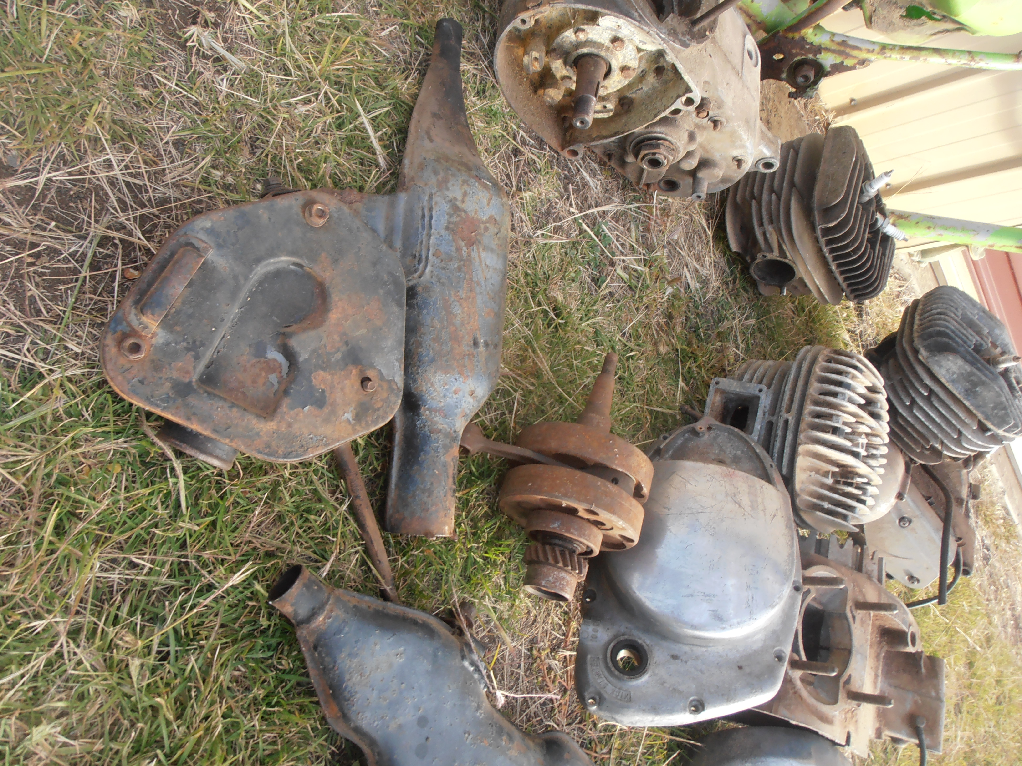

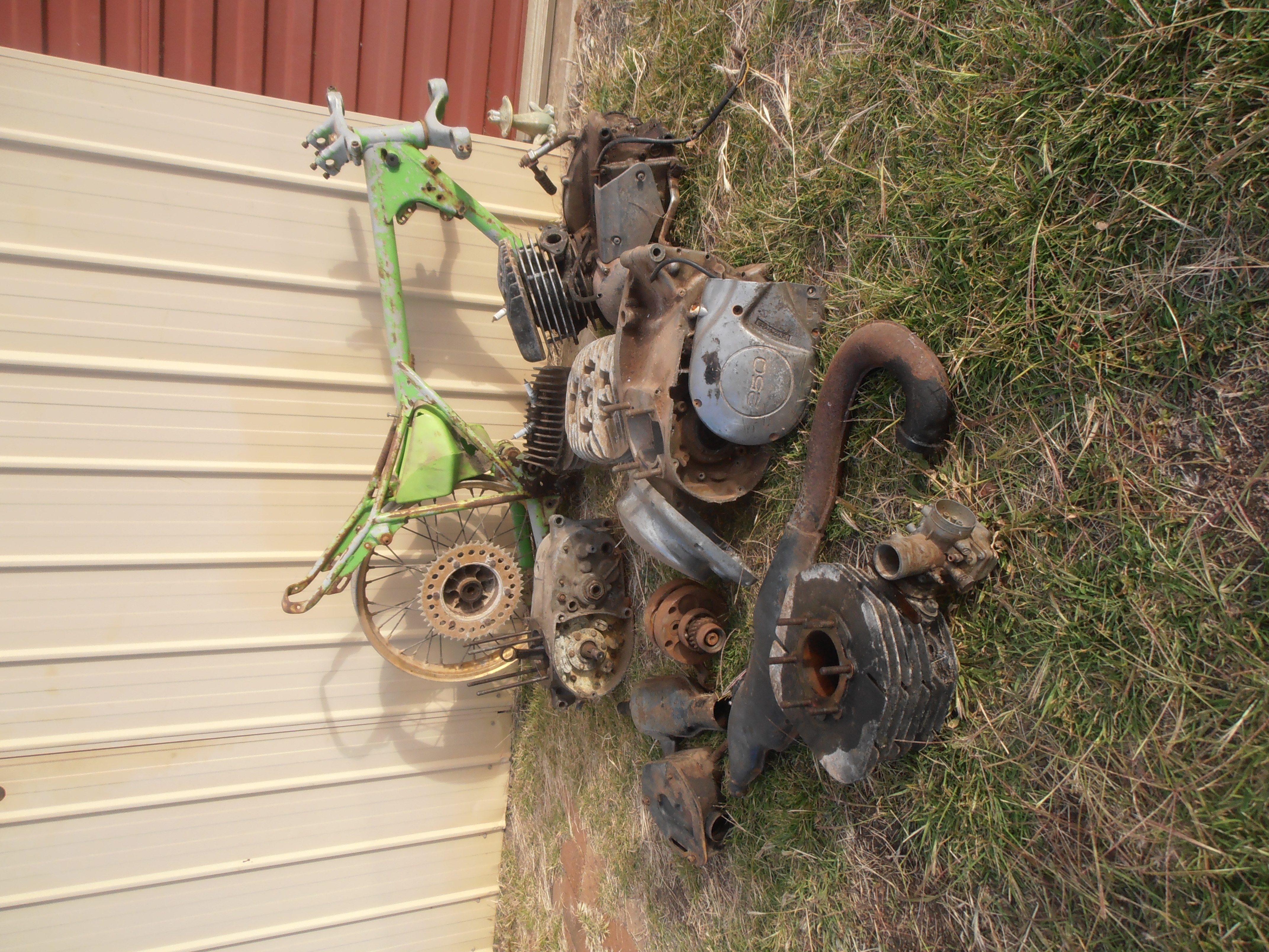

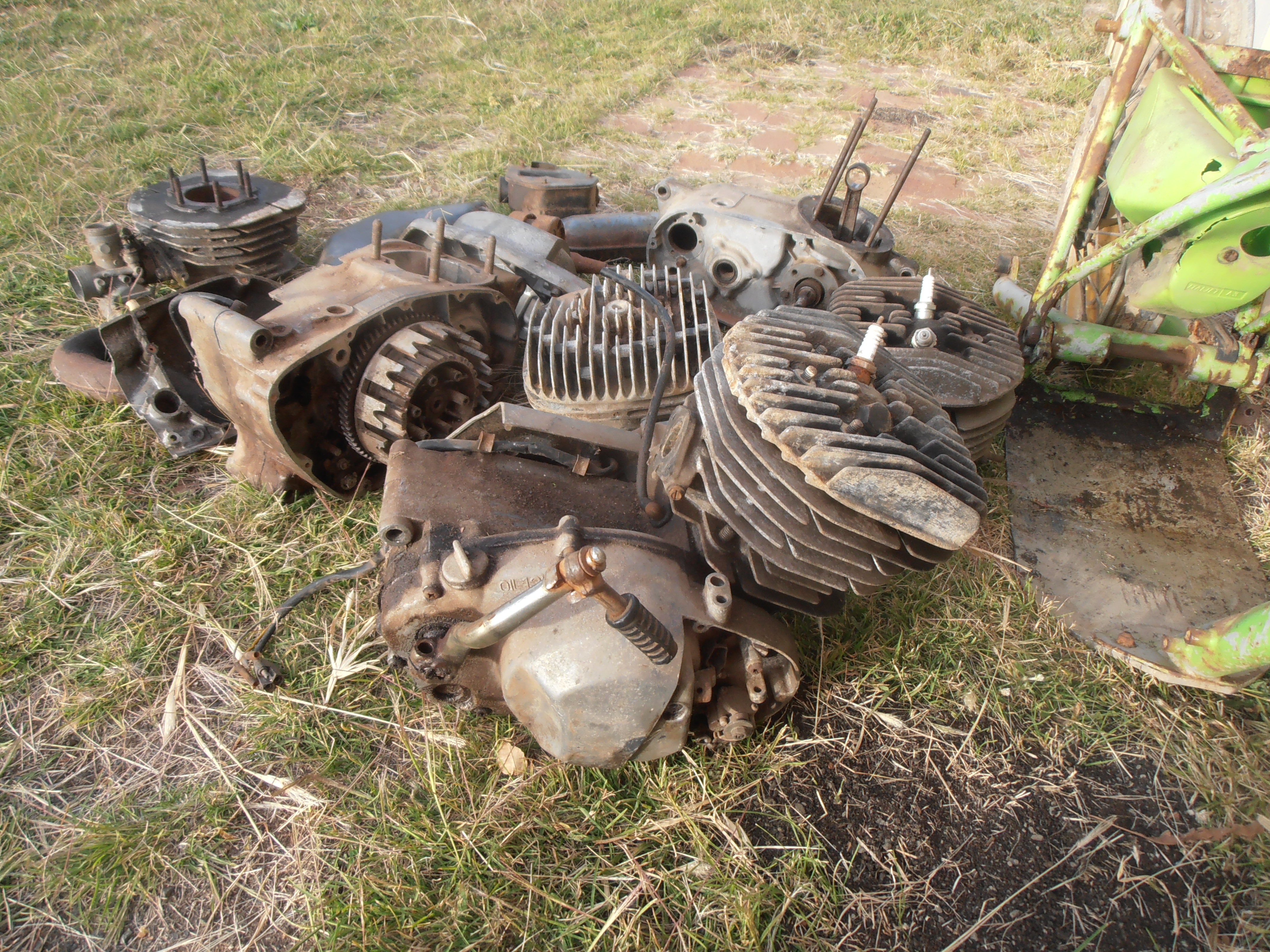

I found a fair bit of surplus trials stuff for your consideration Greg. Here's a few pics.
Italjet frame, swingarm & bashplate. Rear wheel brake surface is very pitted. Airbox has several cracks.
(I'll need to keep the triples)
KT exhaust has hole in the bend of the header. Rear muffler has no baffle. Airbox is OK.
KT Engine is complete, with CDI stator and flywheel but don't know what condition. Bigend is shot. Kickstart lever has been tack welded to shaft (by PO).
2 extra KT barrels and 1 extra head which has one stripped plug thread. KT carb attached.
TY250 engine. (B model I think) Rod is bent. Sidecovers are A model. (Actually, I'll need to keep the clutch-cover, clutch and primary gear for my TY project)
138 Alpina cases and crank.

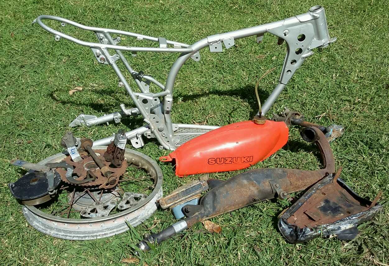

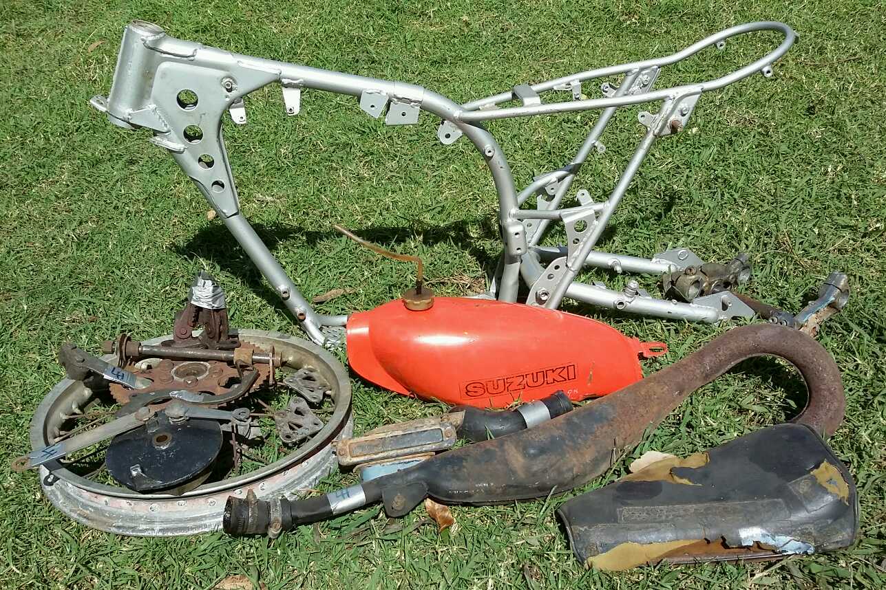

John, here are photos of the parts you have requested:
Since those photos were taken, I have had a bit of a rethink and here is a photo of some other parts I think you will need to build a complete :suzuki RL 250:
If you are happy to swap your eclectic collection for my :suzuki parts then so am I. It will be really good to see another :suzuki RL 250 up and running!
