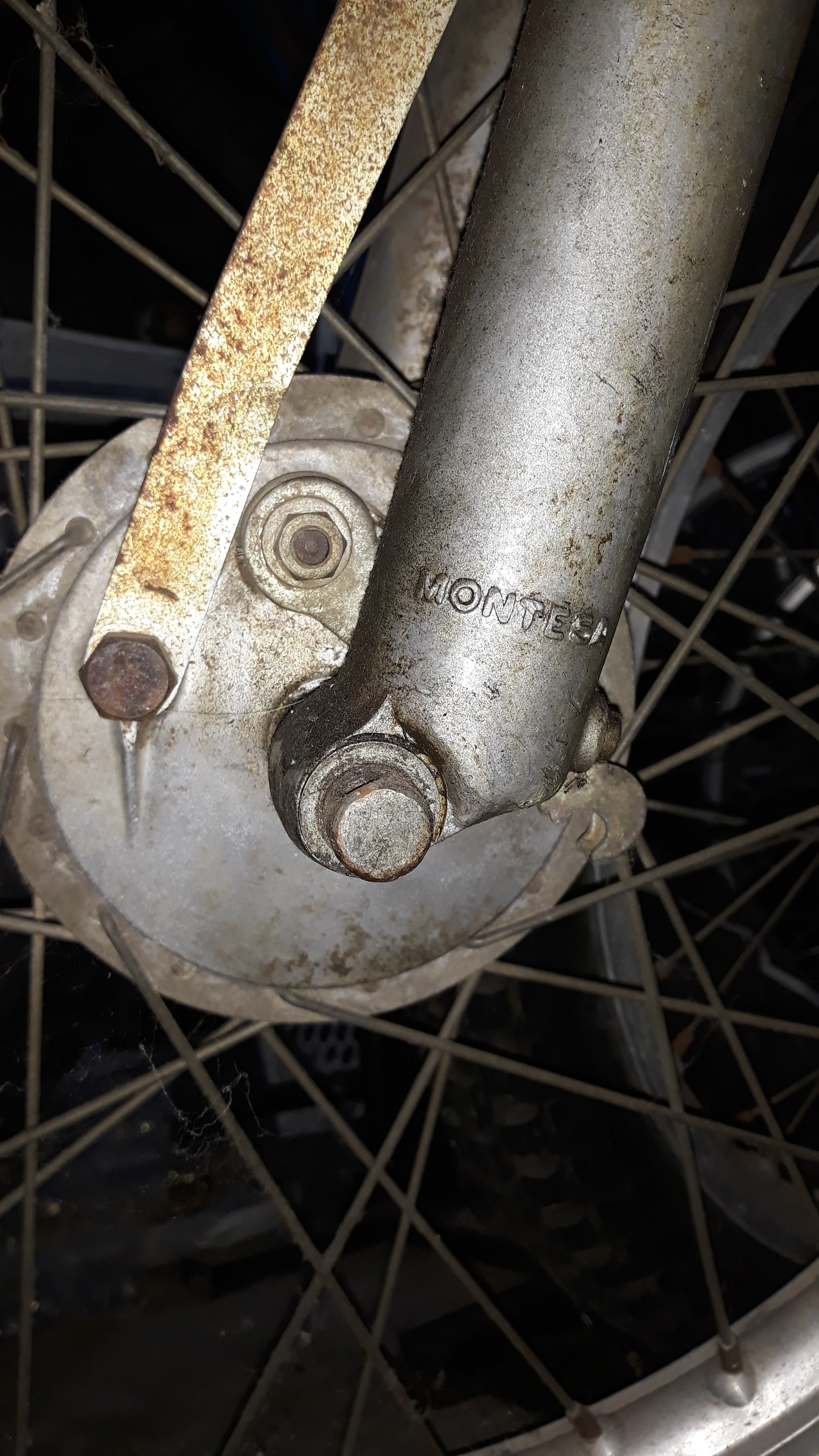

David Lahey wrote:Hmmm... you've got me thinking about those :montesa forks Kurt. Cota 172 forks have an in-line axle. Maybe Cota 200 forks?? They look good whatever they are.
:montesa had a thing going in 1981 where they slimmed the trials bikes down by reducing the fork tube spacing but it made it easier to knock the front end out of alignment compared to the wider-spacing tubes front ends on the 247 and 348.
As for the :Honda: TL125 tank joint, I was planning to oxy weld the edges. I think that TIG would probably be better but the bike was made in the oxy welding era after all.
Cota 200
Here's a pic of the grubby original forks on my '74 Cota 247 black frame (LW, Light Weight apparently). As you can see, slight axle offset, so maybe somewhere in between the offsets of 172 and 200. Cheers.

Kurt, I see your Cota has been modded for laid down shocks, tricky!

The laid down forks were not of my doing, somebody was using it as a development bike at some stage.
Their Ideas are quite good though with the Mikuni carb, laid down shocks and the handle bar clamps off a Japanese dirt bike that raise the bars and shift them forward.
I was thinking they were 172 forks due to the square shape of the Leg but you are onto something with the leading axle being from a 200.
Couldn't be many Cota 200's without a front end around.

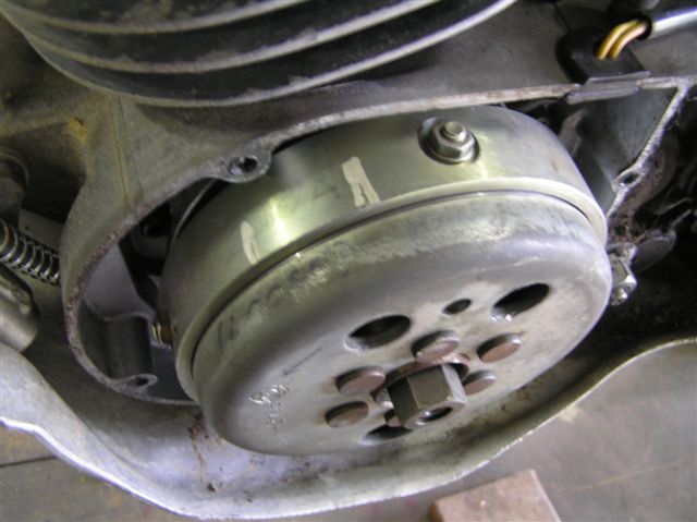

TY250 flywheel identification for Ray Vinton
This is what a TY250A model flywheel looks like. The TY250A has the same cup as the other TY250 twinshocks but has a thinner steel band around the outside
