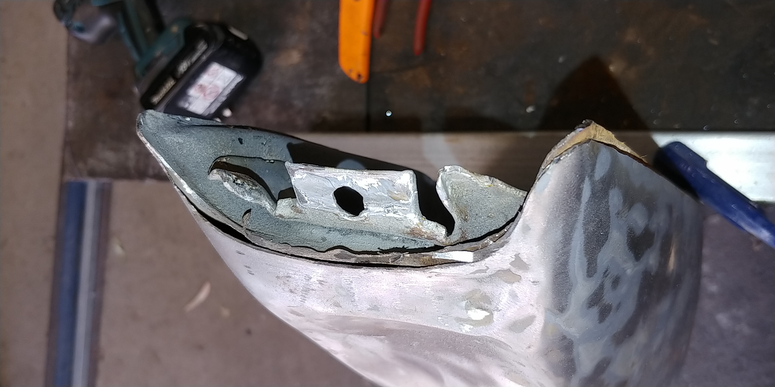

The :Honda: TLAh mudguard is plastic, here is how it came to me:
Pretty sure it is genuine :Honda: from one of these:
Does this photo help you understand?
Still have no clue how I broke it, my usual trick is to snap them in half next to the rear mounts?
OK So it is some sort of moulded plastic then.
There's a cool tool I've seen advertised recently that heats up WWWWWW shaped pieces of steel strip and embeds then across breaks in plastic panels just like yours. Would look like surgical stitches but would be strong (and very cool, like surgical stitches). I'll see if I can find a link
Here are what the WWWW things look like and there's a heating tool that holds them so you can push them in while they are hot. I think the whole kit including the tool is about $70
https://au.banggood.com/100Pcs-Hot-Stap ... &ID=522934

Phil, can you be a little more specific? Is this what you mean.
This what I use to bond plastics together.
It looks to dissolve both surfaces and they then join together as the adhesive evaporates.
Tried to attach a phot, but my iPad is not cooperating.
I use Humbrol, Liquid Poly.
Available from modelling shops.
https://www.australianmodeller.com.au/p ... iquid-poly

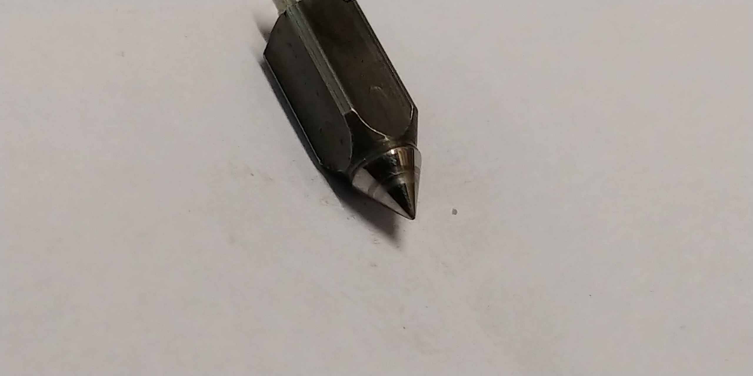

After fixing the sticky :kawasaki KT250 float needle a couple of weeks ago, I rode a trial last Sunday and the :kawasaki ran unevenly at times.
While the carby was apart cleaning the gum off the needle valve before that trial, I did see a bit of wear on the needle but didn't have a spare needle kit handy so just rode with it and so I wasn't that surprised that it didn't run that well.
So last Sunday night I ordered a couple of needle kits from the Mikuni agent in Townsville. They posted the kits off on Monday and Australia Post amazed me by delivering them to my house near Gladstone on Thursday. That's three days in transit which is faster that having things sent from Brisbane to here.
Here's a photo showing the wear on the needle. I've had to replace so many of these needle kits in Mikuni carbys over the years that to me it seems to be a bit of a weak point in their design. My bikes do a lot of hours travelling in a trailer but I usually run the fuel level down in the carby before loading them, hoping to minimise the wear.

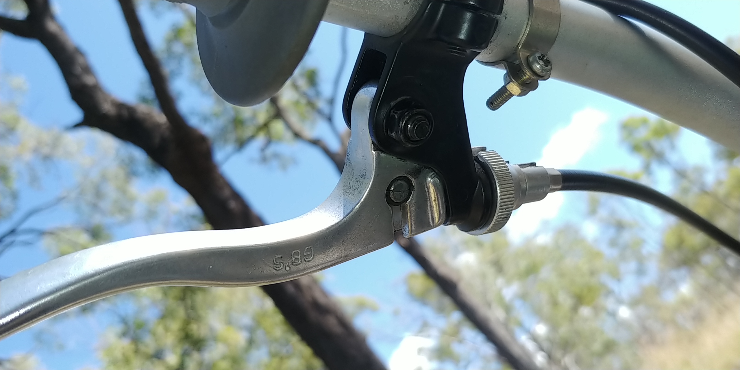

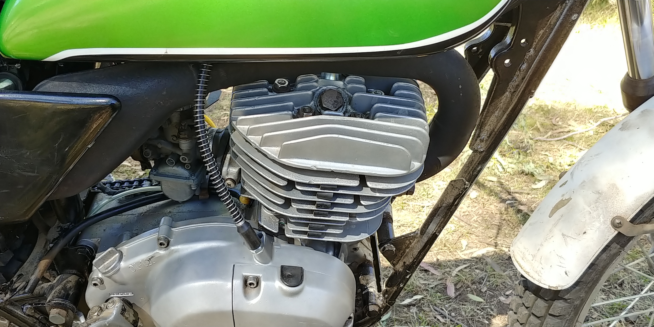

After rebuilding the :kawasaki KT250 motor, I had to deal with clutch slippage from the extra torque. It was previously set up with four :yamaha TY175 springs which are the same length as, similar diameter to and slightly stiffer than KT250 springs. This wasn't enough pressure plate force for the newly-rebuilt motor so to get it ready for an upcoming trial I fitted six standard :kawasaki KT250 springs, which definitely stopped the slipping. However this trial had two sections that benefited from using the clutch in a controlled manner and the lever pull was too much for my old body to achieve delicate control.
So I started thinking about ways to make the lever pull lighter. It already had a Ballard's high-ratio lever. I looked at ways to incorporate a lever device to further increase the ratio and also looked at fitting a pit-bike hydraulic clutch conversion but those ideas were eventually usurped by the idea of reducing the clutch spring preload. I figured it was a good thing to try because it wouldn't cost anything, wouldn't take long to do and it was also what Greg Harding suggested 8)
Today is test and tune day so I did the float needle swap, reduced the clutch spring preload by about 20% (10.2mm to 8.2mm) and fitted a new Venhill KT250 clutch cable. I wasn't that impressed at having to modify the cable outer to get it to fit the bike.
The testing today went very well in that it won't slip even fanning the clutch in top gear and the lever action is heaps lighter. Very nice. I'm even thinking of reducing the preload further but will give it a much longer test before making another change.

David Lahey wrote:After fixing the sticky :kawasaki KT250 float needle a couple of weeks ago, I rode a trial last Sunday and the :kawasaki ran unevenly at times.

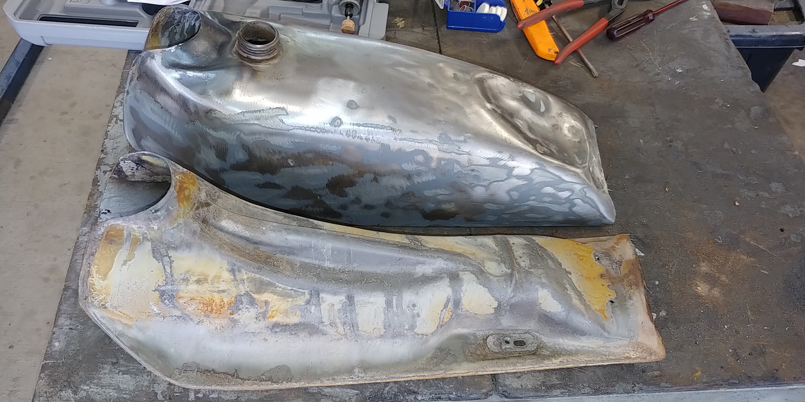

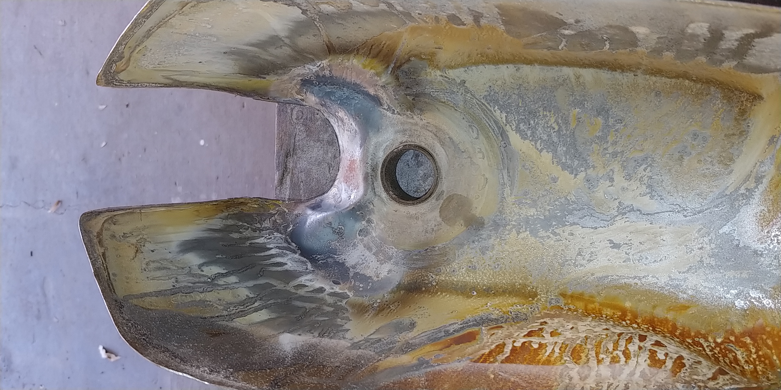

Today is my RDO and I decided to get cracking on my friend's :honda: TL125 tank.
Years ago my sister gave me a kit of Dremel tool inserts, assuming I had a Dremel multi-tool, like she did, but I didn't.
All the years I was a model aeroplane builder, I thought that the Dremel was a really cool thing but a bit extravagant (expensive) and not really necessary so didn't buy one.
When I looked at the welded seams on this :honda: TL125 tank I wanted to cut apart, I realised that my trusty 4" angle grinder was not going to be able to reach all of the seam. Finally, (like the 4 jaw chuck I recently bought for my lathe) I could justify in my own mind buying a Dremel.
Then came the revelation that Dremels are now much cheaper relatively than they were in the 1970s and that there was even a re-chargable Dremel that didn't weigh much. One trip to Bunnings later and I was set.
Anyway here is what the :honda: tank looks like after I separated the top and the bottom. Releasing the seam near the rear tank mount was quite tricky due to some old weld repairs someone had done there. The rest of the seam was straightforward. While grinding the rear mount end, I re-used the jig that I made to hold the tank when I initially tried to pull the top dent out from the outside.
The shape of the bottom half of the tank seems way more complex than I would have thought necessary.
