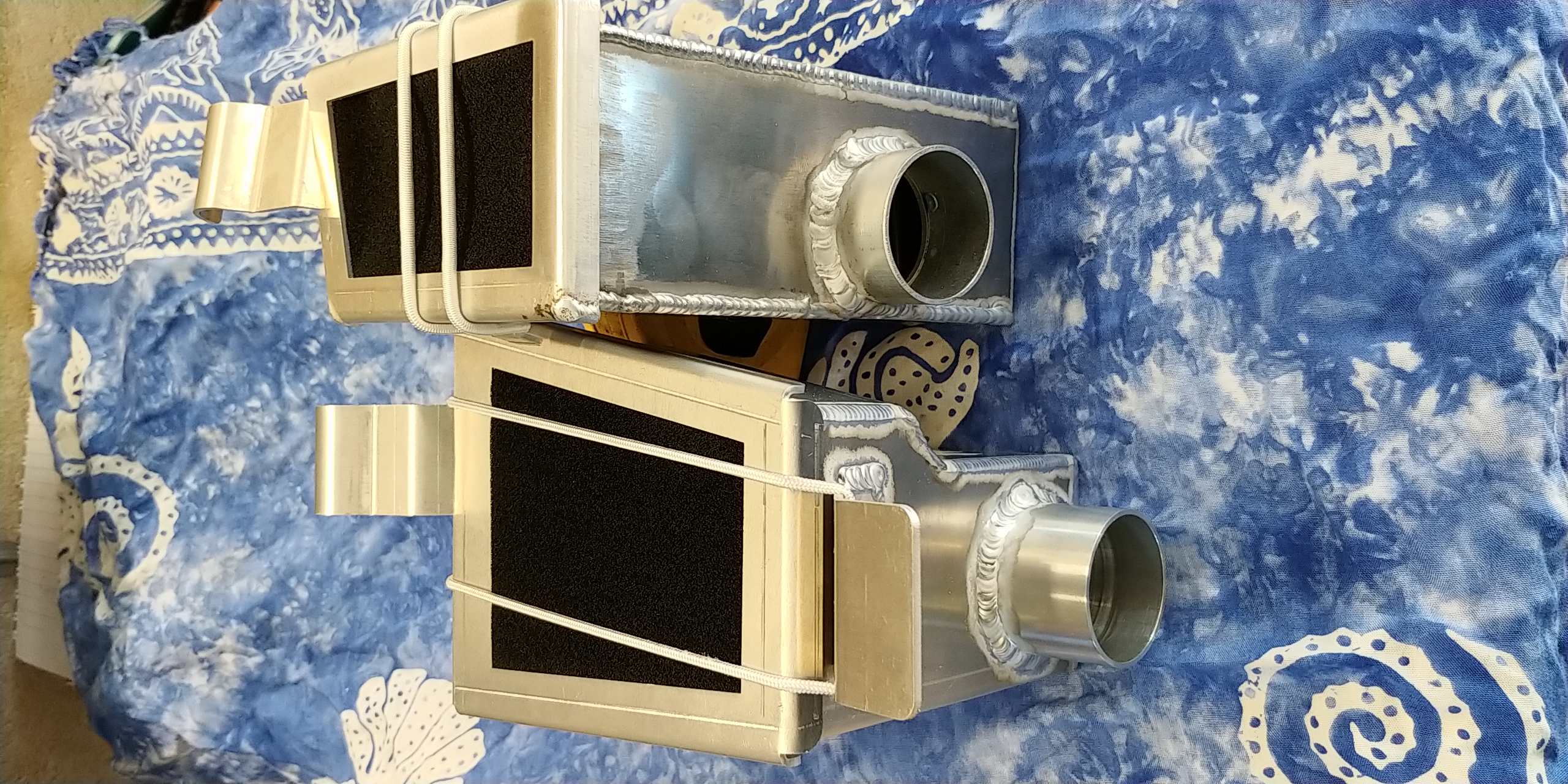

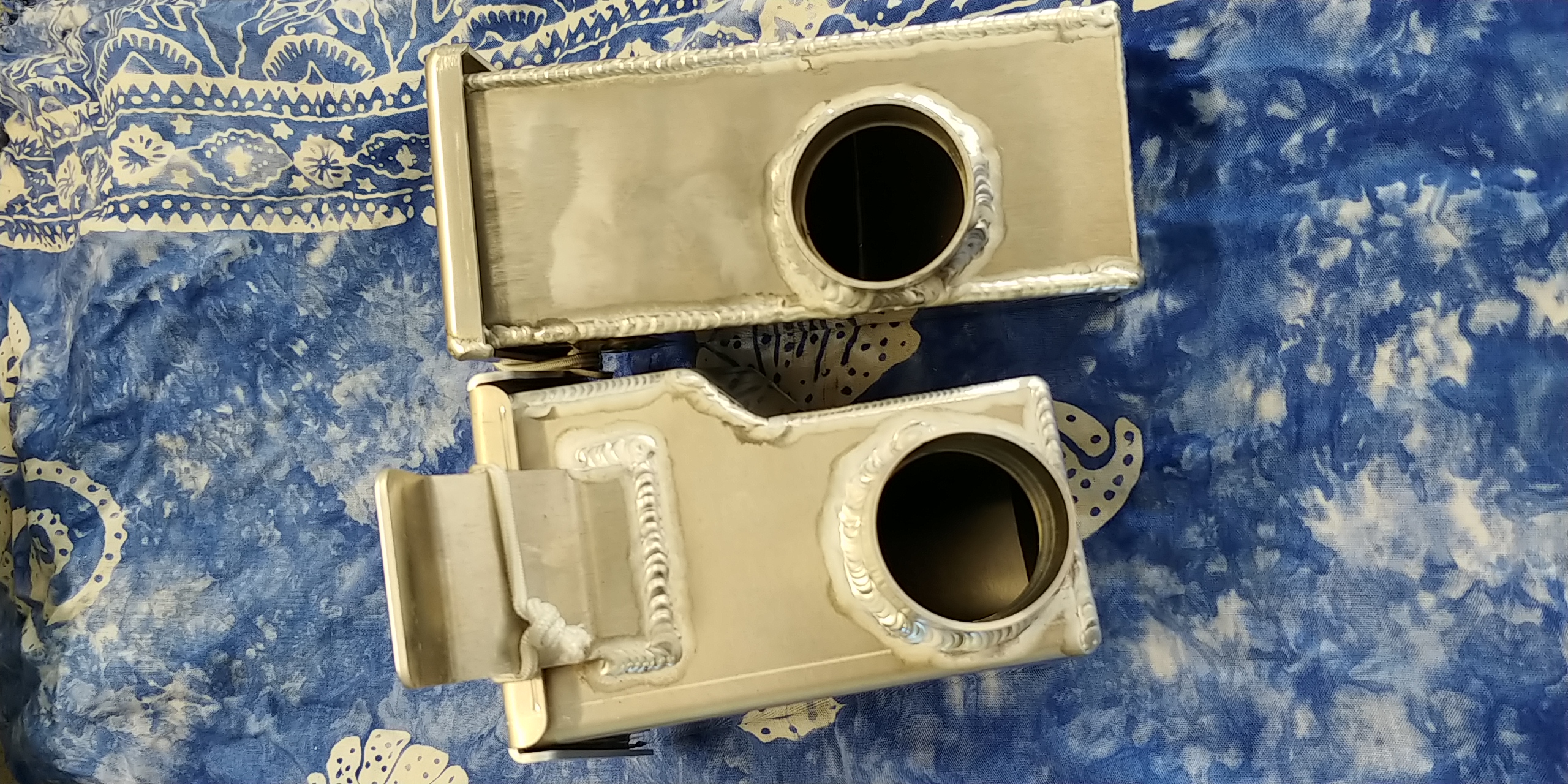

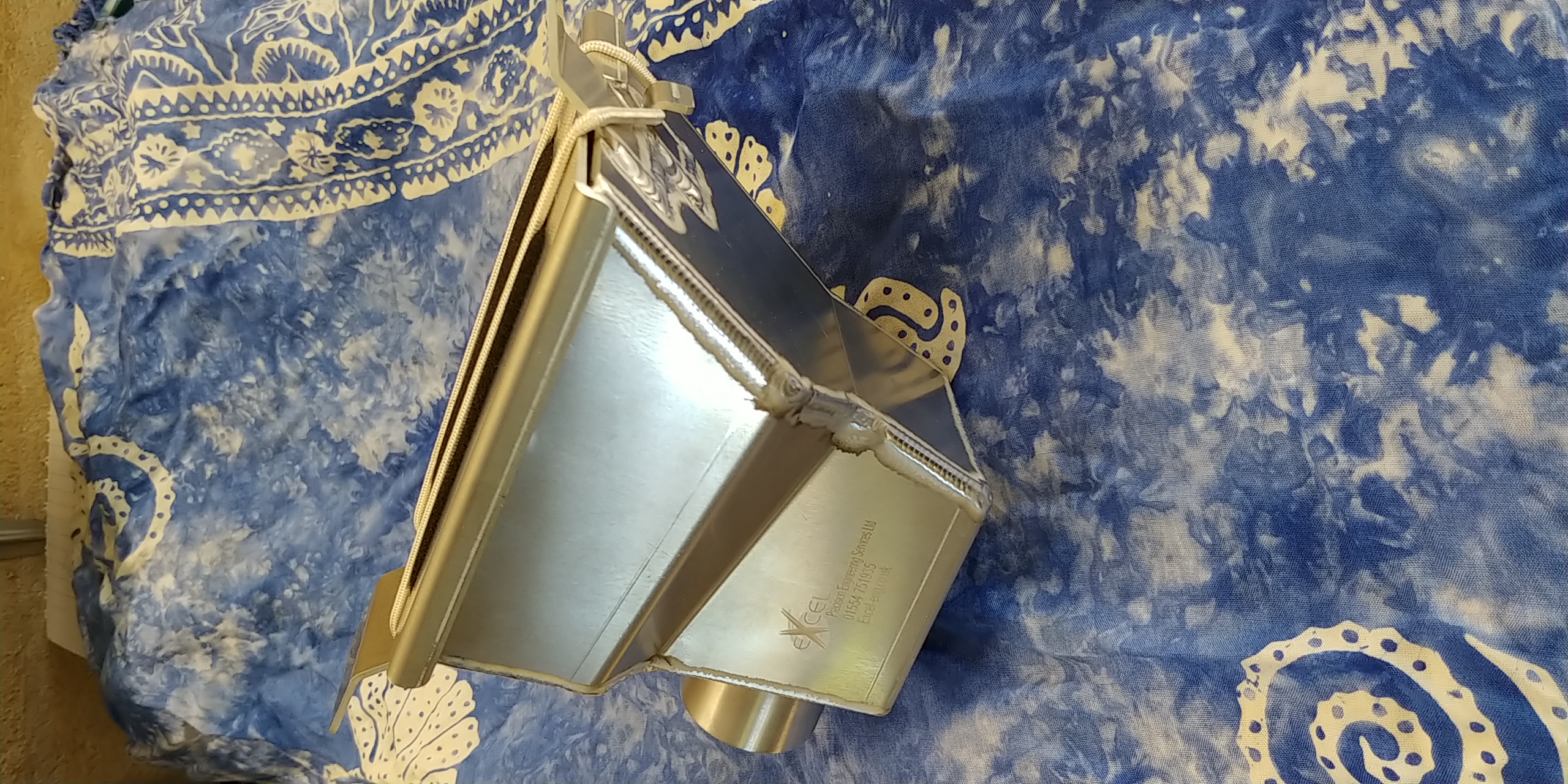

aftermarket TY air cleaners
There's a bloke in (not new) South Wales making nice aftermarket air cleaners for twinshock :yamaha TYs.
I've bought a couple to try out.
The bigger one is for Godden :yamaha 250/320 frames and the other one is for standard :yamaha TY175 frames.
My Godden :yamaha has been running with a pod filter for years because a TY250 airbox sits too high.
I've been intending to make a decent air cleaner for it for years, half-hoping someone would start making them commercially so when Eirian Davies started making them I couldn't resist.

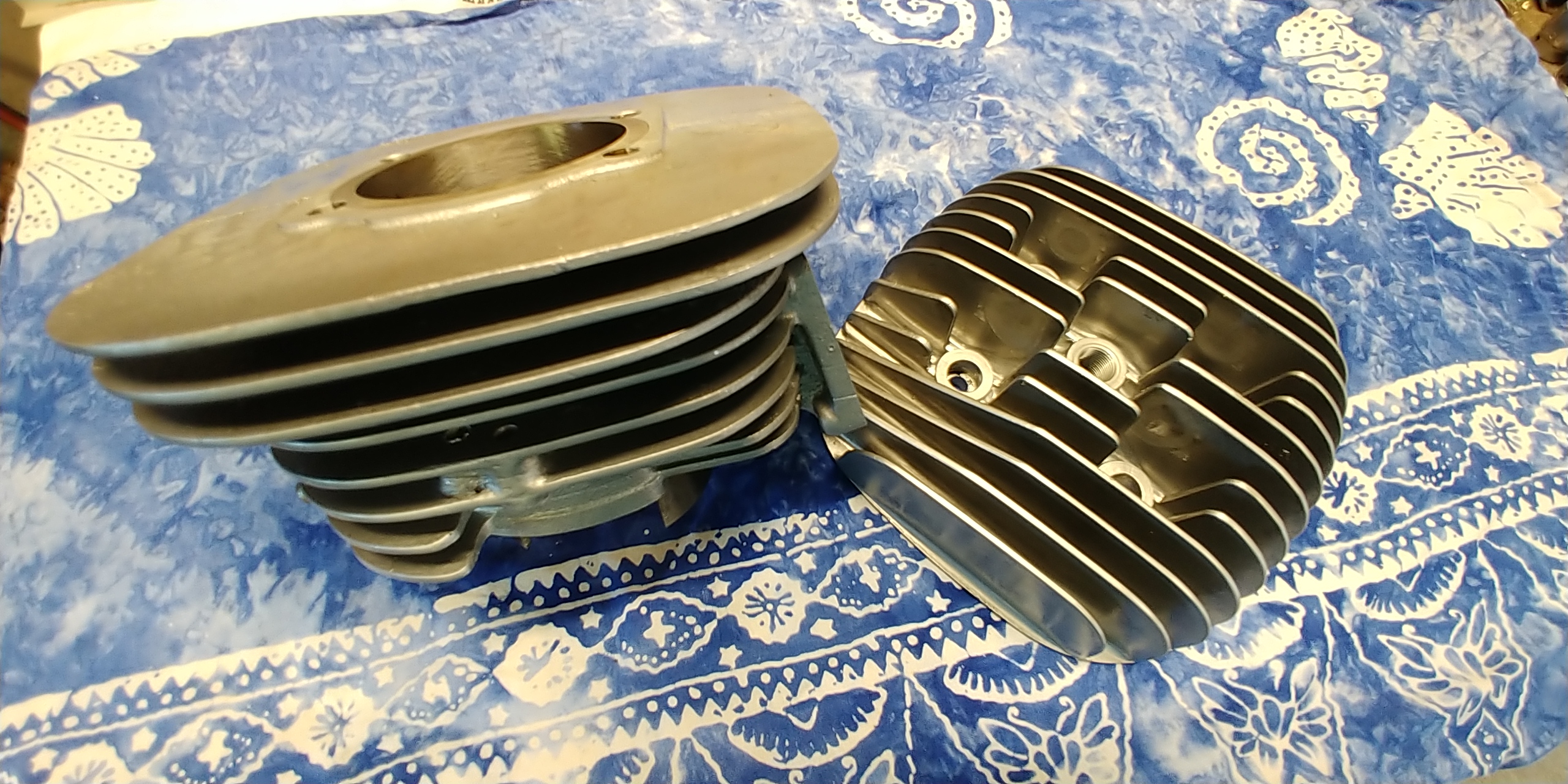

I bought the TY175 air filter to use on my Hotrod 210cc TY175 as part of improving the intake breathing

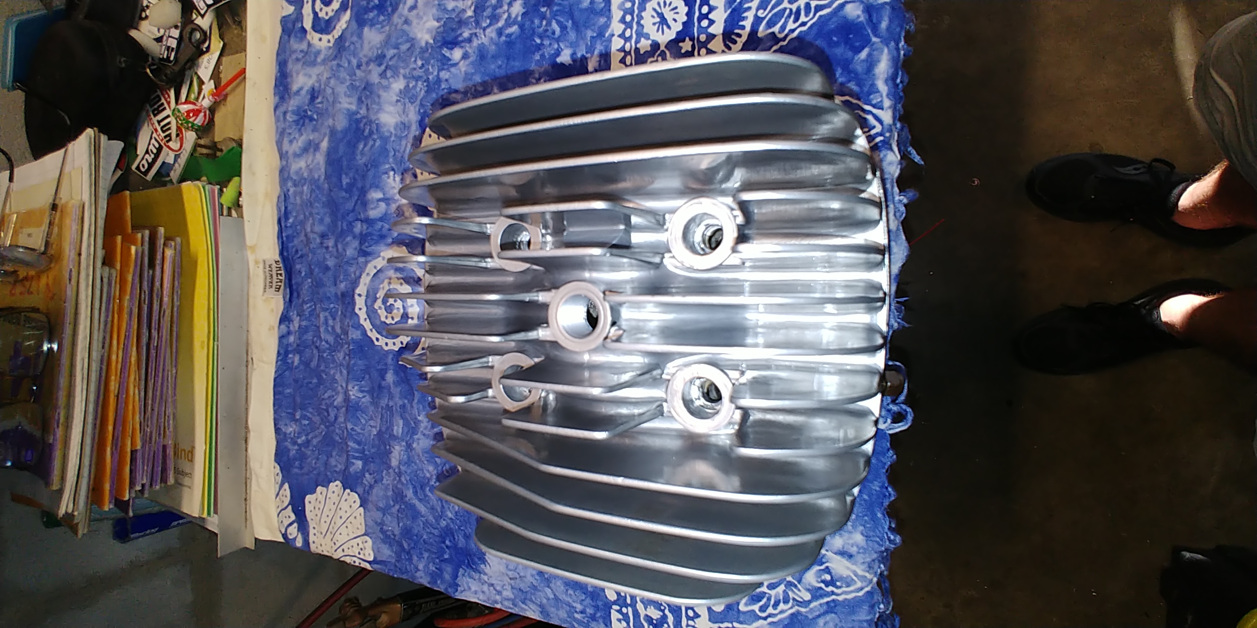

more 210cc TY175 engine progress sort of
I stripped off as much of the flaking paint from 2005 with paint remover as I could first then it was off to the local vapour blaster.
No painting this time.

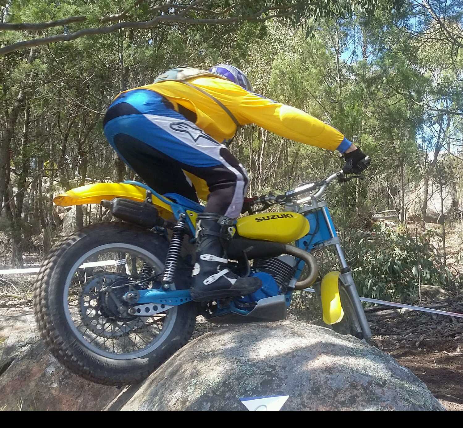

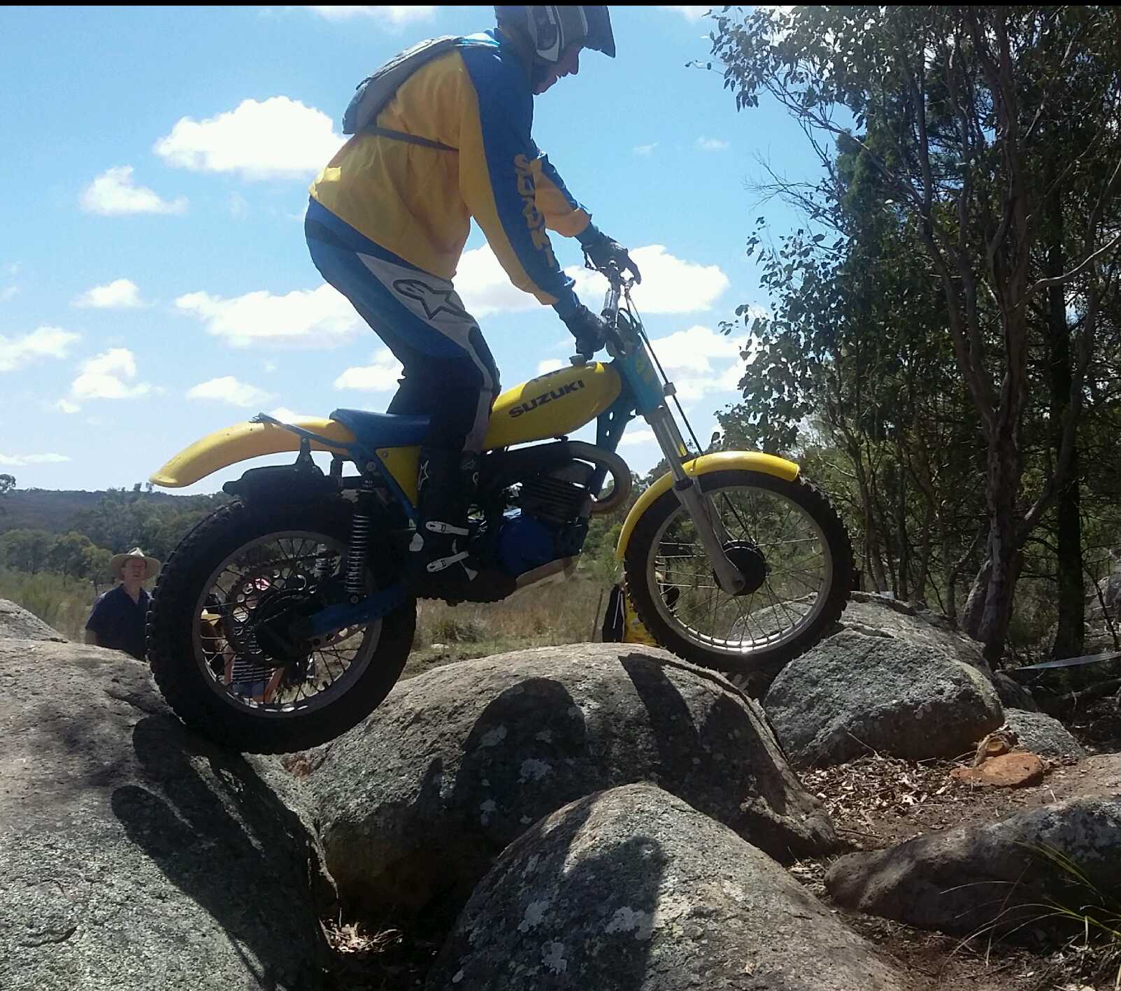

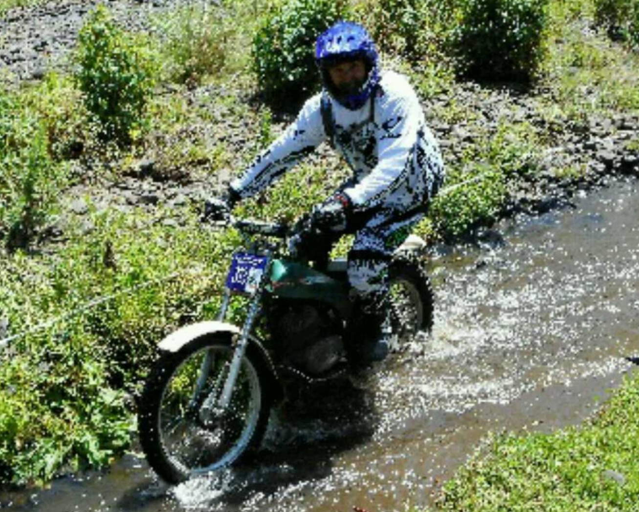

For example: At the Logan River Trial on the weekend, I counted 5 other MAXXIS TRIALMAXX tyres without even trying on multiple makes of bikes. Mine was the only one mounted on a Twinshock, :kawasaki
2016 SQTA end of year Gate Trial, :montesa 172 fitted with MAXXIS TRIALMAXX on both ends:
