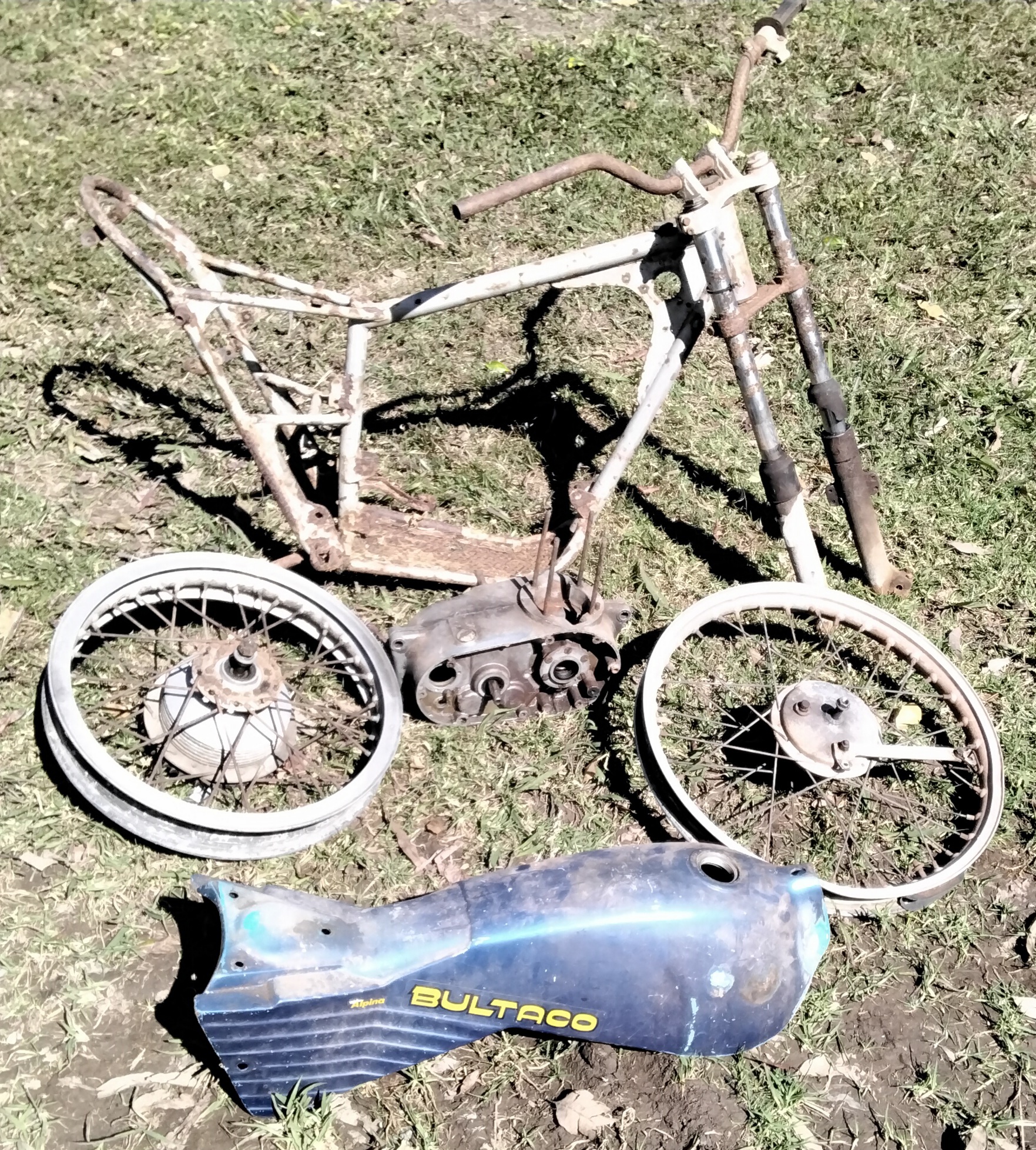

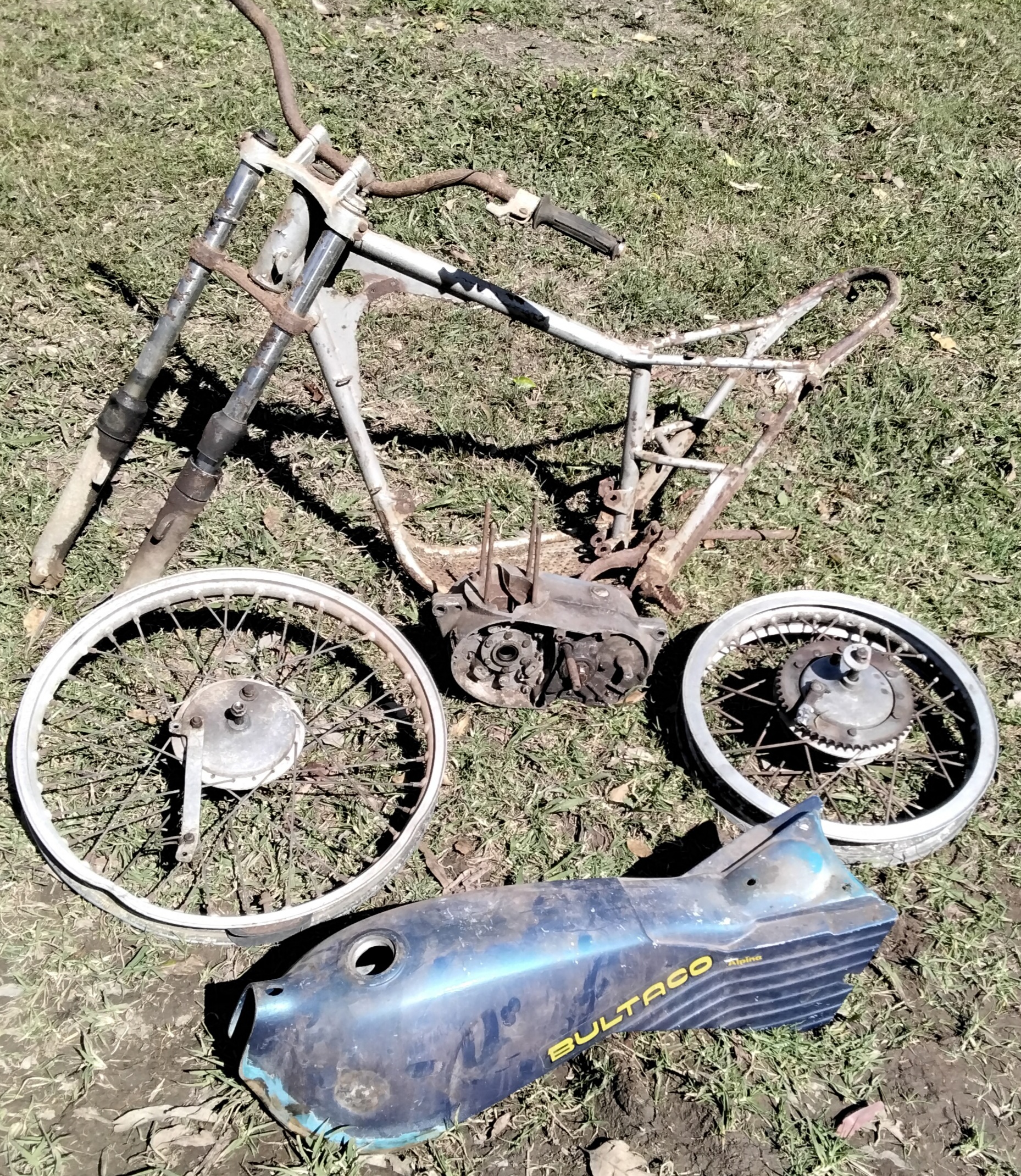

David Lahey wrote:I could not resist buying this parts bike today.
Kudos for people who know what it is.
Way too easy David, Spanish Rust :!: You have inspired me to look for some Spanish Rust of my own so back to the :Bultaco: Emporium:

That one's tricky Greg. I hope this is a quiz.
There's some things that don't normally go with some other things, as Mark Keenan would say, "a Legion"
I'll wait until I'm sure it's a quiz before having a go

M85 ??
sherpa wrote:M85 ??
I was thinking M85 (or M99) too but if it is one of them, shouldn't it have tapered top fork tubes and parallel front hub and mudcatcher front rim?

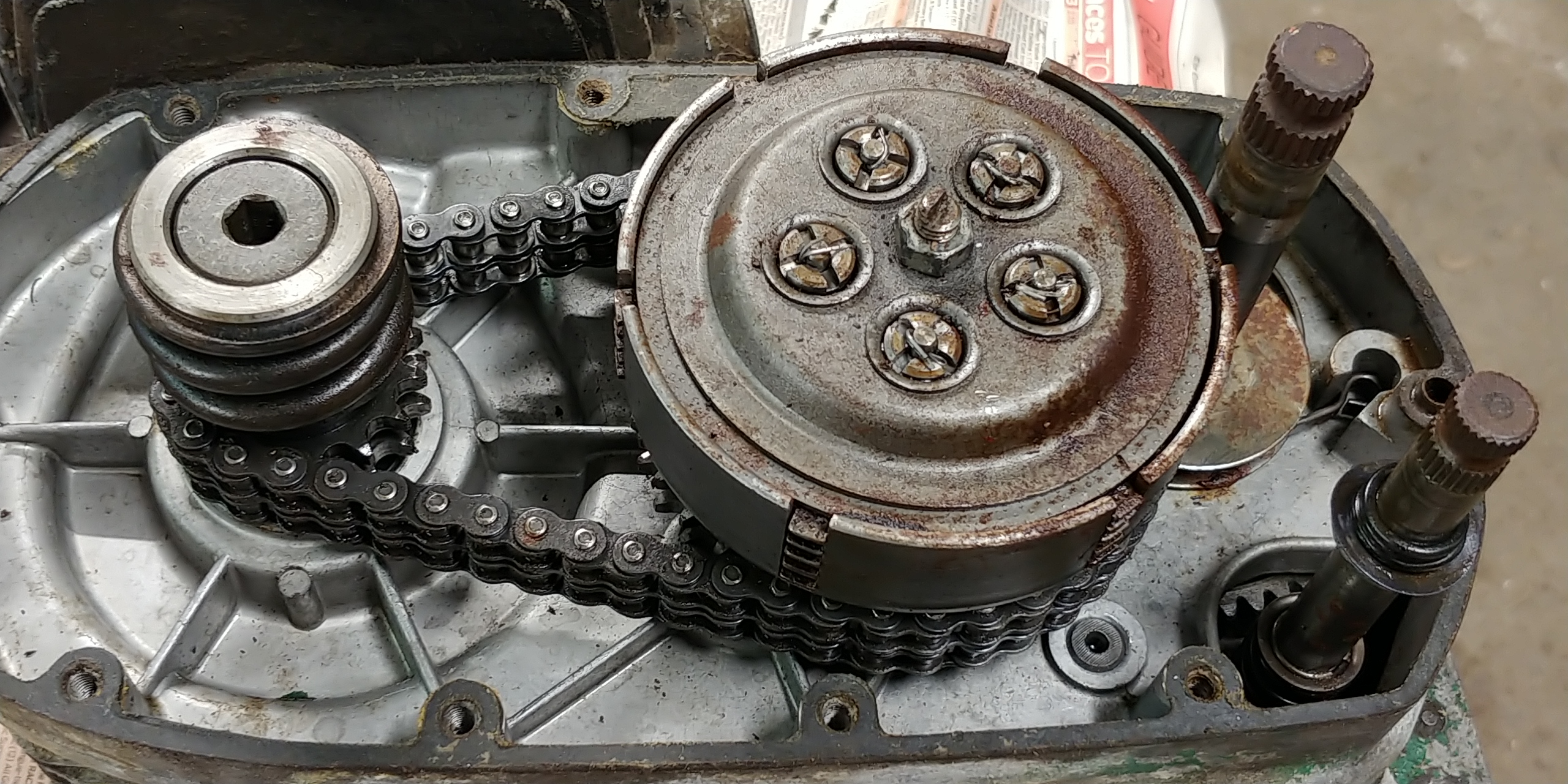

This is the primary drive side of the motor.
There are no kickstart idler gears because the kickstart shaft drives the gearbox rather than driving the clutch basket. :Bultaco: and :montesa of the era are also like this and it means that if you pull the clutch in the kickstart won't drive the motor.
The double-row primary drive chain that :ossa chose to use in their motors is the same chain as used in some old BMW car motors as a cam chain, so it is still easy to source new chains in 2022.

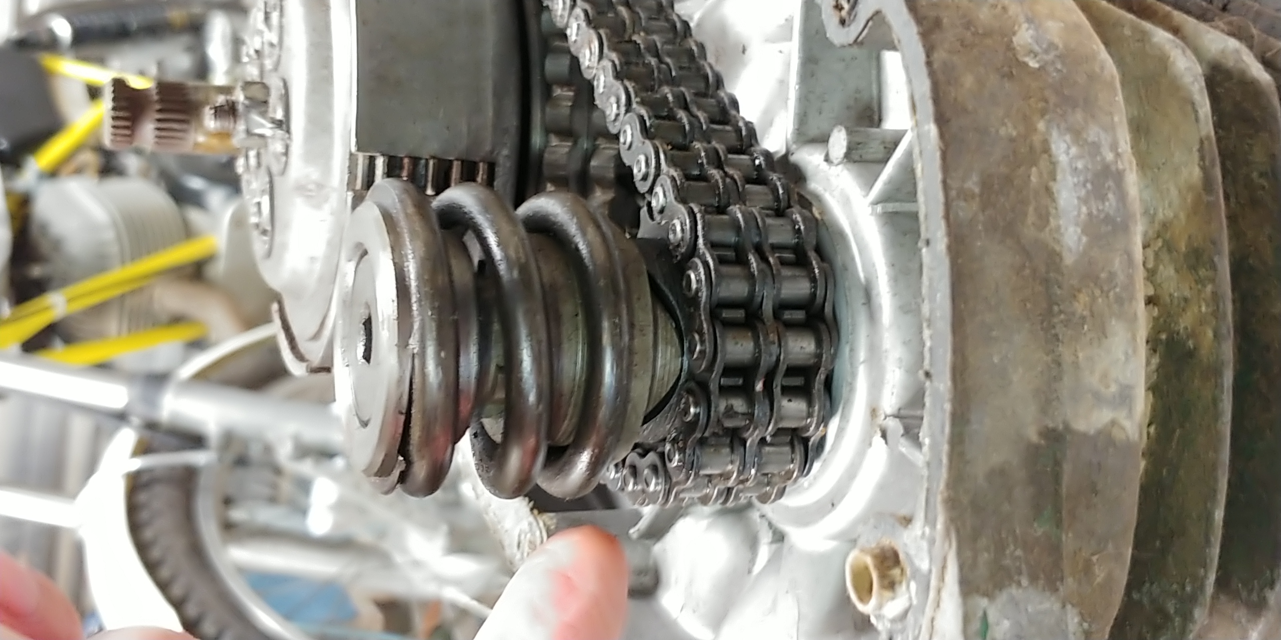

The thing I'm pointing at is a device that absorbs driveline shocks. It allows for the working components of the gearbox to have a much easier life than if it wasn't there. There are two axial cams that sit against two opposing axial cams and are held together by the helical compression spring. 1970s Japanese trials motors also have a device that does the same thing in the form of rubber cushions hidden in the rear of the clutch basket, mechanically isolating the clutch basket from the clutch gear. This :ossa device is mounted on a taper on the crankshaft and a special puller is required to get it off the crankshaft to change the crank seal or pull the motor apart.
The kickstart shaft is the one with the big diameter spline. The smaller diameter spline in the photo is for left side shift. The shift shaft goes right through to the other side so you can use the bike either left or right shift, or both. Standard for the :ossa MAR is left shift, right brake.

OK I've had a good think about this bike and while it initially looked like it has some components that look mismatched, it might not.
I've been caught out before by the way :Bultaco: made development improvements in their bikes and incorporated the improvements before they changed the model number to the next number. Most likely caused by poor inventory control, where they ran out of something before the production run for that bike was finished or equally likely when they had too many of something for the production run, they carried it over to the next model number.
In the case of the :Bultaco: in Greg's photo which I'm going to say is nominally a model 99 because he told me so, the "odd" bits visible could be explained by it falling into the transition period in production from making model 85/99 Alpinas to making 115/116 Alpinas.
The frame and tank/seat is typical 85/99.
The front wheel, having no shoulder on the rim and having the conical hub, lines up with model 115/116 and all later Alpinas.
The rear wheel could be late 85/99 or early 115/116. Not later than that though because of the shouldered rim which ran out during model 115/116.
The fork tubes are what normally came on model 115/116 and later Alpinas (the tops ends are clamped with bolts rather than a taper fit in the top triple clamp)
The lower triple clamp is model 85/99 Alpina (and model 10, 27, 49, 80 Sherpa T)
The upper triple clamp is model 124/125 Sherpa T. There would have been a necessity to use a Sherpa T top triple clamp in conjunction with that steel lower triple clamp because the geometry of that steel bottom clamp is Sherpa T. Looks like they either ran out of top triple clamps with a taper fit for the tubes, or ran out of tapered top fork tubes. After the model 85/99, Alpinas moved away from Sherpa T steering geometry by fitting the same triple clamps as Pursangs and Frontera, with more trail and bolt-on handlebar mounts.
So my theory is that it is a model 99 from near the end of model 99 production.
