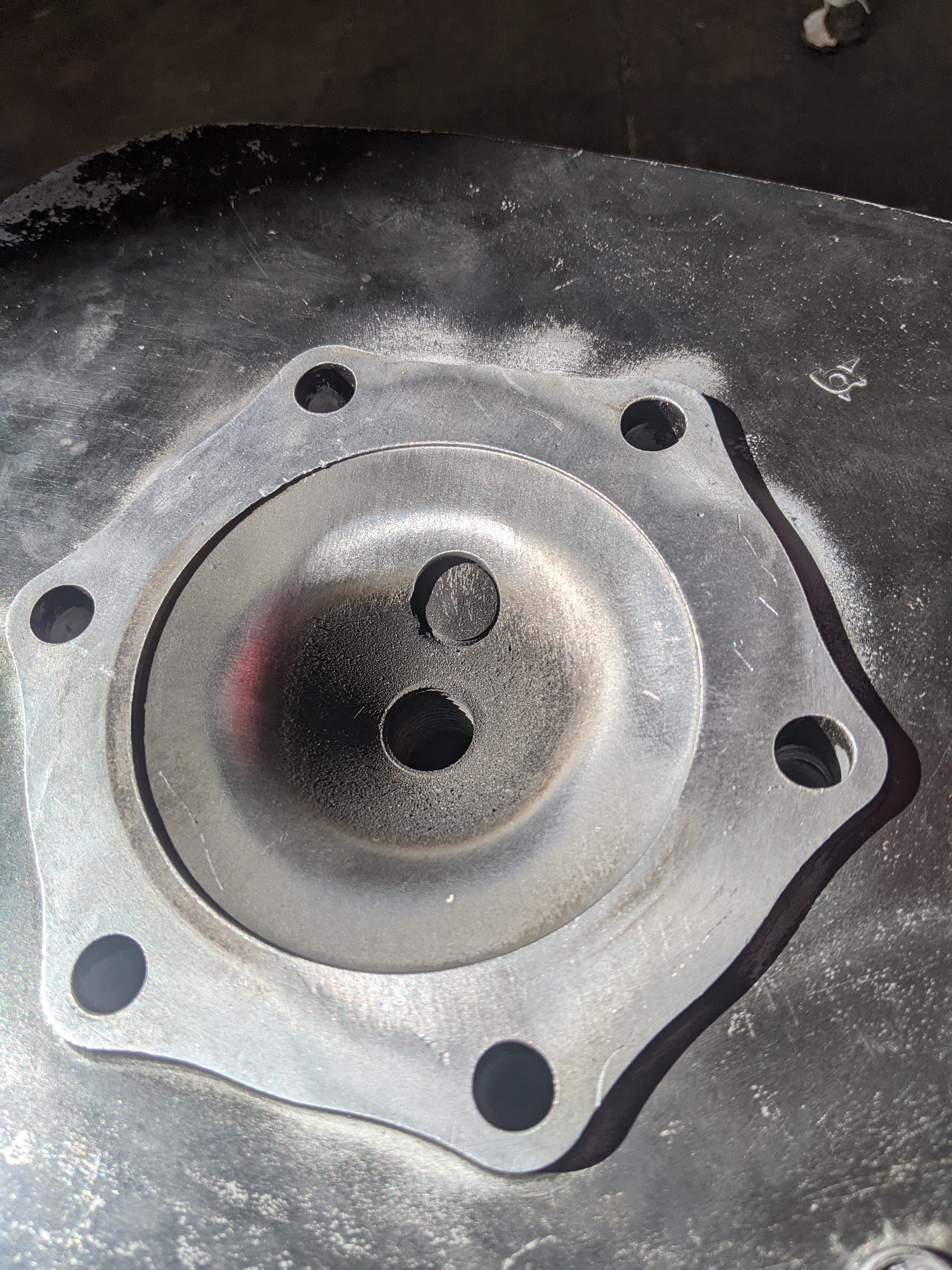

After going through some more :Bultaco: parts, I found another head with 3 holes. Here are some comparison photos:
Both heads appear the same except for the number 105 stamped in the underside of the second beadblasted head, maybe it means something? The centre hole looks to me like it was machined at the same time as the others with a similar recess even though they have different depths. They fit neatly on to a 325 cylinder with 83.4 mm bore.
So this head on the left must be a 325 Sherpa T one, is that the right way to think about it?

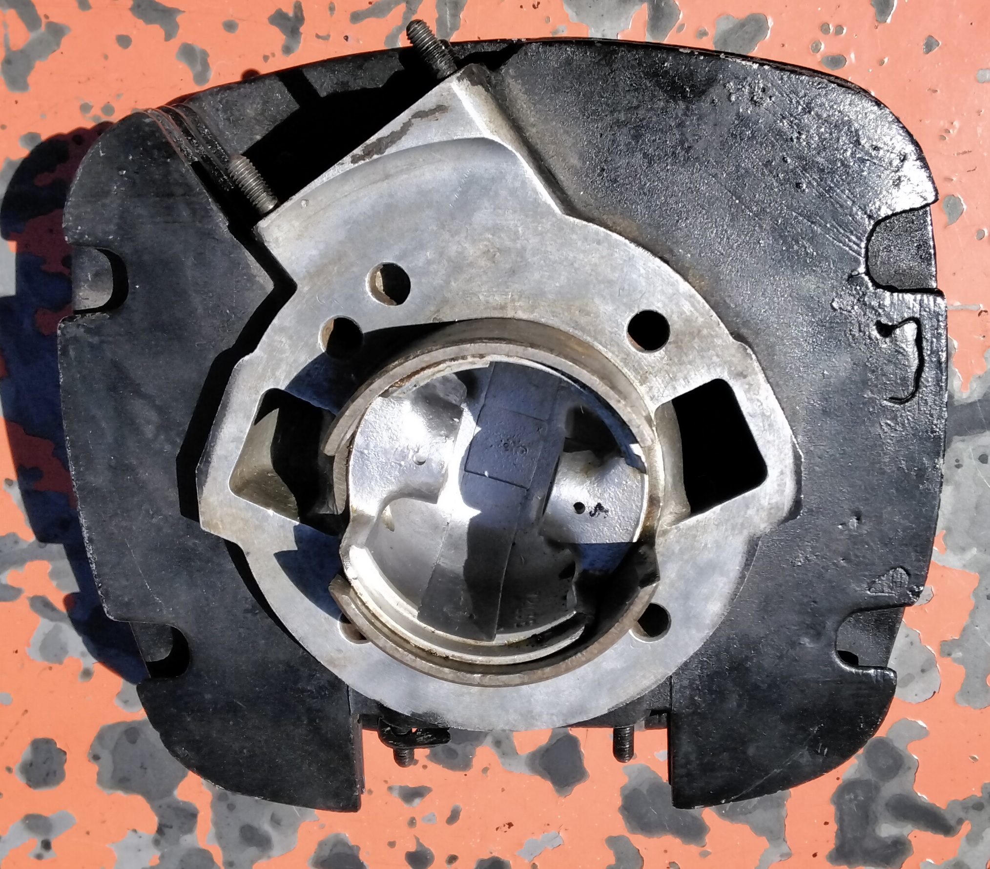

Also while I am going, I have found this cylinder rebored with new piston and 90Y stamped in the top:
It is 250 size and what would that be for? Would it be good on say a M198 that I have that needs a top end rebuild?

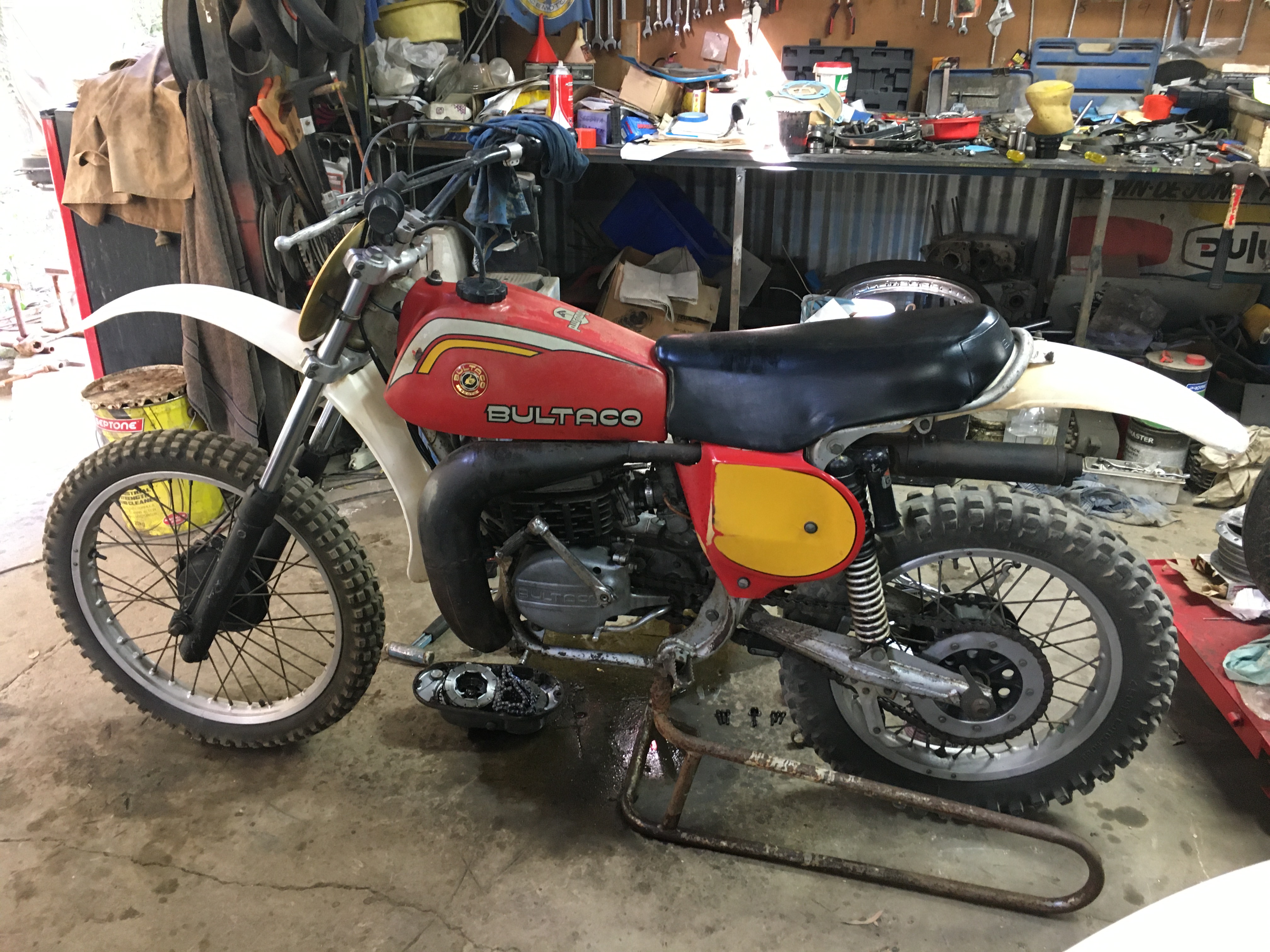

Greg a Model 90 is the first ever Astro 250. These were made for the American 1/2 mile flat track racing. A M105 is the MK 6 250 Astro. A M87 is a MK5 350 Pursang. David I`ll include a photo of that MK 10 370.

Greg Harding wrote:So this head on the left must be a 325 Sherpa T one, is that the right way to think about it?
It looks like model 99 350 Alpina or models 92 and 125 325 Sherpa T.
In the models that followed these, the 350 Alpina and 325 Sherpa T gained a head steady. Your head predates that change because it does not have the fins cut away behind the rear head stud holes.
Bully fanatic wrote:David I`ll include a photo of that MK 10 370.
Thanks Graham. What a fabulous looking bike. I love how Bultaco made improvements during production runs.
