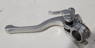

Mind you, I have managed to find what looks like a pretty impressive clutch decompressor dodah to suit 7/8" bars, so that's one issue out of the way.
