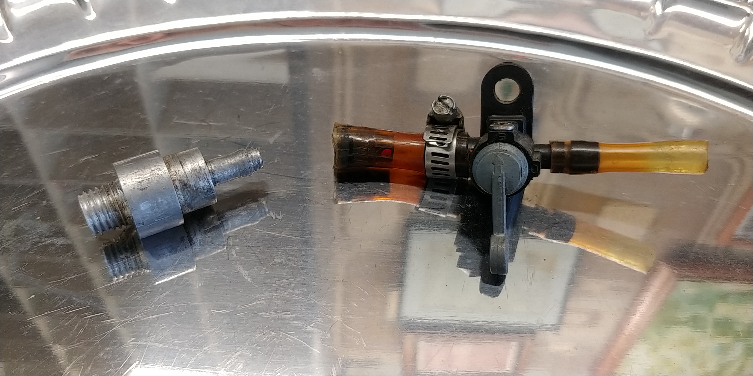

A work around from the 1980s
Many moons ago someone had a :montesa Cota 348 that had a problem with the original fuel tap. Maybe it was the famous Monotesticle fuel tap that :montesa s came with for a while.
Whatever happened, they made this set-up to replace the original fuel tap. It was on a 348 I bought about 25 years ago. Today I needed something to block off the fuel tap hole in another Spanish bike tank while I de-greased the insides and it worked a treat.

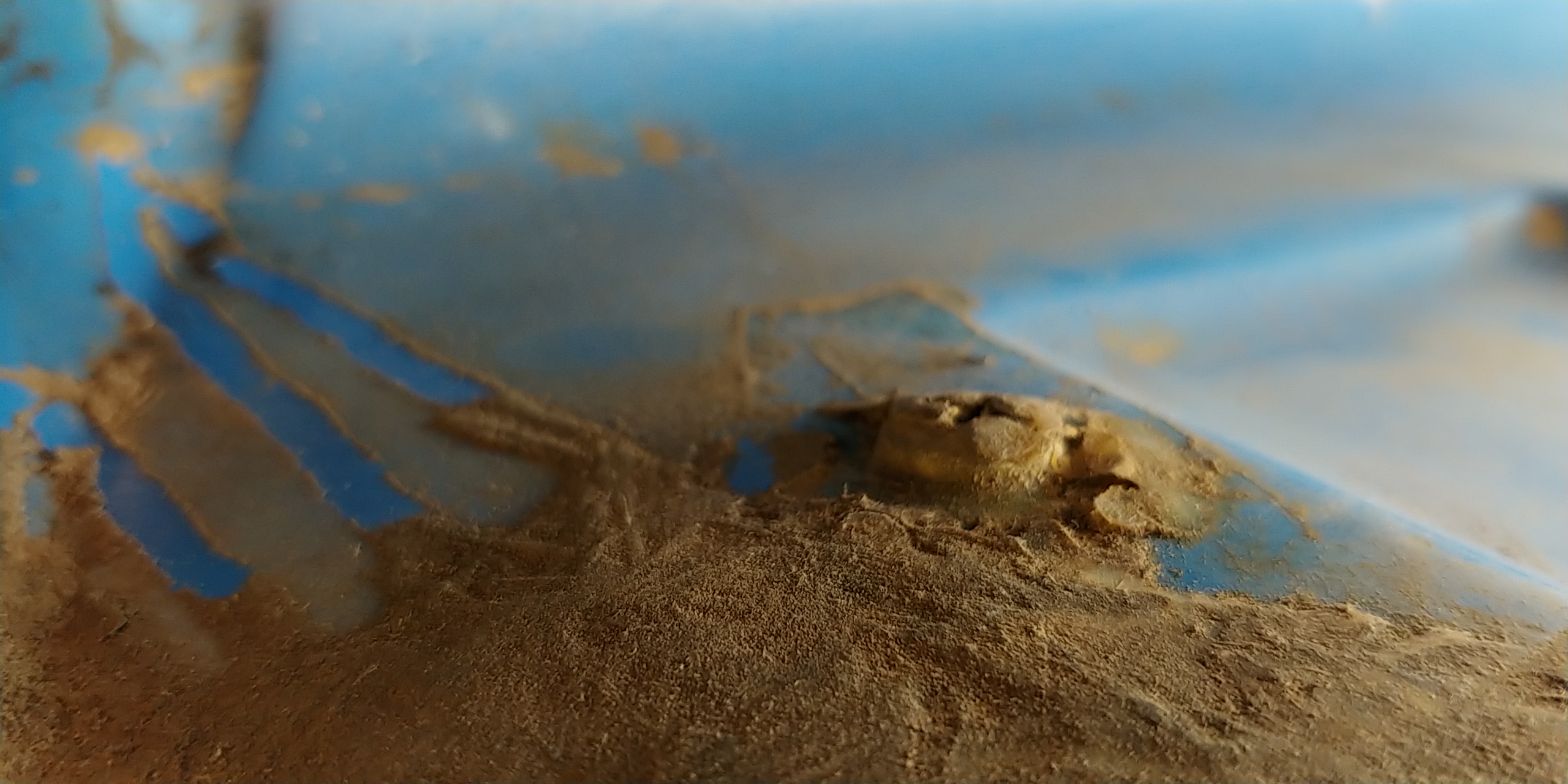

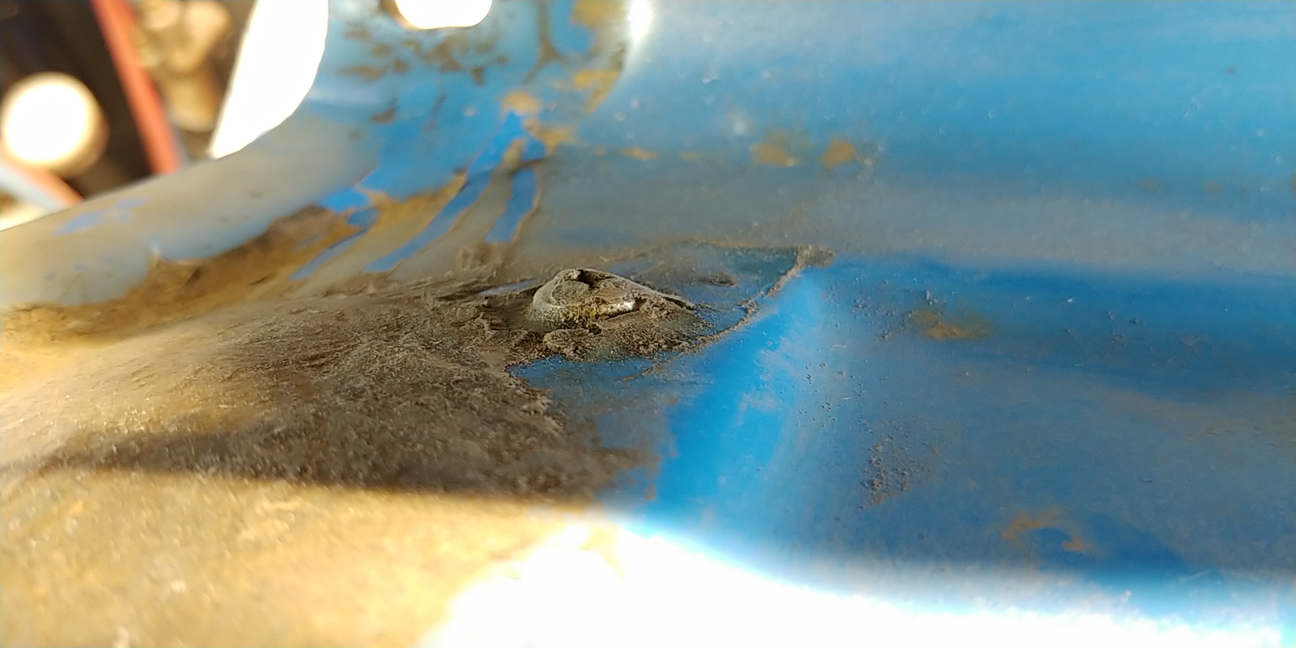

I am cleaning this :Bultaco: Alpina tank up today getting it ready to line it with epoxy resin.
It's got a few repairs underneath. Most repairs have been done with the usual mat of glass filaments and polyester resin but one involved the use of a screw. How anyone managed to put a hole in a tank inside the tunnel has me beat but there you go. New mysteries every day.

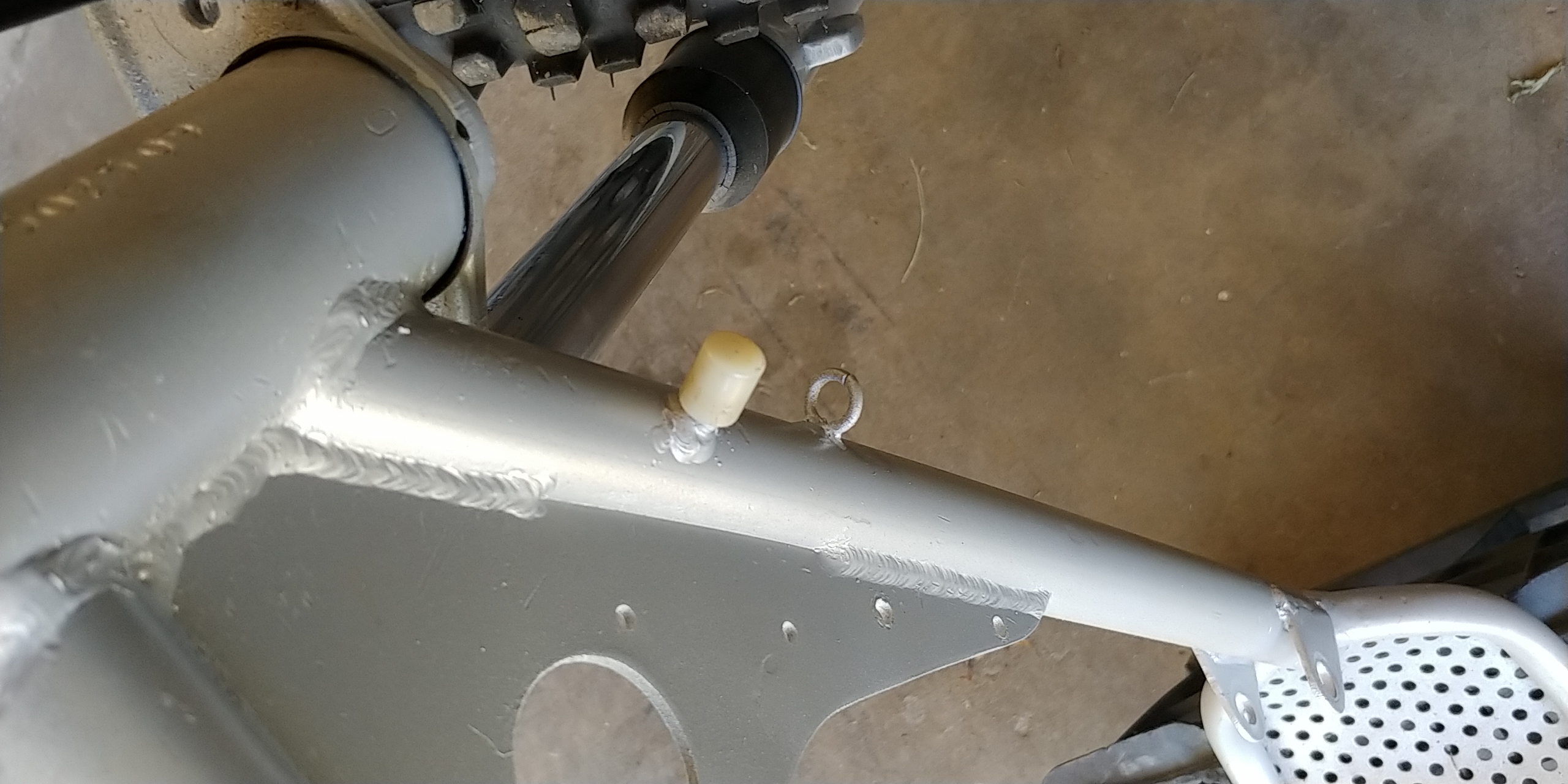

Making things on a Saturday

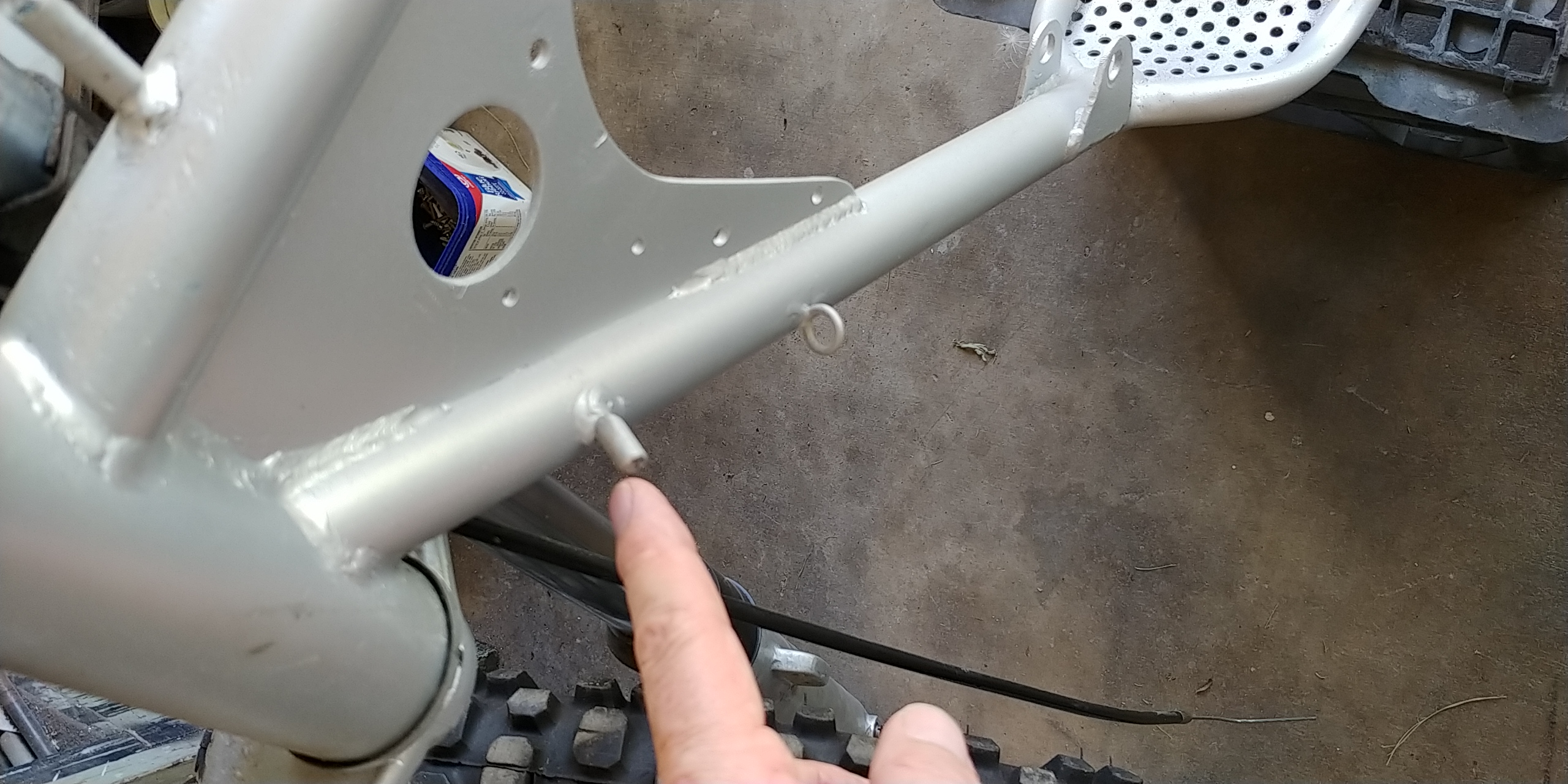

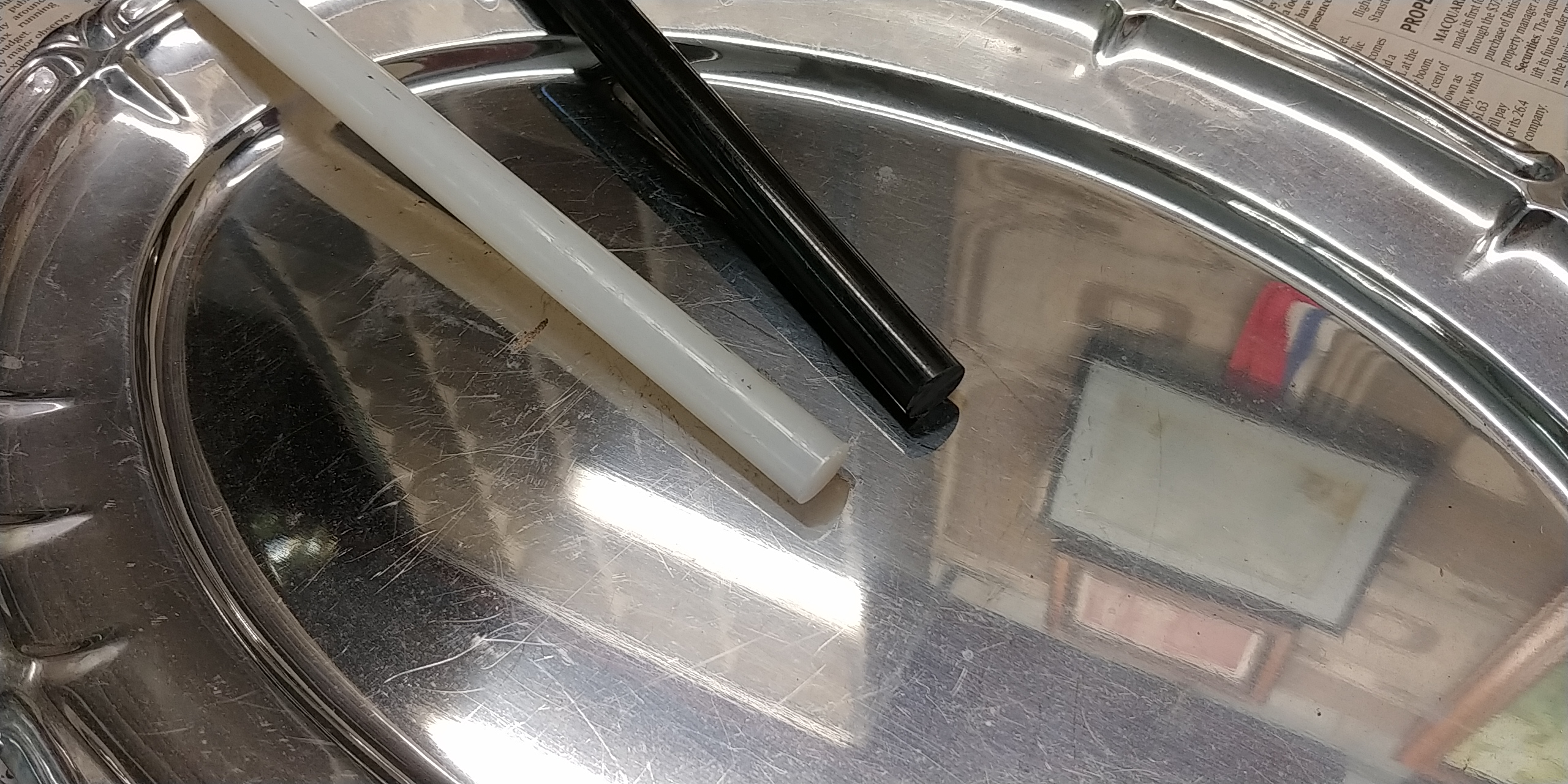

The steering stops on many old :Bultaco: have a plastic cap that is missing when you get a bike. I've been making them from a stick of nylon that I scored from somewhere back in the 1970s. Well this time, this Alpina need two stop tips and I only had enough of that original nylon rod left to make one of them.
The range of things you can buy easily nowadays in small quantities is incredible.
Some 13mm round nylon rod in natural and black arrived during the week and now both steering stops are ready to go.

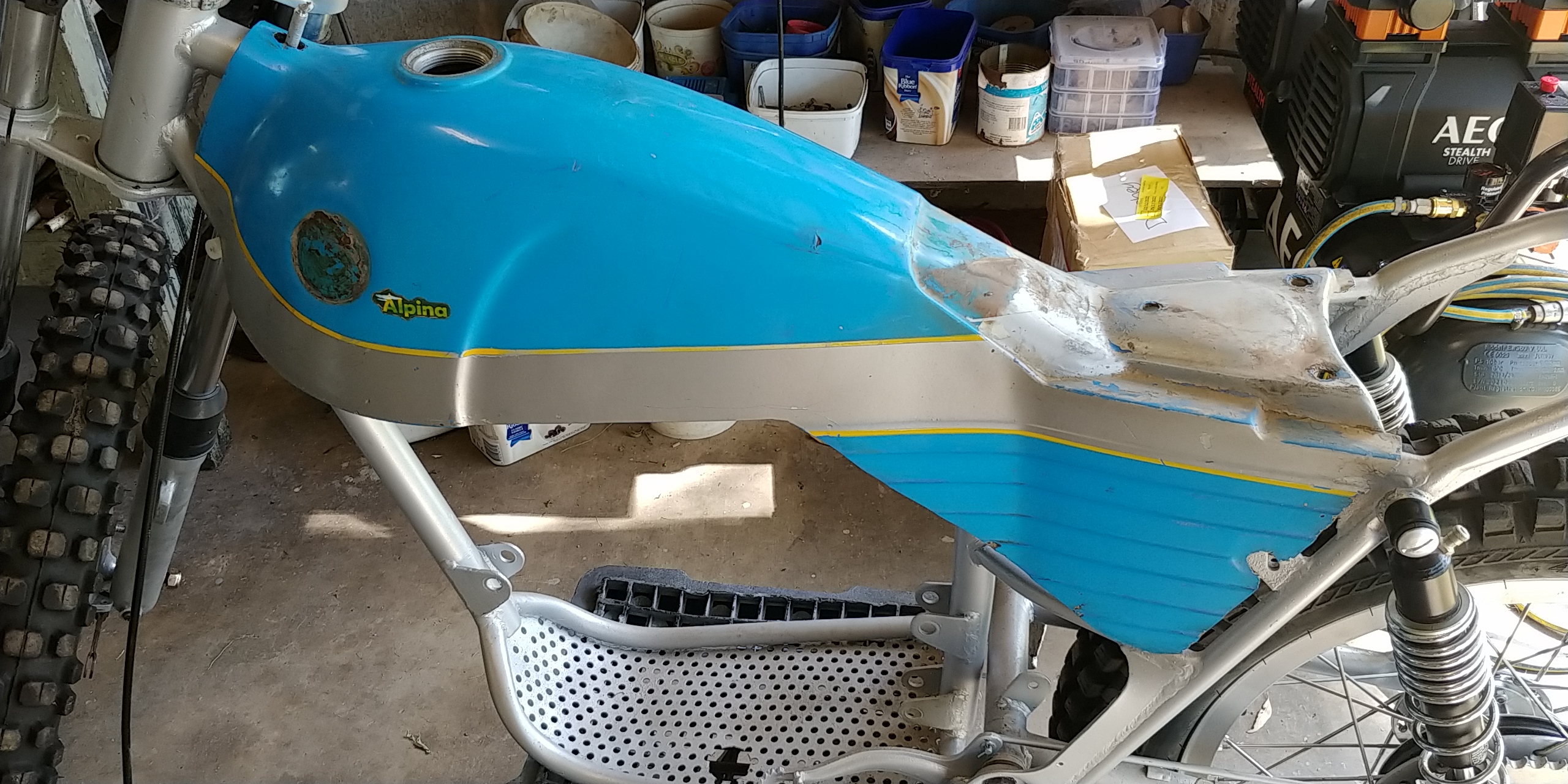

Alpina tank
Interestingly this tank that came on a :Bultaco: model 85 basket case has 87 as a part number.
I think model 87 is the 175cc version of this era of :Bultaco: Alpinas. The 85 is 250cc and the 99 is 325cc.
I'm not surprised that it isn't the original tank, but am surprised that they would have different part numbers for the fuel tanks on models 85, 87 and 99 when they are all the same tank structurally and are decorated the same?
Time to have a look underneath some other model 85/87/99 tanks
